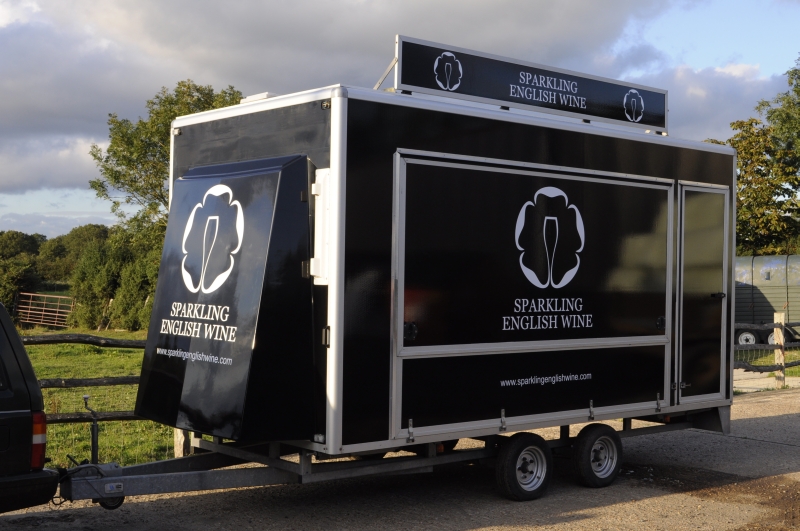

    20 November 2012 at 08:17
    We wrapped this trailer in Hexis Hexpress. Overkill yes but I wanted an excuse to try the stuff and it went on a dream.

    20 November 2012 at 12:04
    quote Peter Dee:
    Haven’t used the black but can also vouch for the Hexis vinyl…. A joy to use
  • Andrew Murray
    20 November 2012 at 13:04
    +1 for the Hexis, a dream to use and reasonably priced for solid colours
