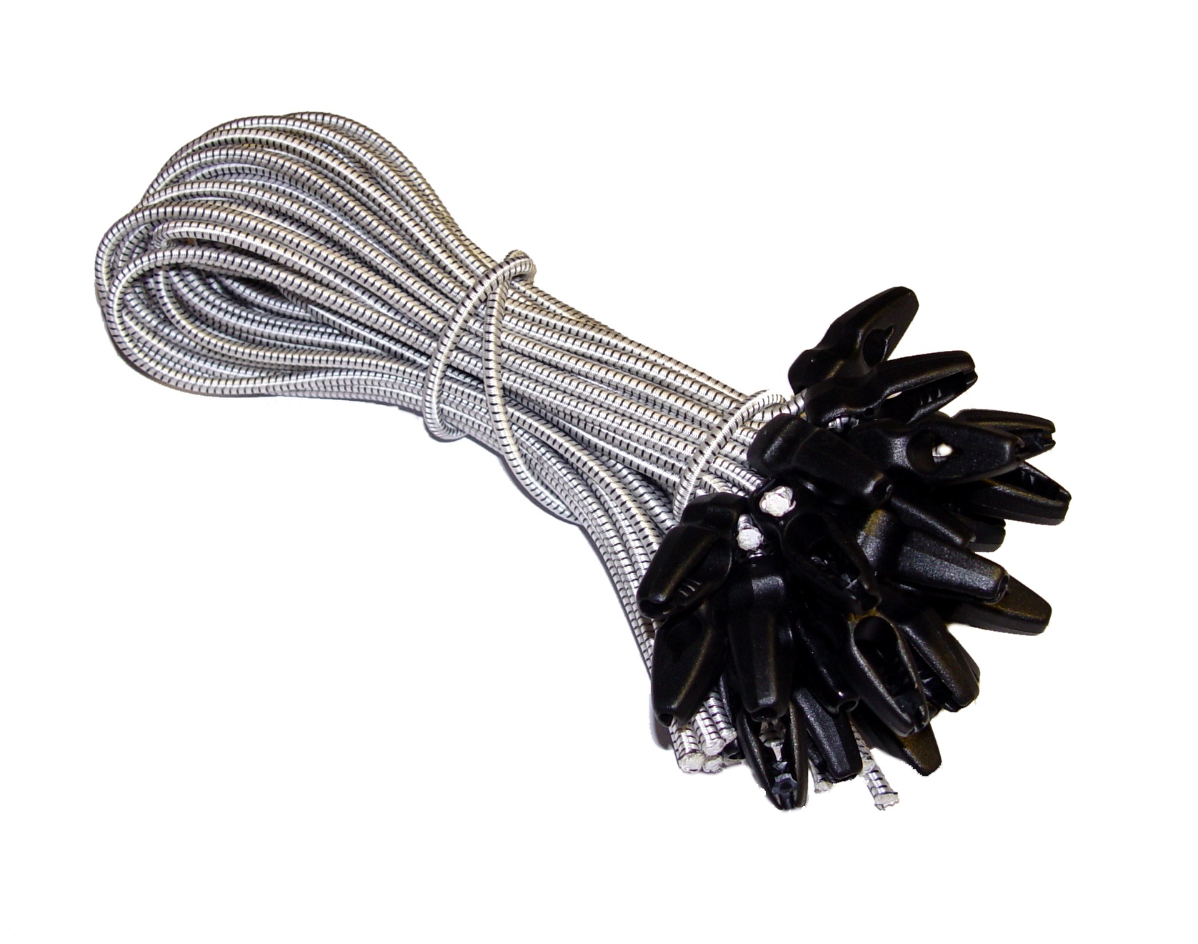

    additionally you should consider Bungee elastic rope to fix with. what this will do is allow the banner to "move" with "any" wind force. When rigid fixings are used on an exposed banner, the banner tries to move as the wind blows. but due to the rigid fixing, the wind progressively rips the eyelet fixings from the banner. when bungee fiings are used the banner simply moves back and forward due to the elastic fixings.
