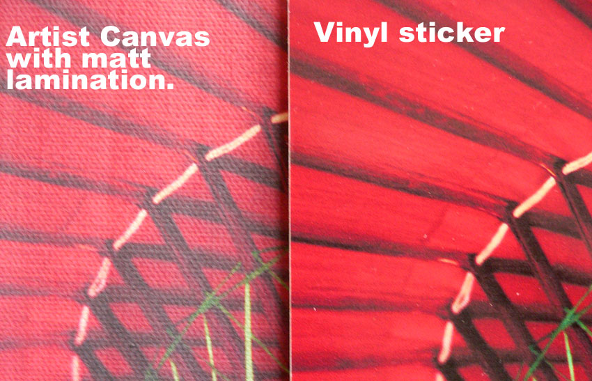

    Hi guys, i have been try to get my SP540i to print on Artist canvas. I have tried a few, but the results were not up to standard. As there are no specific profile for printing artist canvas on Versaworks, therefore i tried different profiles and see which produces the best. It seems TTRH is the best profile but still not good enough. The colours are very pale and dull. I have also use liquid lamination for both protection and bring out the colour a bit more, but still not much different. Has someone successfully produce artist canvas by using SP540i? I will be grateful if you don’t mind sharing your experience.

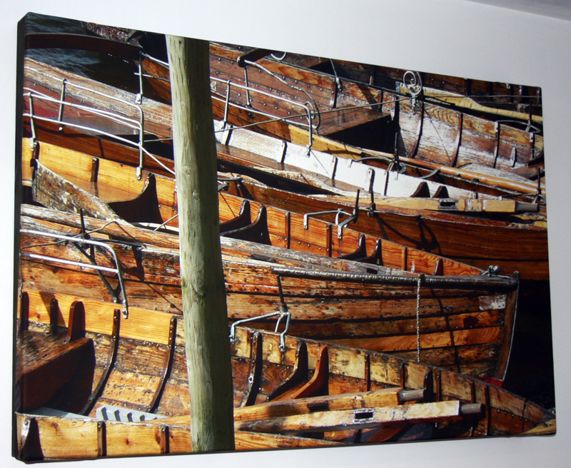

    Just my thoughts as we do a lot of canvas printing and I expect we can do it more cost effectively than most.
    I use a wide format ink jet loaded with a continuous ink system. The colours are really vibrant, we then coat with a matte lamination liquid which brings the colours out even more and protects.
    I have been making canvases this way for years, never had a complaint or return yet.
    Print production costs are about £5-10 a square meter including media and ink depending on which canvas we use, I get the best results with a poly/cotton mix. But if you want really high definition then you need a poly canvas. If you want texture but a softer image then you need 100% cotton.
