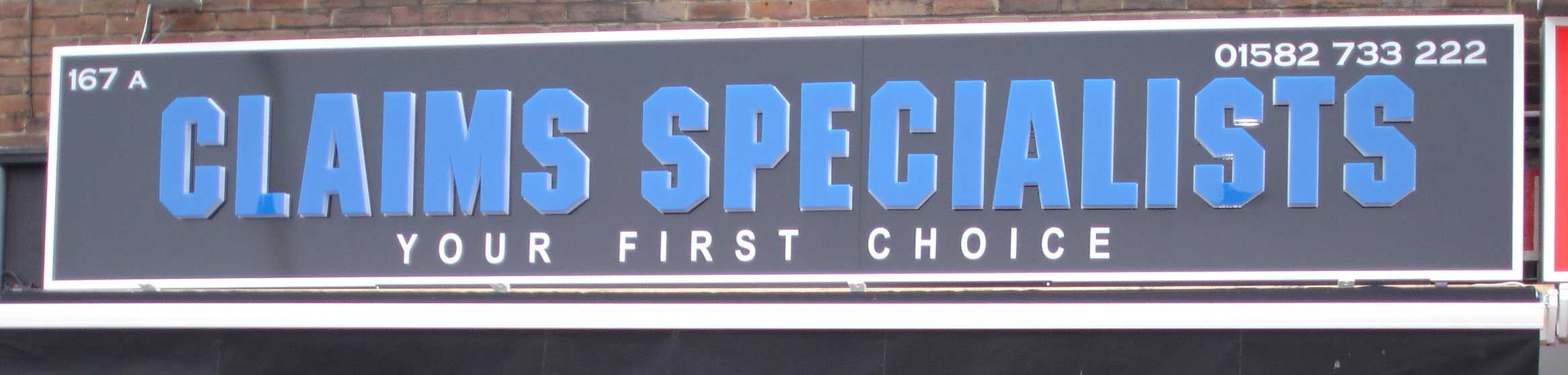

    Hello everyone, have a job to do for a customer and he wants something like this pitcher. I’ve never done a sign like this but what I do no that its a normal light box with 2 Perspex panels which have 3D letters on it or moulded on it, I’m shore this is nothing new for everyone and also where or who I could go too, to get this made as we don’t do this in house thanks everyone!!

    Hi mate,
    Just get the lightbox made as per normal.
    This one has had the black laid on the face, with the text cut out exposing the opal perspex substrate behind it.
    Get the letters cnc or laser cut in clear, then coat with translucent material.
    Use a clear perspex or acrylic glue to lay them over the exposed opal sign face, and you have a very simple 3D light box.
    If you do the signage yourself, and just buy a box, you’ll save yourself some money.

    thanks Shane, what is (cnc ) and what glue would be best for the letters.
    Would you no the font I.D. thanks!!!!
    CNC? check this out http://www.cncrouter.com/index.htm
    Glue? something like this http://www.rplastics.com/weldon40.html
    Font? I’ve seen it before. College or Varsity font perhaps? Check out http://www.dafont.com as I may have seen it there during one of my own frantic searches 😛 try here 1st http://www.dafont.com/theme.php?cat=104
    We have a few font gurus here too, they may see this post and tell you….
