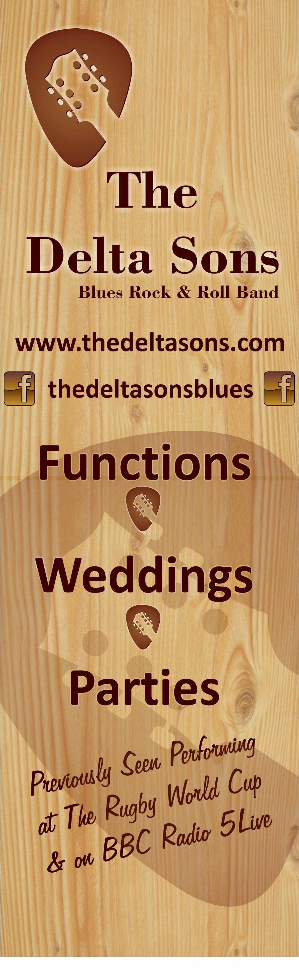

    I can print A1 posters, huge (mb) hi-res photographic prints etc with no problems, ever. However, when I try to print 1850 x 590 banner prints for roll-ups I always seem to encounter problems.
    I’m printing direct fro corel with no rip, never needed one – even for massive files. the page size is sed for the document, and the printer then has a custome setting input to match the page size, I get varying problems depending on how I output it..
    (system – quad core Q6600 with 4gb ram, win XP pro, he end Nvidia graphics/video, connecting to the HP via network)
    1) Printing direct from the artwork, a bitmap background with a mix of transparencies and simple vectors over the top, all grouped and sent to print…
    it will just print the vector elements.

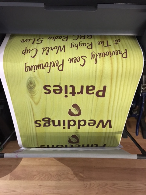

    Repeat those several times and you can understand why after a couple of hours (thankfully between other tasks) I was ready to get the sledgehammer from the corner and reduce it to a pile of plastic parts out in the workshop… I was that close that I put the hammer down, tried one more thing (I forget now but something pdf) set it to print for attempt type 7, I then locked up and went home early!!
    Friday am… Attempt No.7 was somehow on the floor face down, what I could see was looking good… until I turned the rest over to see just half a print!!

    No.8 in progress.. I’ve taken away the 20% transparency from the large background jpeg, grouped it all and reduced the width to 580 (may not have needed to but it’s occasionally helped in the past..
    In the time it’s taken me to type the above post, 8-10mins, it’s busily printing everything and is about half way through.. further than last night’s attempt..
    Perhaps it’s the jpeg with transparency it doesn’t like, maybe if I’d added the transparency and then saved it as a bitmap again prior to printing it may have worked..

    Ok, update 2!!
    It has to be something to do with the transparencies, the rear background -since removing the transparency, has now printed with no issues however, the gian pick image lower down has not.. it has a transparency, I’ve converted the vector part to a bitmap and will try again 🙄

    No.9!! have added a transparency again to lighten it AND converted to jpeg, sent to print as a jpeg/vector mix (as per No8) but it’s only printing the vectors again!
    No.10.. remove transparency and try again… nope!
    No.11.. bugger it, redesign, remove all transparencies and try again
    5 February 2016 at 12:54
    Finally!!
    No.11 failed too, I took a shaped section of bitmap to make the pick with a drop of shadow underneath, all printed except the top layer of bitmap, even when the whole background was converted to one big bitmap..
    No.12 worked, I did away with the large pick transparency and dropped an outline in instead.
    Only sems to be the transparencies or overlaid prints which have a problem.. need to gety to the bottom of it still but at least this job can go out the door!
