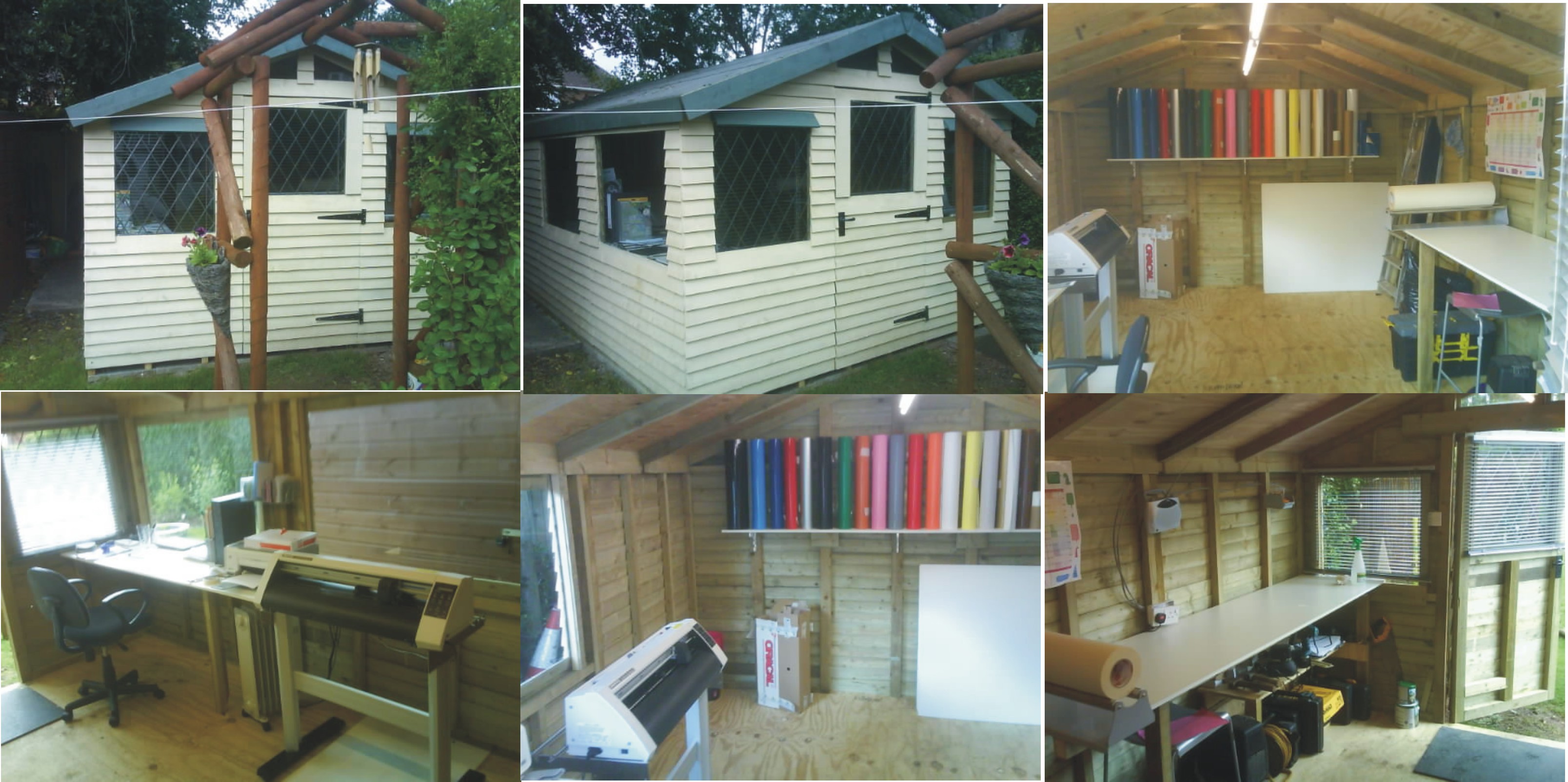

    Just though i would post this, with a baby due in September i needed to move all the gear out of the spare room.
    I have been working on this for a couple of weeks trying to dodge the rain. Its 15ft x 10ft and made from treated timber not completely finished yet but getting there, i will be lining the inside at a later date. I already have 2 other sheds so wanted this to look different.
    Lee

    Very nice Lee,
    You will need a letterbox in the door and a milk rack outside. Since I built mine I am always in there, Trouble with working from home. Still it saves a packet and at the moment you seem to have plenty of room. Did you decide against and 8′ x 4′ table smack bang in the middle of are you still under construction.

    I did consider a table in middle but it would be against my desk area. the work area is 8×2 contiboard that’s just to give me the base i will be covering it with something and maybe making it a bit wider just about to moving the socket because its to low.
    I have been spending a lot of time in there even when not working on signs, its a bit of a dream really big boys den.
    I currently only do signs part time, i have a full time job and also i’m a retained fire fighter so pretty busy really.

    looks good, plenty of space,
    but…. from my experience, you’ll soon fill it, with this in mind, i would line it now, before you have to move everything 6 times and cover everything in plasterboard dust etc etc.
    the other thing i would seriously consider, is making your workbench the full length of the shed, and 3ft wide, maybe even 4ft wide, it’s a big portion of the floorspace, but i say this because mine is 2ft6" x 12ft, and it’s not big enough, and of course you have the under bench storage too.
    with yours at 2ft wide, it’s only just big enough to put a 610 sheet of vinyl on to weed, or a 2ft wide banner, where do you put knives and other ‘clutter’ that invariably ends up on the bench??
    i don’t mean to sound negative, just trying to help with the benefit of my experience, if i could do it again, the shed would be bigger, the bench bigger, and i’d buy a seperate fishing gear shed !!

    I am going to put a shelf above bench for tools etc
    i haven’t lined it yet because i’m not sure what i’m going to do it with, was thinking of using timber cladding wanted to keep the look of wood.
    I’m sure the bench will grow over time.
    Lee

    Looking nice, Lee. A bit like mine, only my shed’s a tip. It would be nice to clad it in timber, but remember that you want it nice and bright in there. I insulated with polystyrene and clad with hardboard painted white. Don’t forget heating – those slimline wall heaters are brilliant for sheds.

    I honestly think your workshop looks great lee… as this is only part time at the moment and your working from home, you appear to be going about things the right way mate… well done!
    Meant in a completely constructive way… some of my thoughts…
    As has been said, if you don’t do it now you will never get round to it without allot of work. By that I mean…
    I would put in some insulation now and sheet it with half inch MDF.
    Sheeting with this means you have nice smooth walls that are going to withstand lots of bangs and bashes. It also means fixing shelves and things is a breeze because no need for load baring toggle screws or rawl plugs…
    MDF is also cheap and sheeting using 8×4’s will be done in no time.
    I would also put vinyl cushion flooring as it will stop any dampness or cold drafts coming through, its easy wiped and helps to prevent dust jumping onto your vinyl due to static as it spills out onto your floor.
    As has been said, the “workbench”… for weeding you won’t have problems but lettering anything other than small signs is going to be a problem.
    Looking at your pictures, ide do away with the small bench and put in an 8×4 ¾ inch topped bench. I would run it the “width” of the room up next to your vinyl rolls. But two feet out from the back wall running left to right. I would keep one side tight to the side wall giving you 2ft wall way all round the bench bar one edge. The underside like Hugh says can be made into shelving for things like application tape and fitting equipment. Not only will this help weeding and lettering signs and banners, you also need a workbench to cut sheet materials.
    I remember a while ago someone posting on UKSB a hinged table. If space is tight I would seriously consider this… basically something like an 8×4 sheet of MDF with some gate hinges along one side fixed to the wall. When you need it you just fold it down from the wall and two legs (also on hinges flap down to support it. Something to keep in mind?
    The vinyl’s were they are look great and it will work. But you may find things like a door being banged shut enough to rock and knock them off the shelf. Once one goes they all will… we had similar to this a long while back.
    You will also produce loads of off-cut vinyl. A couple of bags or boxes stored under the bench also helps keep the off-cuts under control.
    I don’t see a PC anywhere, so I’m assuming your using a laptop.. I would advise on using a PC/MAC to sit permanently in your workshop hooked up to the cutter etc Laptops are great and portable but I feel there is too much risk on running a business from one.
    Last but not least… the water bottle on your bench. Take it out side and throw it as far into the neighbours garden as possible. You wont be needing that!
    Best of luck mate and thanks for posting your pictures.

    umm… i see the electric socket is a little loose

    Man that made me :lol1: At first I had no idea what he was talking about until I had a closer look at the picture.

    Thanks for all the comments
    The socket is loose i lost the screws but just got a couple tonight from my electrician mate.
    I have got my desktop to go in there i have been sorting that out today with the wireless router.
    Thanks again for all he comment
    Lee

    I’m sure it would of cost me a bit if i hadn’t made it myself.
    I think the cost was about £600 for all the wood and glass and felt and on top of that i got electrics and window lead and paint.
    Could of done it cheaper if there wasn’t a wood shortage at the moment.
    Lee
