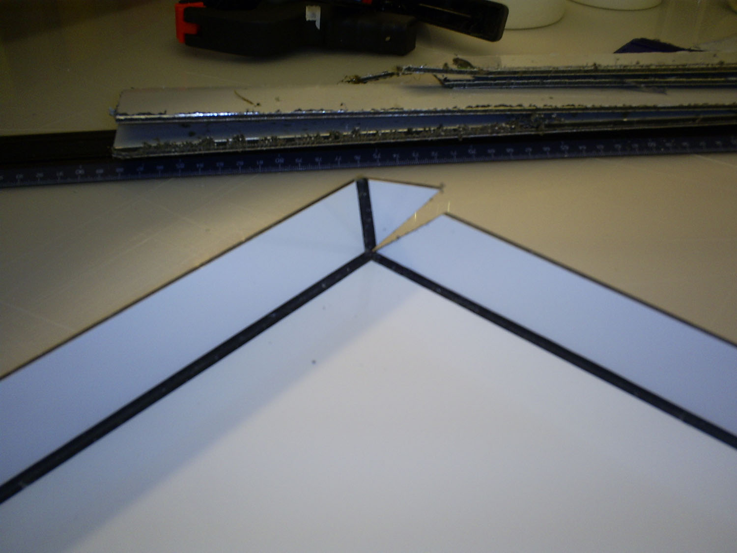

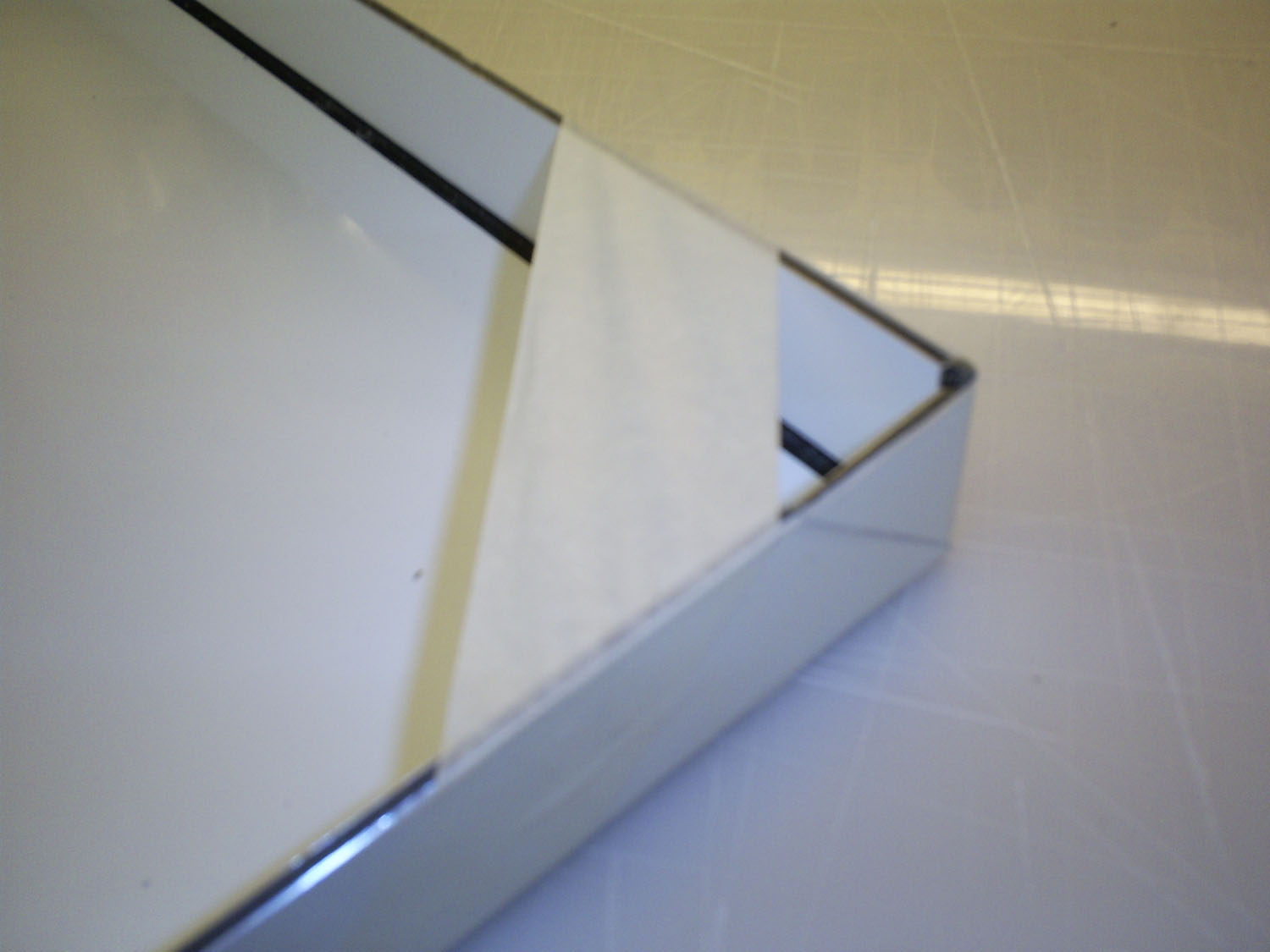

    After seeing Rich’s great work, it has influenced me to try making a sign tray, here’s a couple of pics, but what glue should I use down the folds? I know they suggest a hot plastic welder but that’s expensive. Is a hot glue gun suitable? , or got some "sticks like sh*t" in the van.

    Alistair, I wouldn’t have thought a lot glue gun would be suitable as its not going to get into the folds, just sort of stick to the upright edge if you see what I mean. I have used contact adhesive which seems to work well and also Penloc which is a 2 part adhesive sold by Eurobond.
    22 January 2007 at 18:15
    Alistair, that’s a neat way to do corners, but to hot weld would be difficult anyway, as there is very little "exposed " plastic, I would use evo stick serious stuff , I have heard bad reports about the sticks like..
    I would use a joining plate though, to overlap the section.
    Or any two pack epoxy would be equally acceptable

    22 January 2007 at 18:32
    Hi
    i make my corners in the same way it allows you to put the joins on the least noticeable sides. I then back it with a off cut & a bit of VHB tape if its a large tray i use a few 1/8 rivets as well. I also place some 50mm strips of aluminum angle at regular intervals along the folded edge fixed with VHB tape.

    I use gripfill. Once the sign is fitted the edges are held in place anyway, by the fixings through the sides.

    Thanks for all the help. This is my first tray Rich, gonna try the other corner method next time and see which I prefer.
