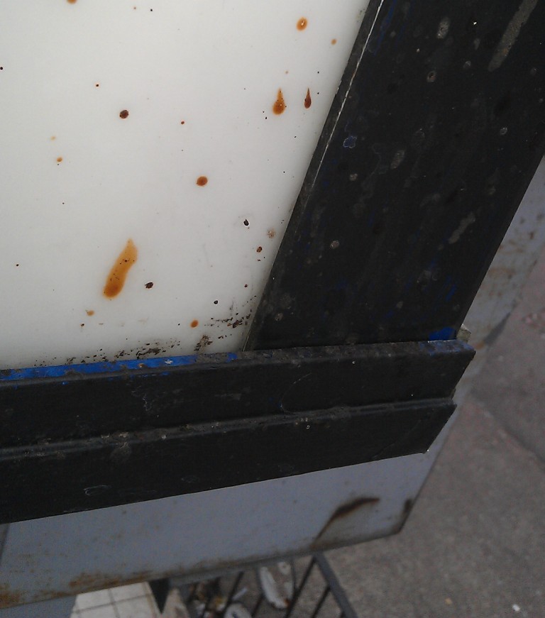

    Could someone tell me how i would remove this angled edge so that I can slide out the old perspex boards.
    From what i can see there is one screw underneath the end piece, would this be all that is holding it in?
    I cant see any more screws or rivets holding any of the other trim in place.
    Many Thanks
  • Adrian Hewson
    11 October 2012 at 08:16
    need more pictures wider view
  • David Rogers
    11 October 2012 at 08:18
    It doesn’t look like any lightbox frame you could buy as the bottom / side are different and not flat to the surface (one on top of the other).
    Looks a bit home-made / patched up so it’s anybody’s guess how it was assembled.
    Wider picture may help – and image of a side.

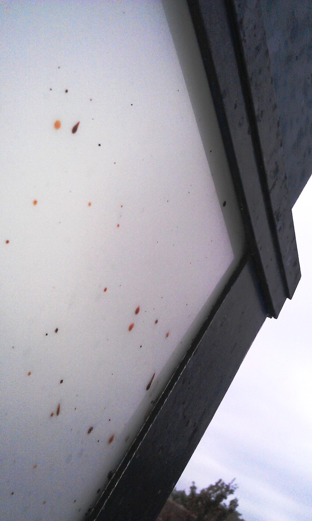

  • martin joyce
    11 October 2012 at 08:33
    Unfortunately, this is the only other image that I have.
    I think it may be a homemade frame as it doesnt seem to be a very professional finish in places.
