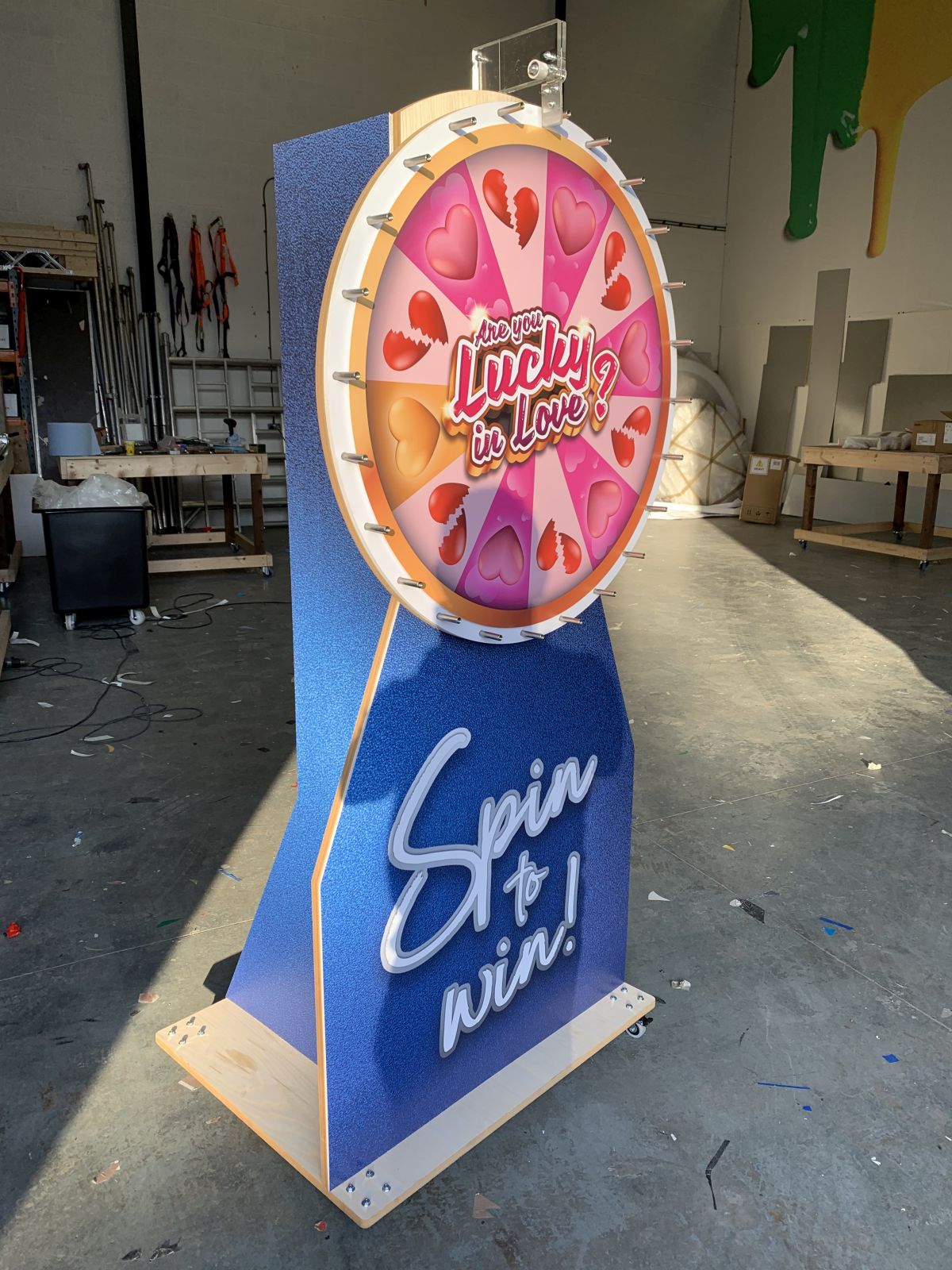

    Whilst doing an odd post on the boards thought I’d share this one. Not the biggest or most complex of things we’ve done but the one I personally have really enjoyed making. The graphics are velcro’d on so the shopping centre can change them for each event. If we get time we are making another to establish who does the next brew round.

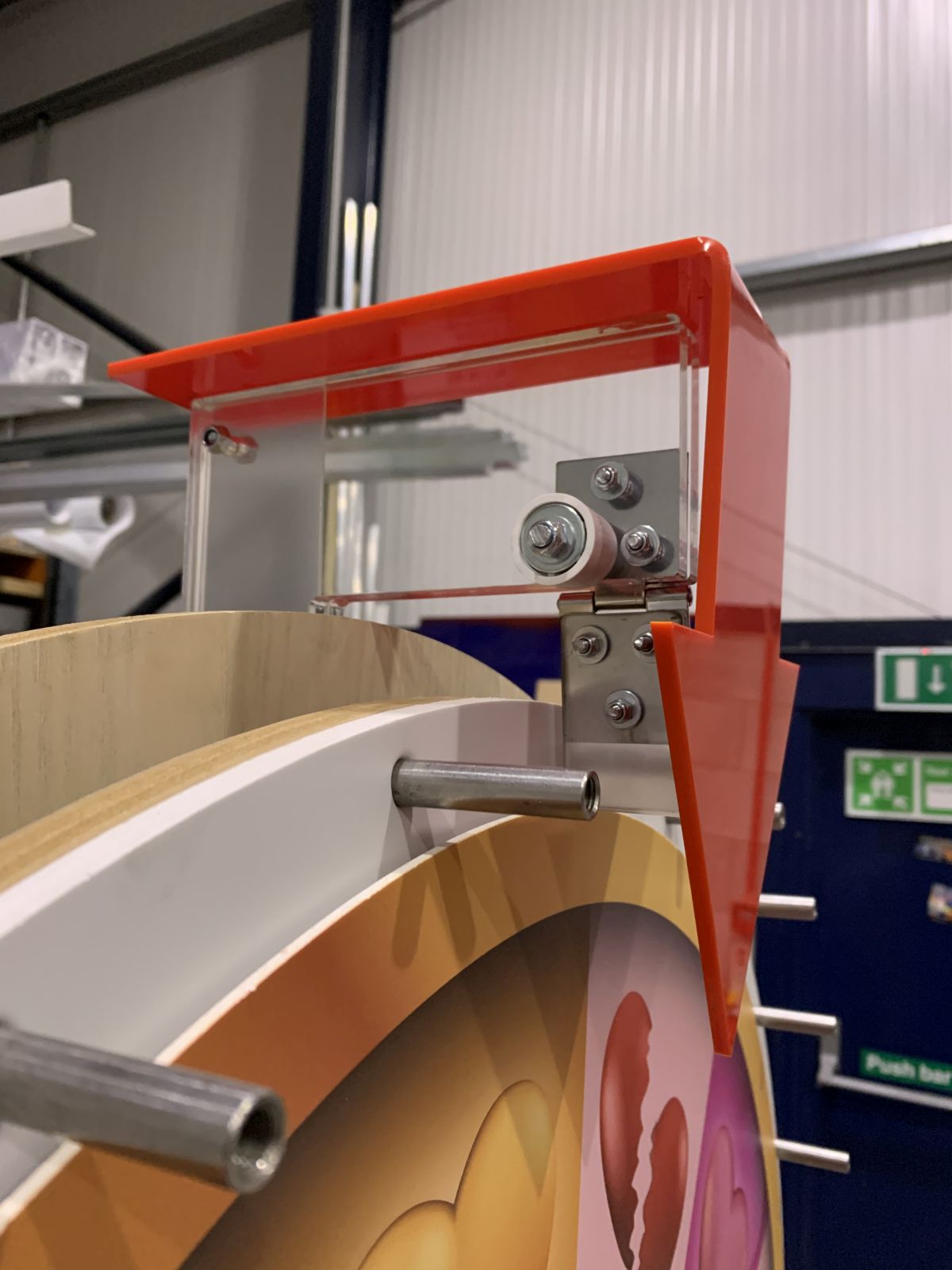

    What’s the little white ‘wheel’ at top for?
    5 March 2020 at 20:15
    quote John Hughes:
    😆 exactly what I was going to ask, John!
    Looks excellent David. It is things like this that make our job so interesting. never the same thing, always new and interesting projects to work on. thanks for taking the time to share!
  • David McDonald
    5 March 2020 at 21:48
    Hi Rob / John
    It does look like a wheel but its a pair of rubber doorstops, one either side. It dampens the ‘clacker’ (not a phrase I’ve ever used before), We can tighten the bolt through to spread them out wider to adjust how fast the clacker (a hinge) bounces back down to make sure it doesn’t skip any of the pegs regardless of how fast or slow someone spins the wheel – worked really well. We could have used some type of springs to make the clacker self return to a central position in time for the next peg coming round but sometimes a more simple solution can be more reliable (and didn’t have any springs in the workshop but seemed to have loads of rubber doorstops floating around from some long forgotten project).
