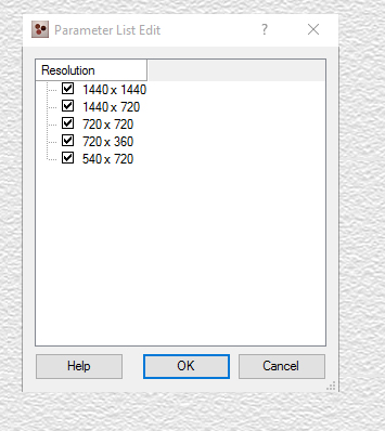

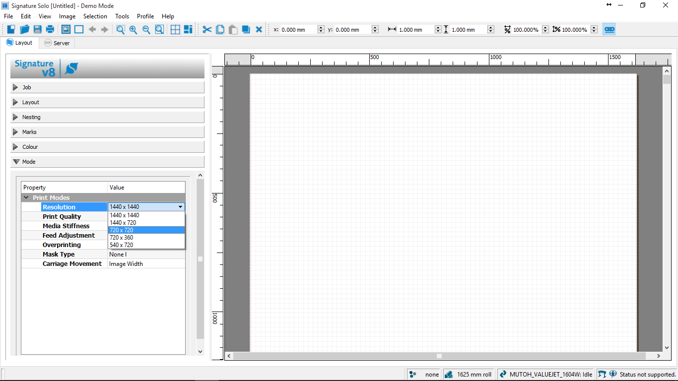

    I’ve just checked in the latest version of Shiraz and although it has the driver for the 1604W, it doesn’t have any profiles available as standard. However, the colour management part of Shiraz is very simple to use if you already have the hardware to hand (I use an eye1).
    I’ve done a screen shot so you can see the available resolutions as standard. I don’t see any reason why you wouldn’t be able to create profiles for 360×360 too.
    Stafford
  • Stafford Cox
    20 October 2015 at 10:18
    Actually, I just checked and these are the only resolutions available. I would imagine that these are the only modes released by Mutoh in their SDK’s.
    I hope that’s of use to you?
    Stafford
  • IvoFotev
    27 October 2015 at 11:15
    Thanks a lot for the answer ! Seems like Shiraz has also the BILLBOARD mode 720/360/Bi which is actually the fastest possible ( but more than suitable for sublimation ). I finally come to use Wasatch 6.6 , which I find quite ugly …but offers the speed I need !!
