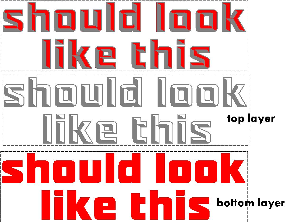

    Not sure why you are using punched holes, I would use reg marks or the weed border, anyway it should look like this

    Peter – Thanks for you example, the font I am using is pre-made by ingram publishing. I was using the punched holes as per my design for alignment, have I done this incorrectly as you mention I should be using reg marks which I thought these were?

    I can’t find any info on this in the “read me” file of the fonts and I don’t quite follow what I should be doing regarding the design reading the above. Any chance you could explain it again to me Peter.
    Nathan
    3 April 2005 at 10:04
    The race fonts from ingram consist of two sets, one plain and one chiseled.
    The plain font looks the same, but the spacing may be different.
    In effect if you place the chiseled version on top of the plain one they do not always line up.
    If you need a 2 colour version yo need to place the chiseled font on the background colour and weld it.
    Hope this makes sense.
    if not post the actual file, or words you are using an I will draw it for you.

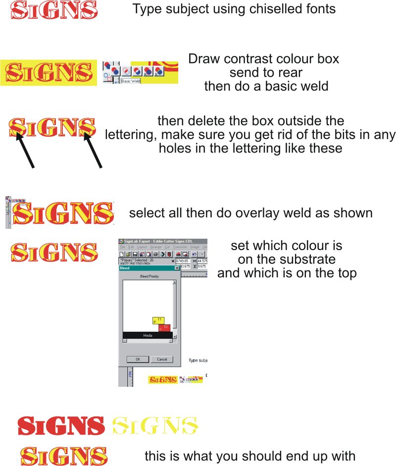

    This is how I do chisels in Signlab
