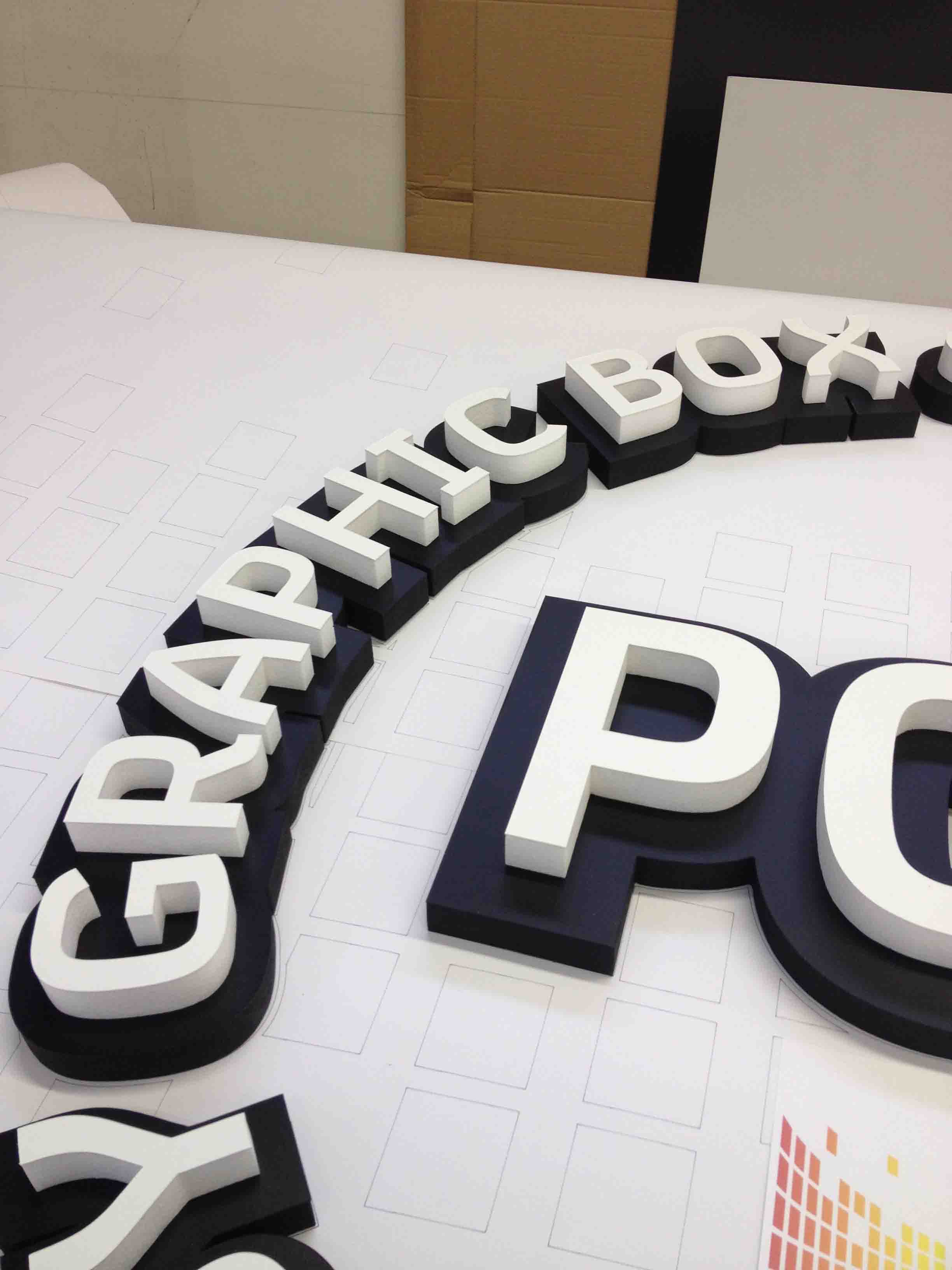

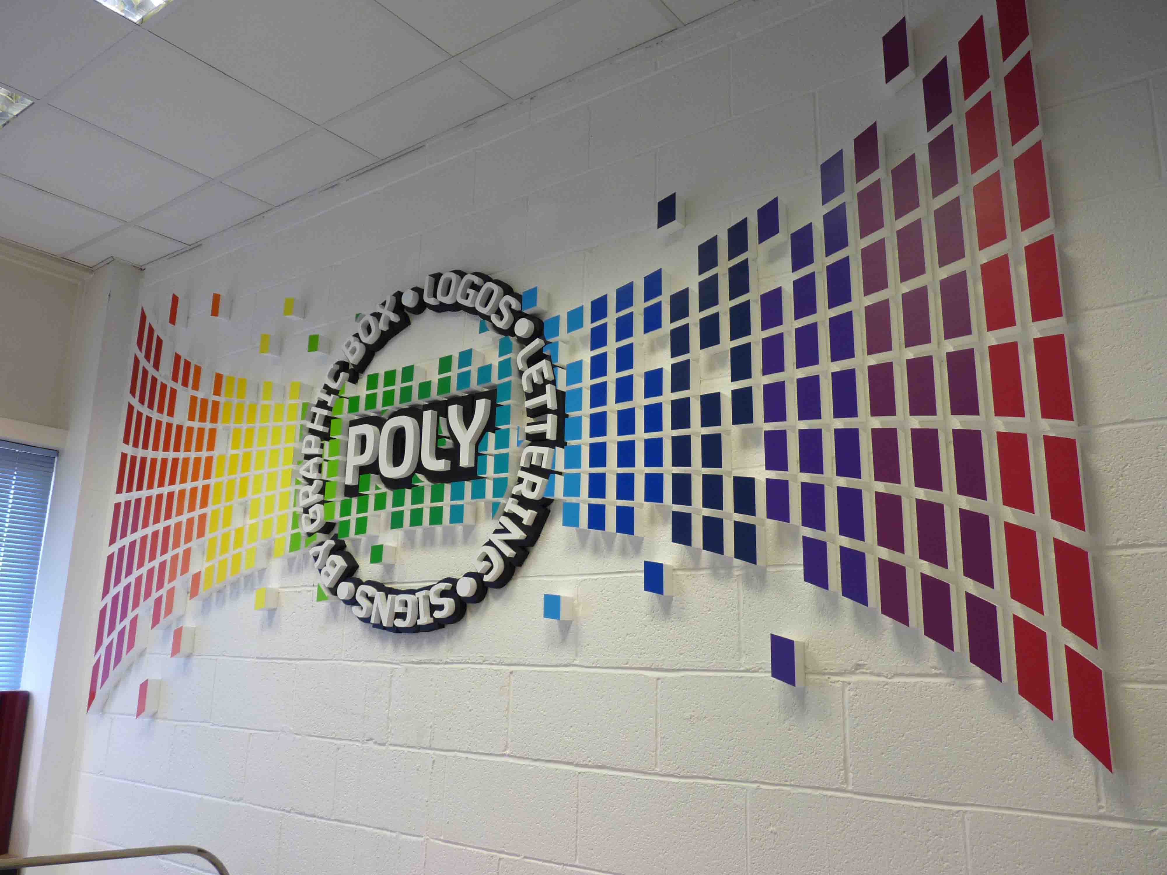

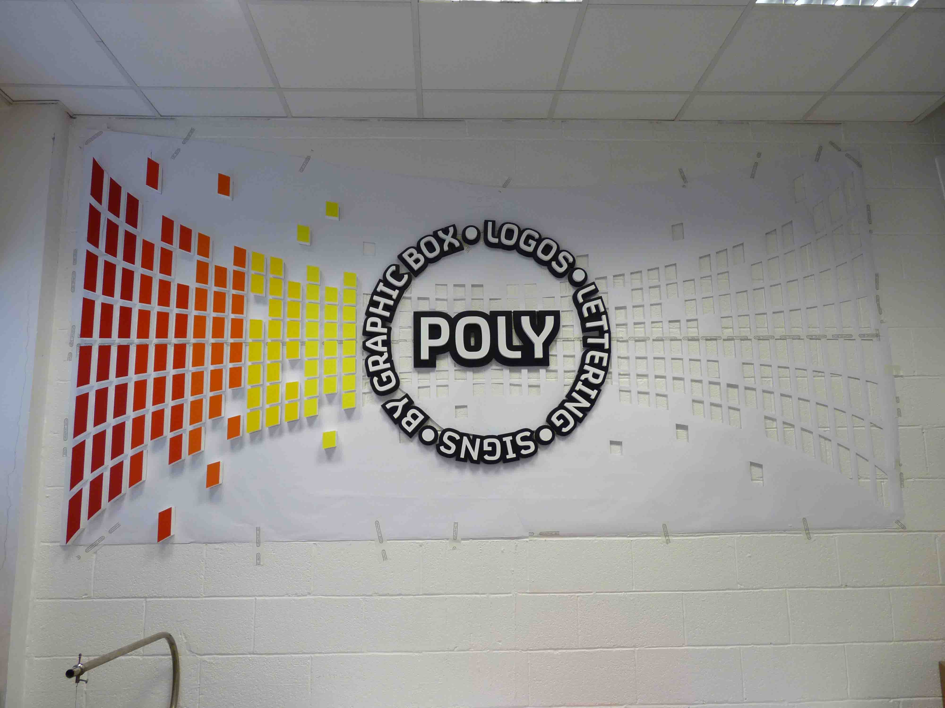

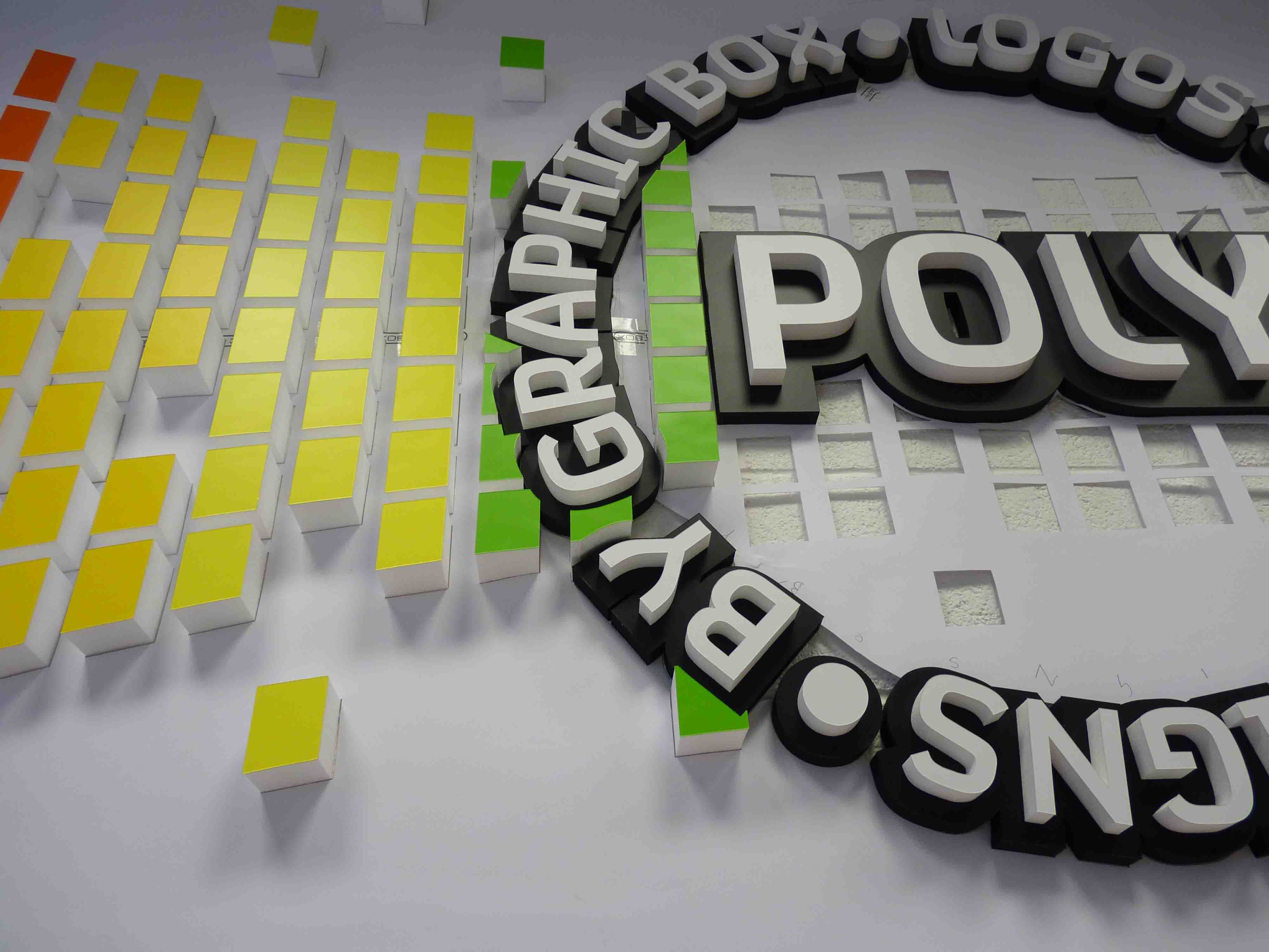

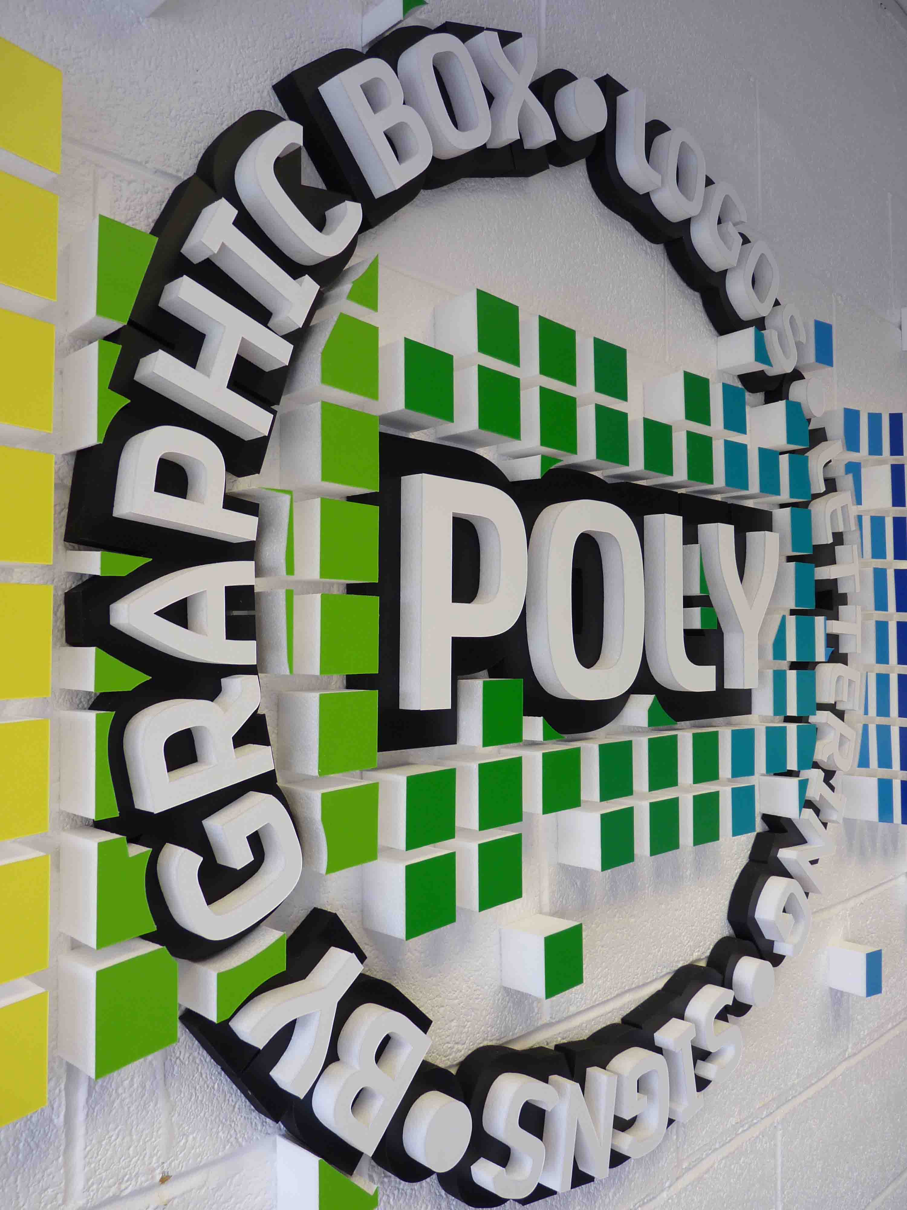

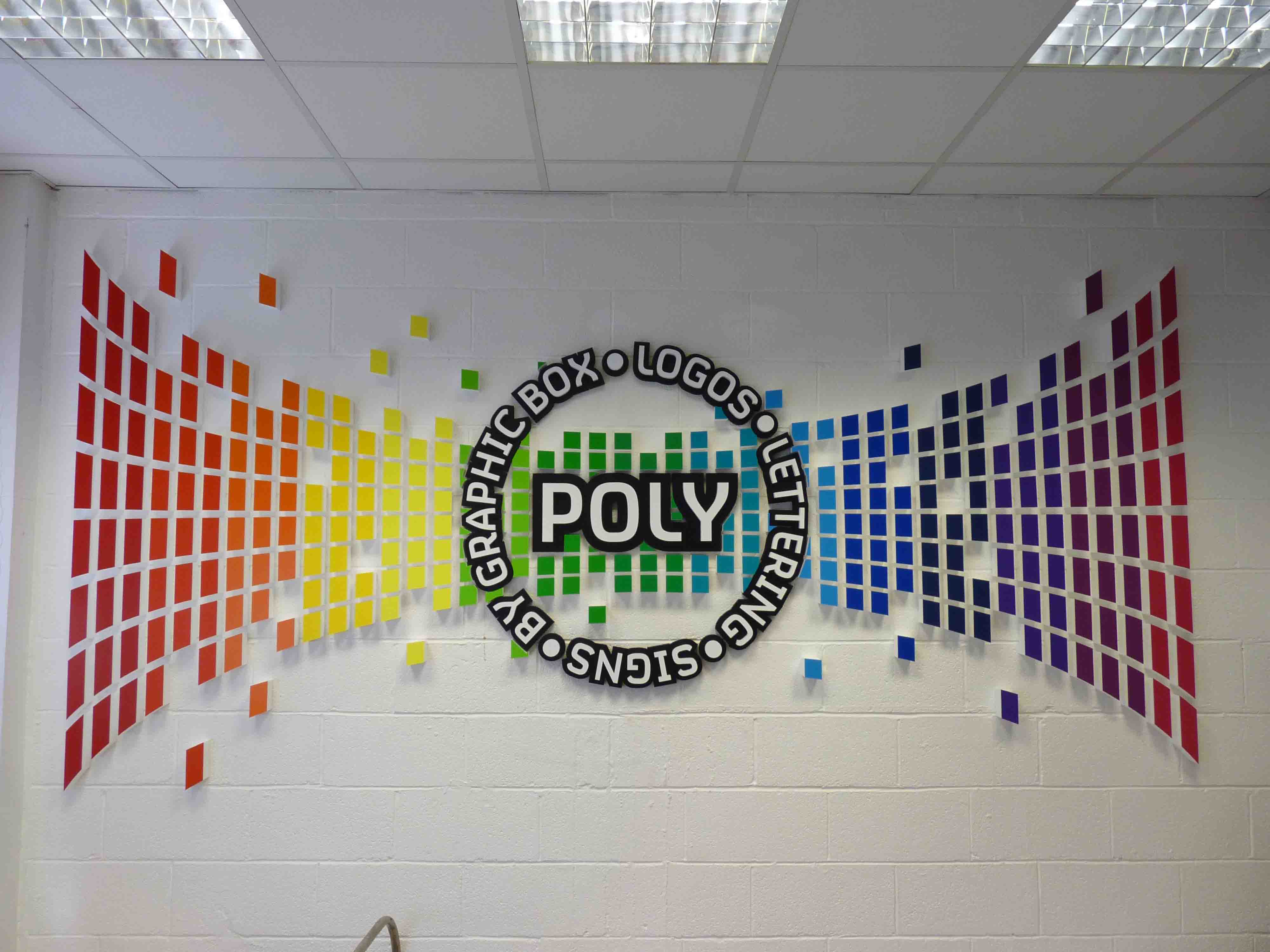

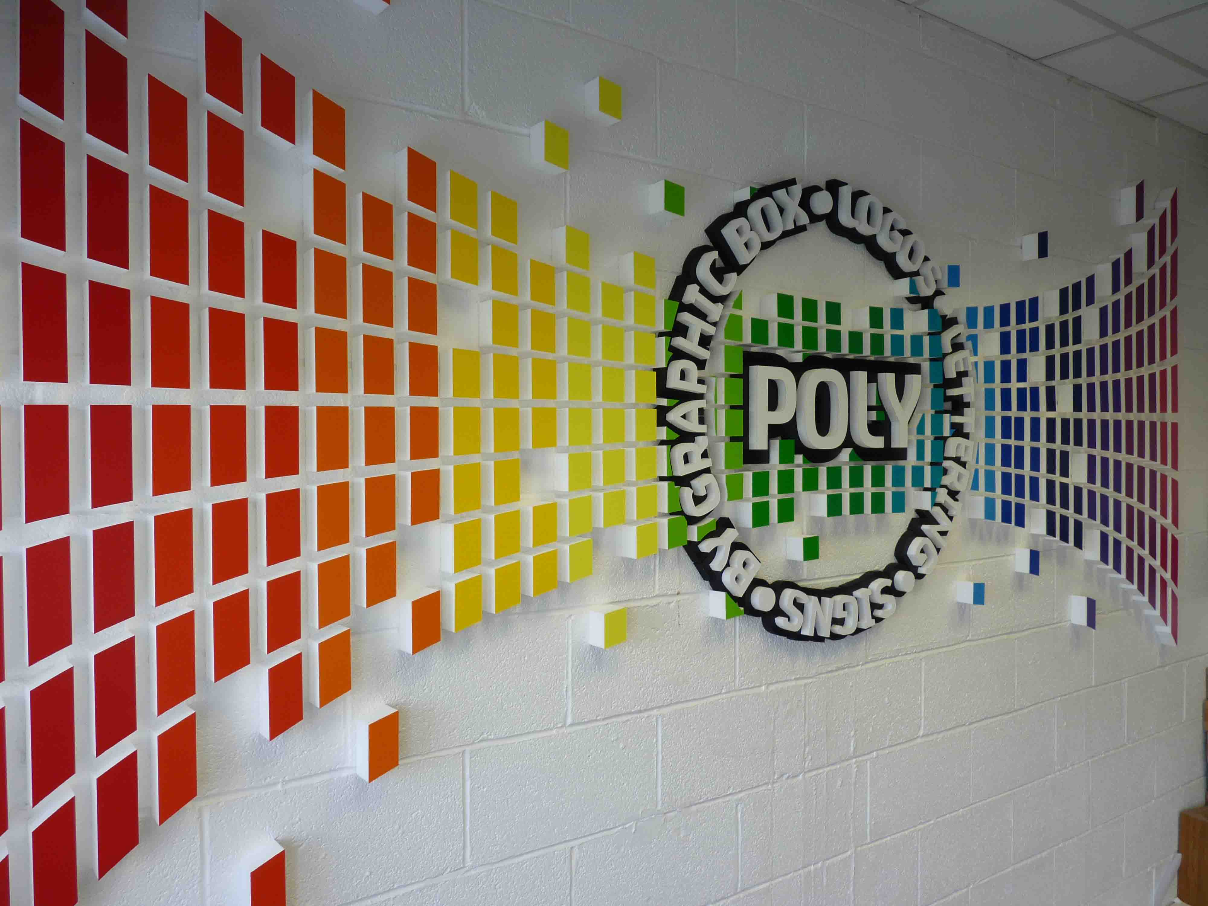

    Thought I would share this polystyrene piece which I’ve been working on between jobs.

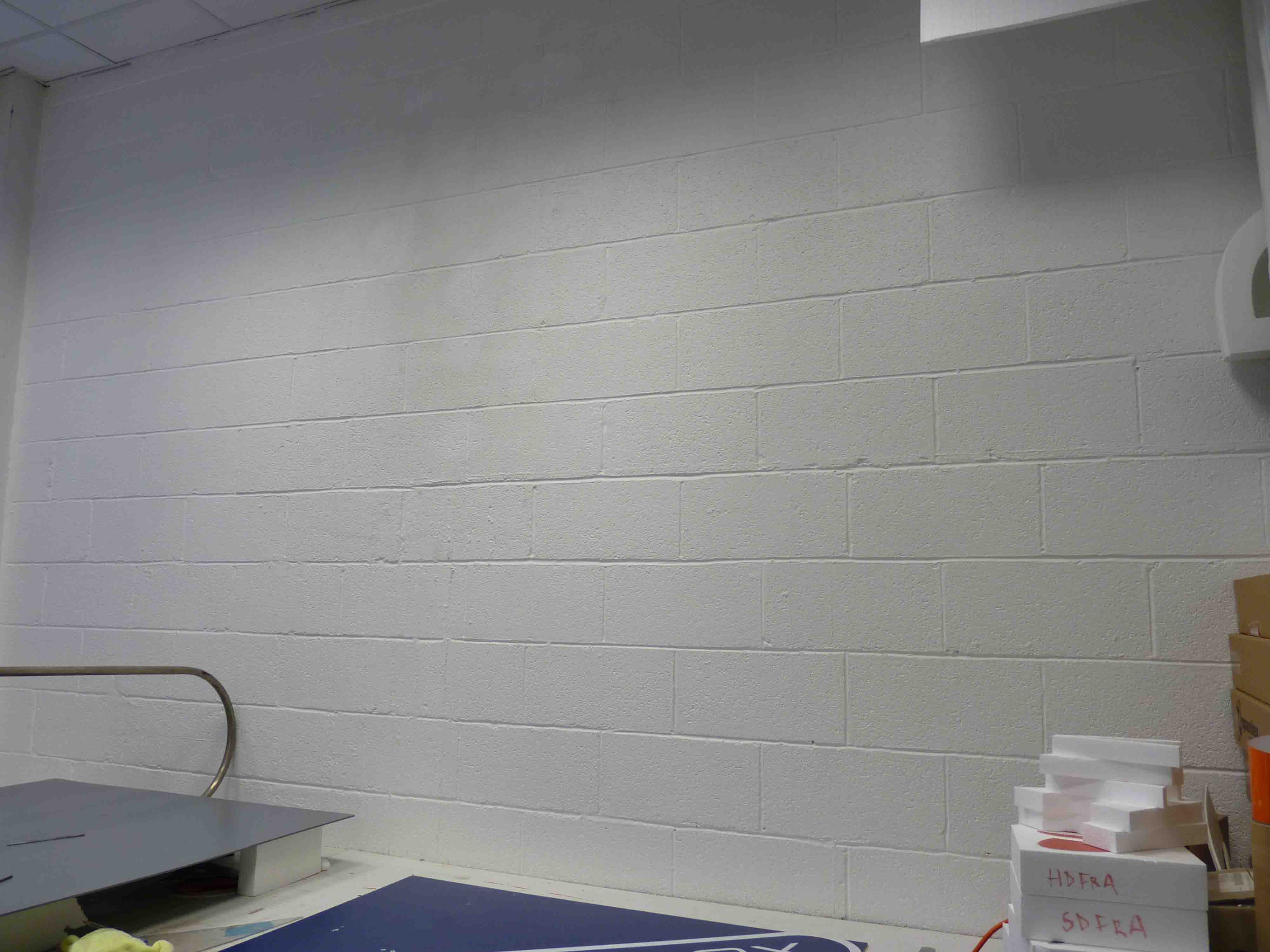

    We had a big bare wall in our unit which was screaming for a bit of colour and had the idea of doing a bit of a show piece to show to any clients who were thinking of going down the poly route and also to show on our up-coming website.
    Wording is 25mm poly on a 25mm poly background (with painted sides), and the coloured blocks are 50mm poly. Over-all size 3500mm x 1700mm.

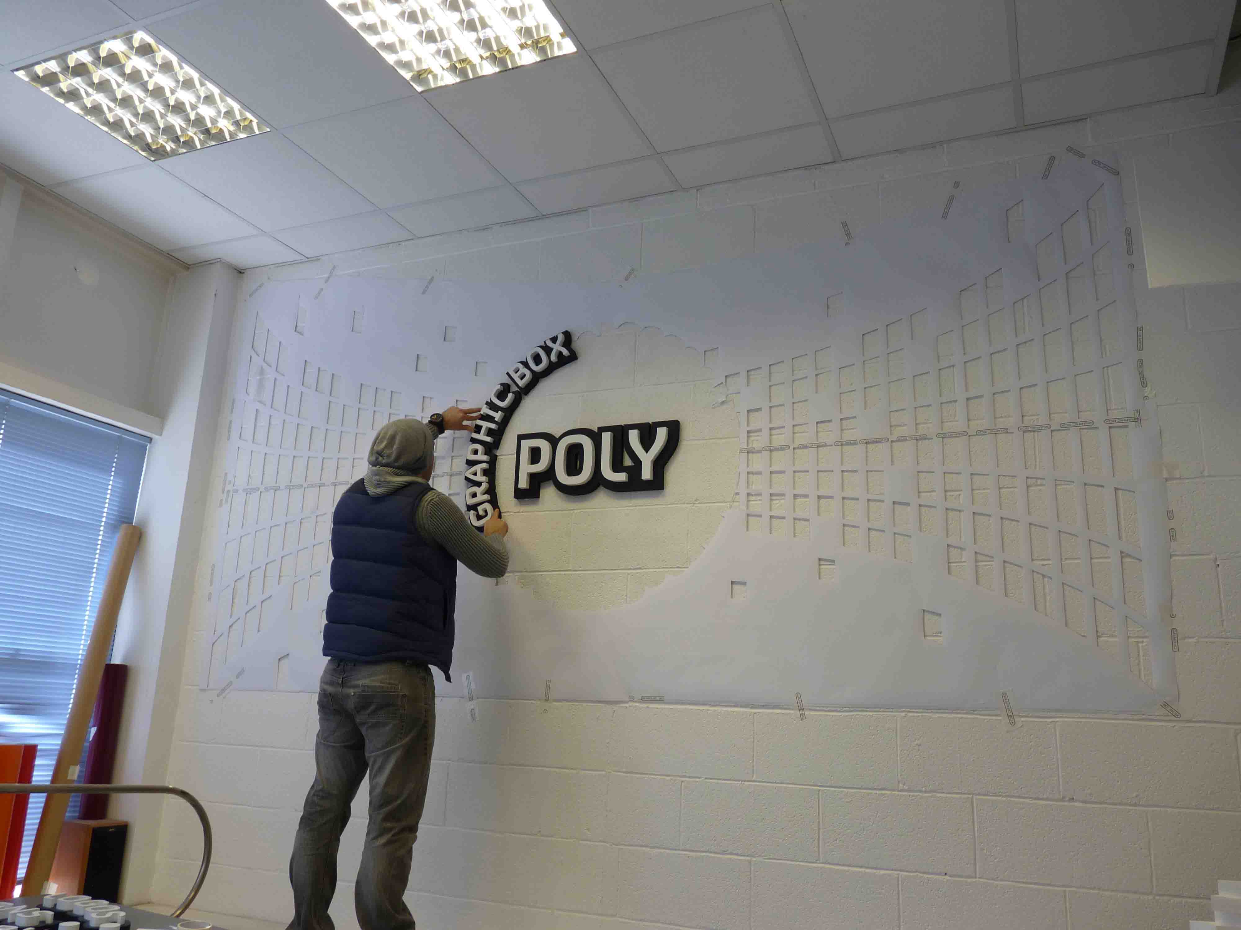

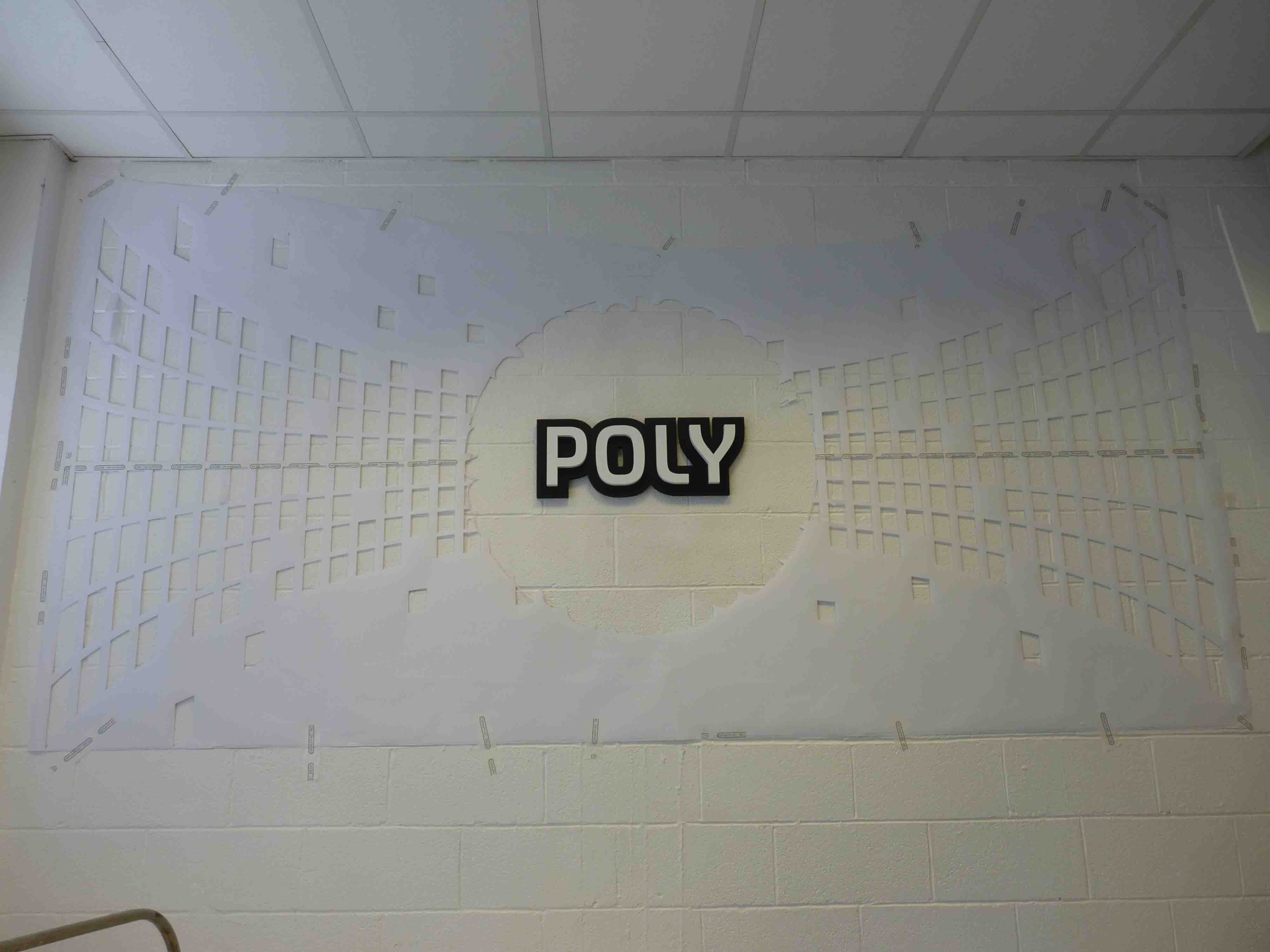

    All hand hot-wired and stuck on the wall with a bit of wood glue.
    A few pictures to show the progress.
    Hope you like
    Paul….

    Thanks for your kind comments everyone.
    quote Harry Cleary:
    That’a fantastic! What’s on the face of the poly?
    Harry, the poly is faced with card. Gives it a much cleaner look I think than painting.

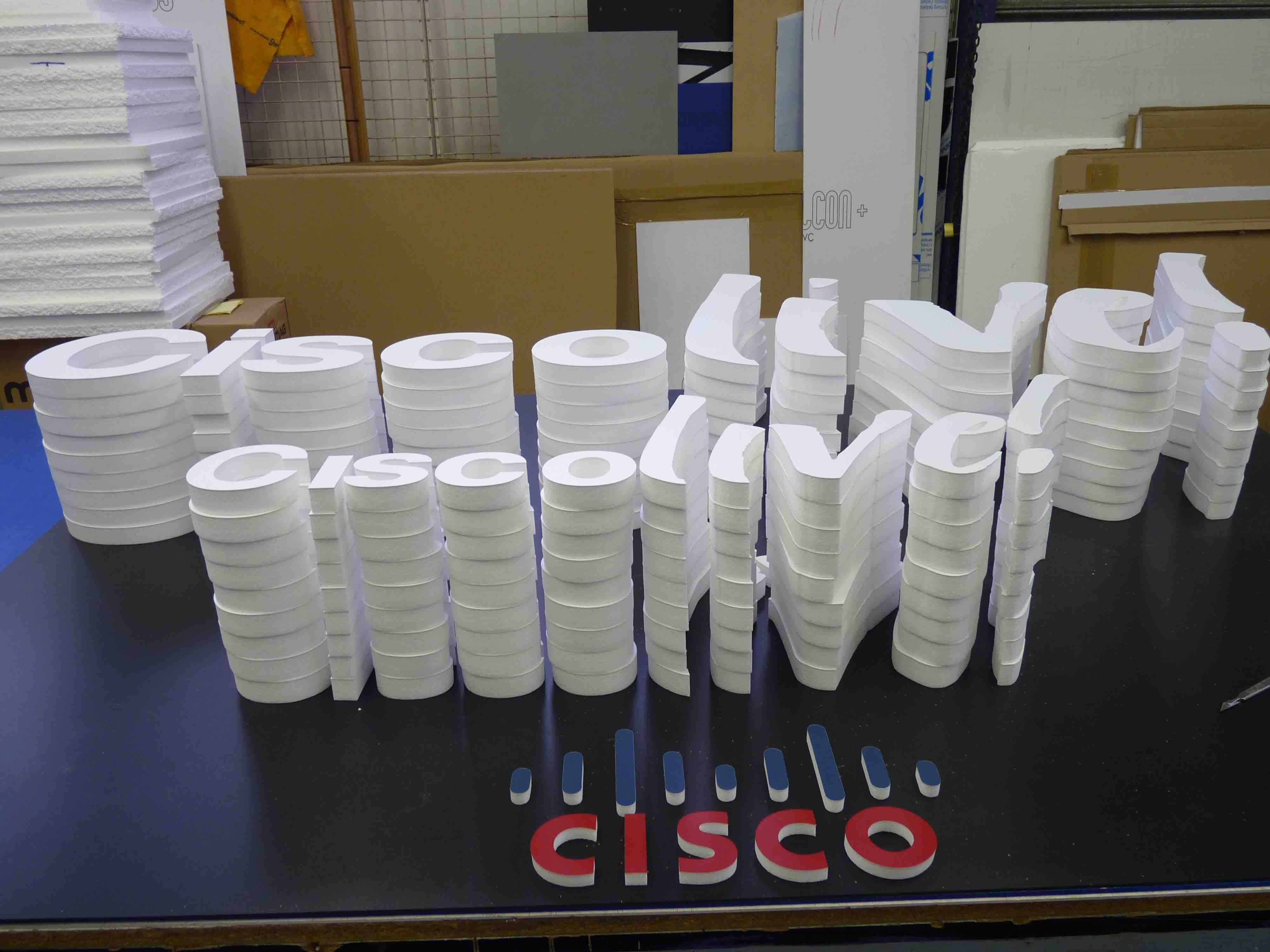

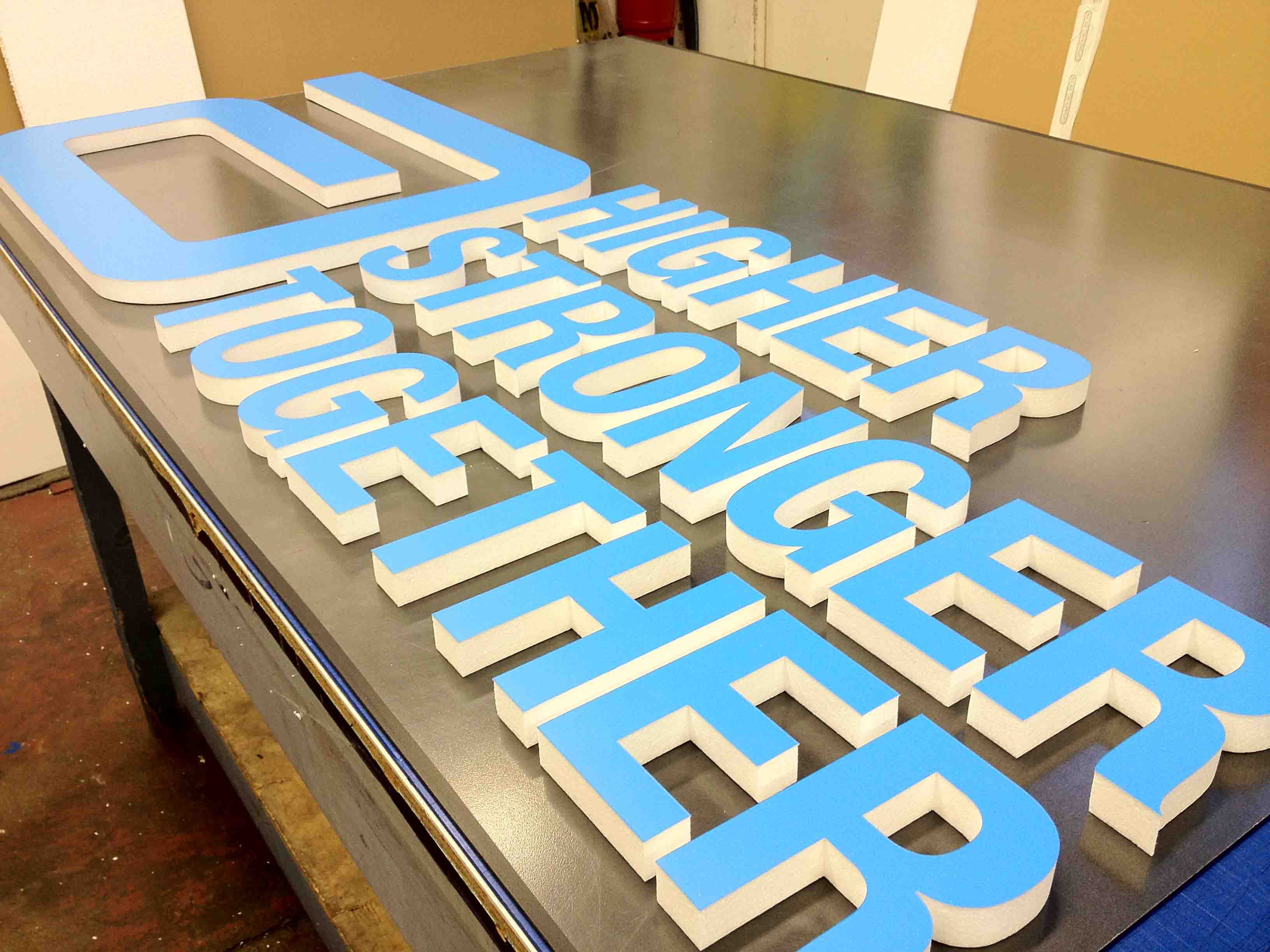

  • Paul Minton
    1 April 2012 at 22:20

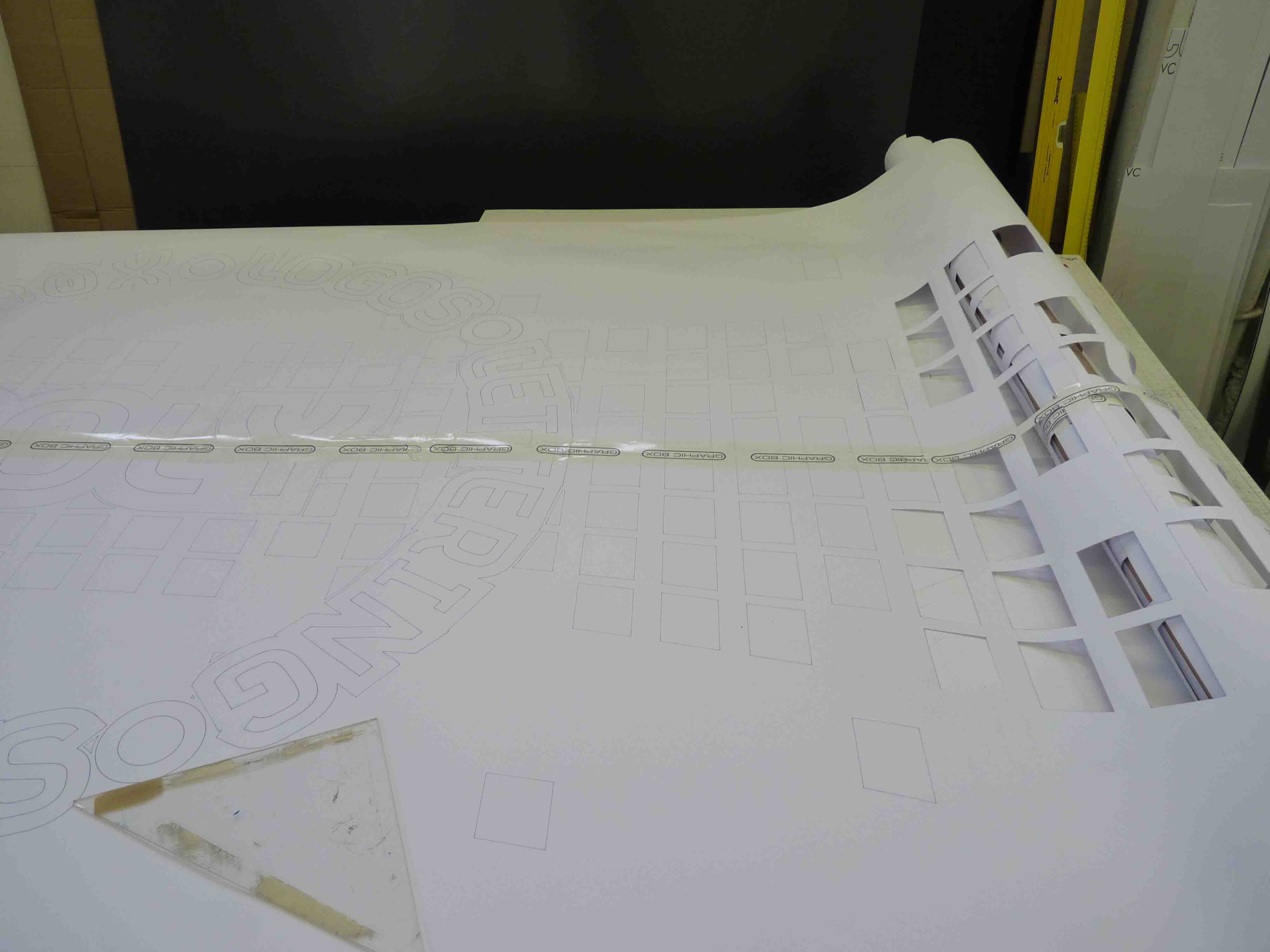

    [quote]as said a little more insight please,

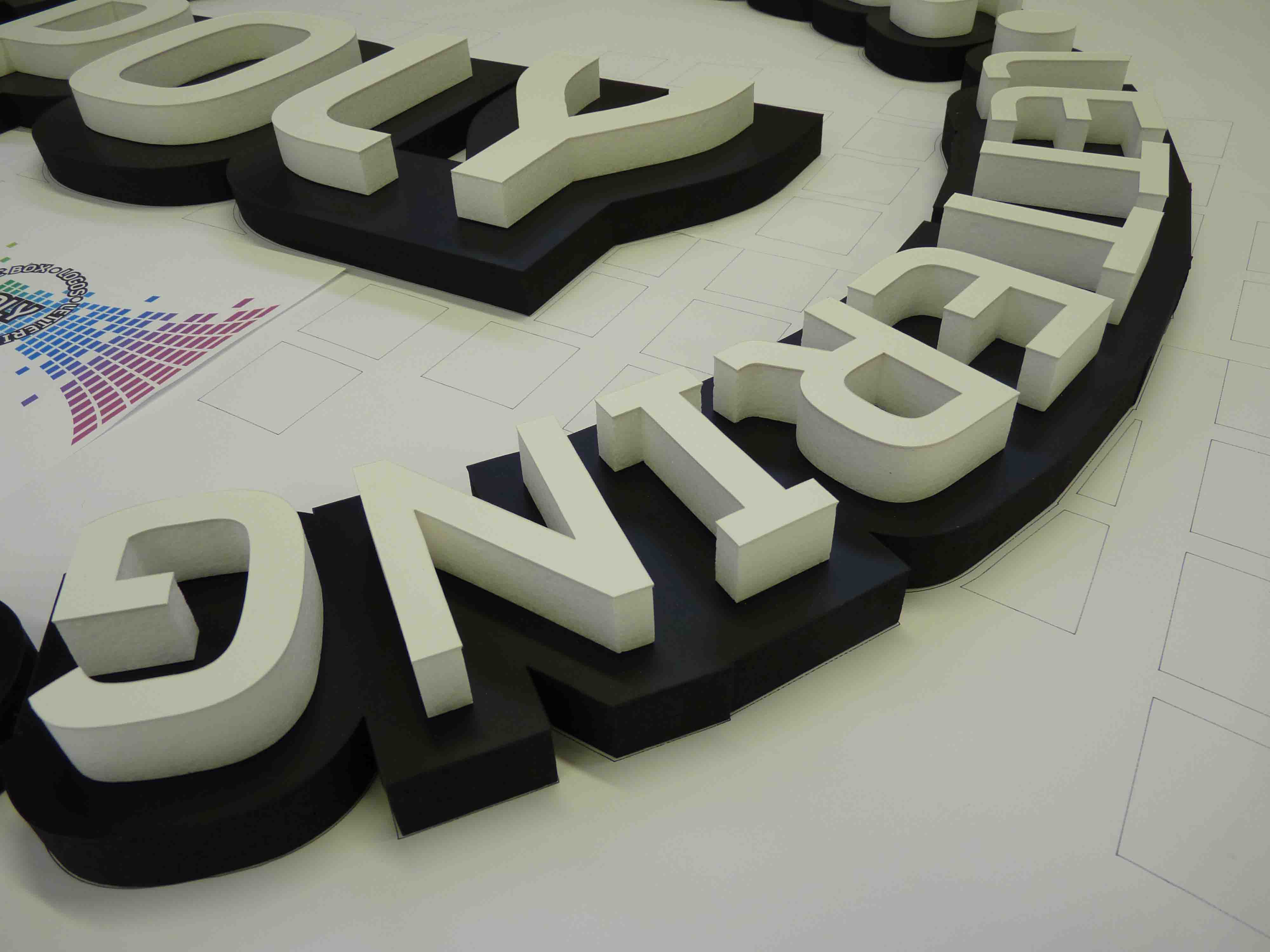

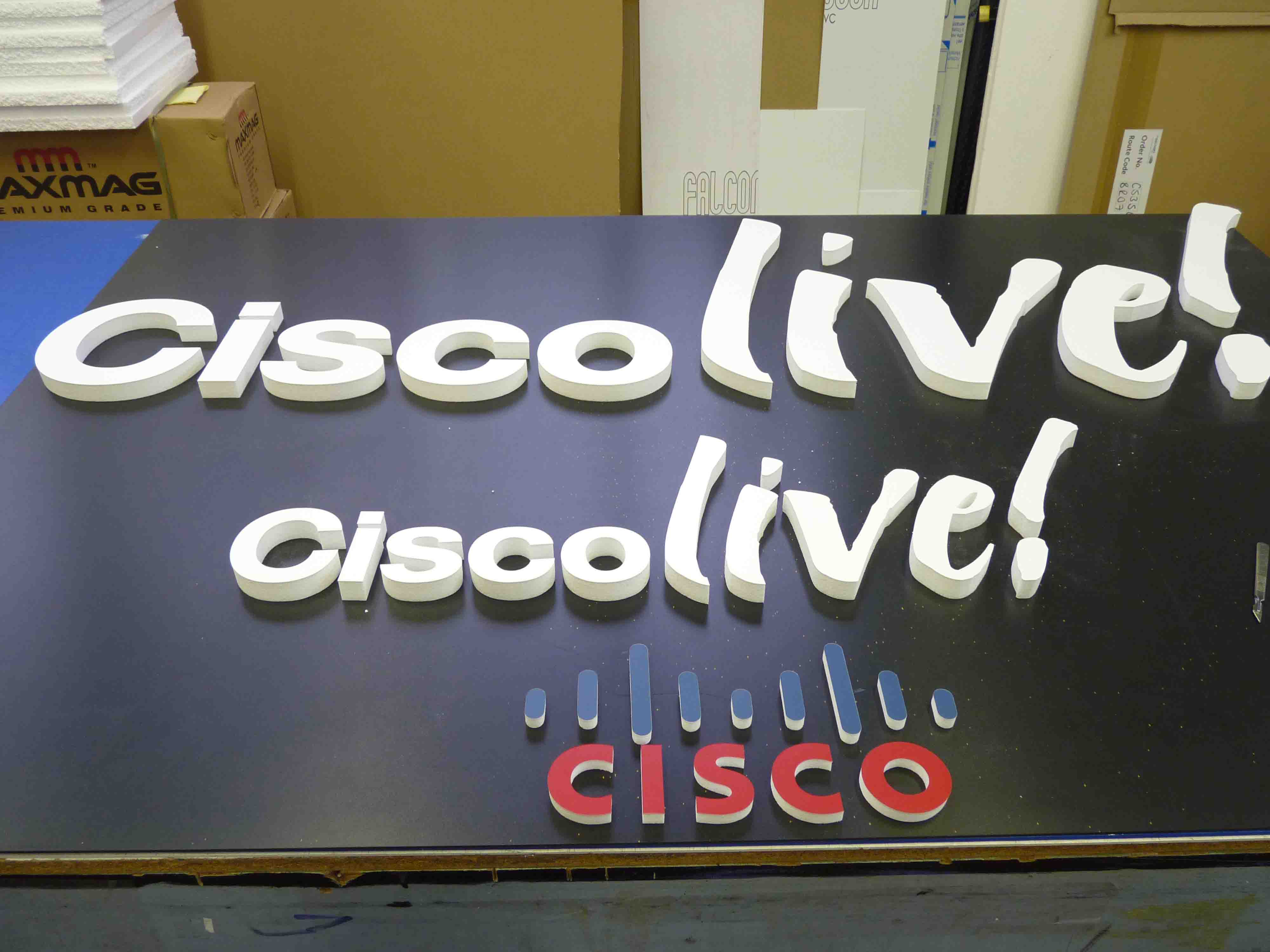

    It’s quite simple really, all you need is a good bit of patience when cutting the poly.

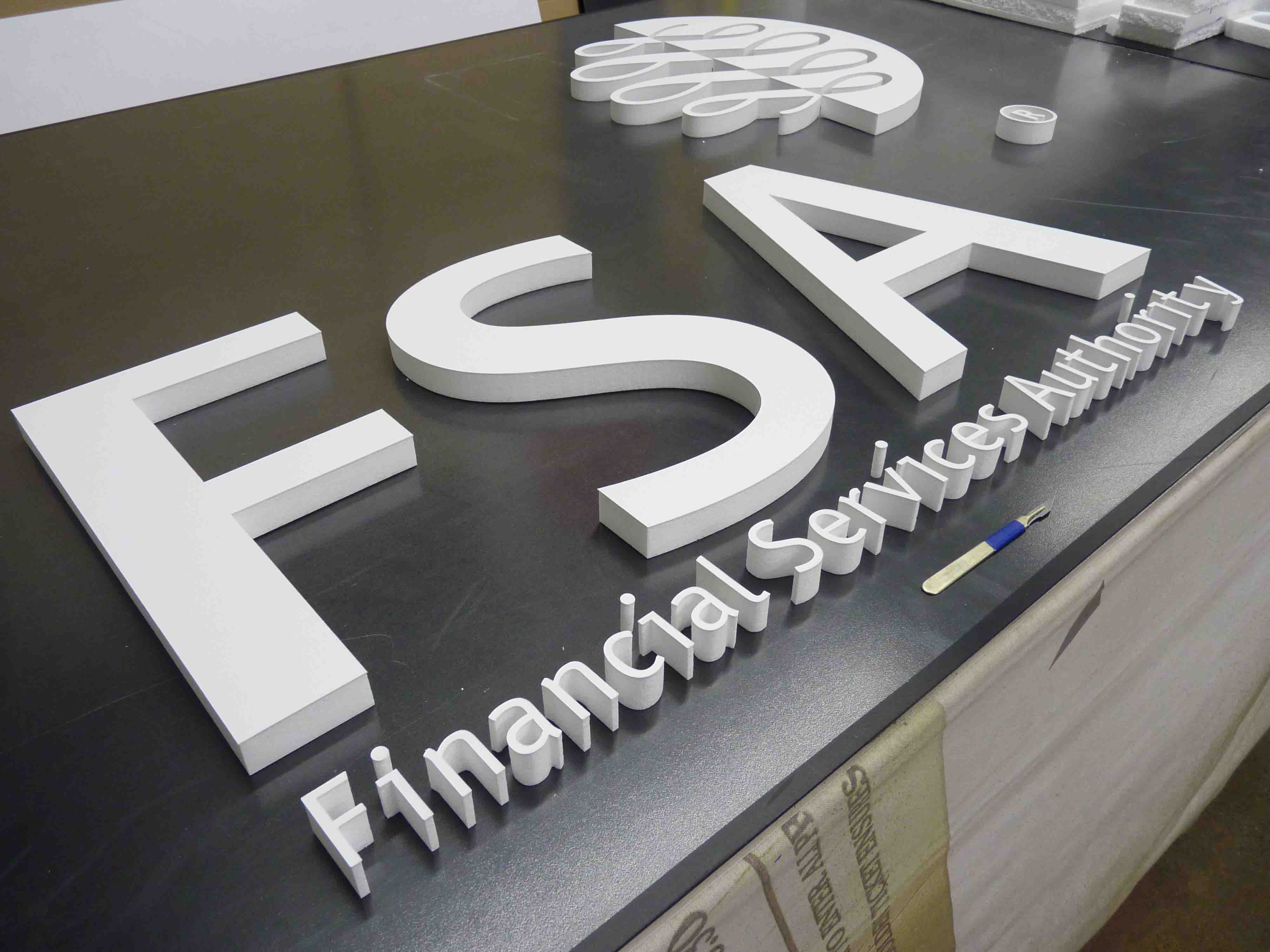

    We do all our artwork in Illustrator (has to be a vector file) which we export to our Zund P1200 (plotter, router) with Omega. Then we face some card, if needed, with vinyl in the appropriate colour on our laminator. The card is then cut on the Zund. The card letters/logos are then stuck onto the poly (we’re currently using a SHD FRA poly which is very tightly packed with small beads), with 3M spray glue and then its over to our faithful hotwire machine (which looks like its as old as me!!!). Its not a quick process I must admit, even before its cut on the hotwire, and when your cutting/burning the poly as I said above a good bit of patience is needed (but I think in the sign business its one trait we all have!)
    After all that your left with things like below, which is easily fixed to a conference set (which is usually stretched felt) with a bit of wood glue.
    (I’ve posted the FSA logo before but have put it in with a scalpel so you can judge the size)
