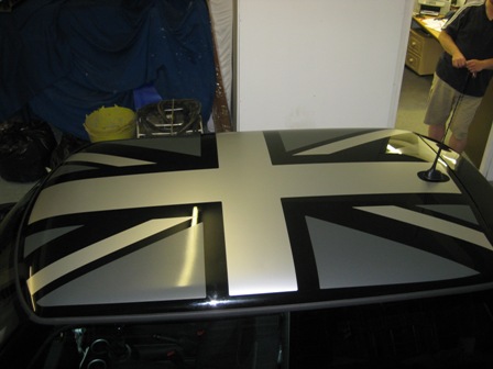

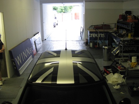

  • Derek Heron
    14 June 2010 at 13:35
    hi all thanks for all the input on this one
    still waiting for car and vinyl to arrive 👿
    i have a couple of templates to go to so fingers crossed should be ok
    😉 cheers
    thanks for the pointers regarding removal of the cover
    would have hated to damage anything
    the customer is bringing the car in and waiting .he hasn’t told his wife he is getting it done for her, just imagine his face as i try to lever the cover off !
    will let you know how it works out
    derek

  • Derek Heron
    15 June 2010 at 17:48
    thanks for the help on this one especially the template info.
    had to use larger one as the graphic had a small cut out to the rear for no apparent reason looks well and customer happy
    cheers
    derek 😀
