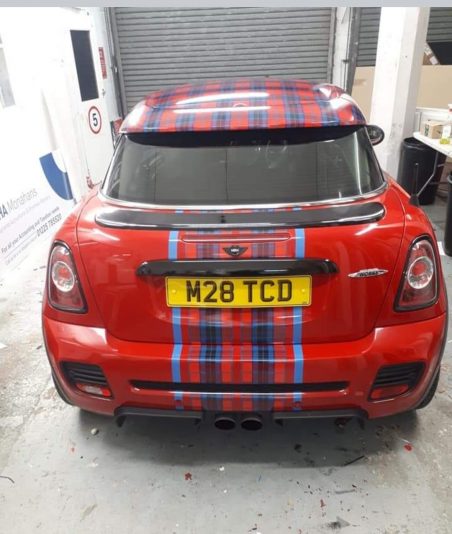

Did you use a vector template/kit to cut these or did you use knifeless or wrap-cut tape?

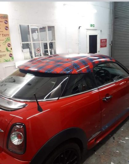

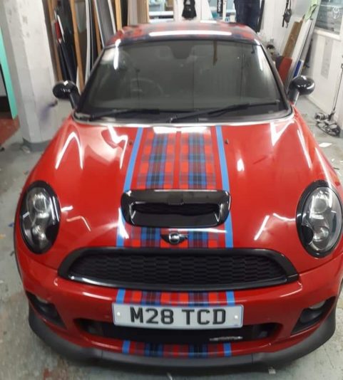

Actually no. Tartan printed on Avery MPI 1105. Straight roof wrap. Then I cut the stripes from the same print by hand. I had made sure that the tartan squares on the roof were the right width to match the stripes.

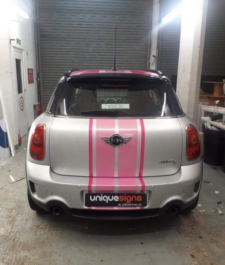

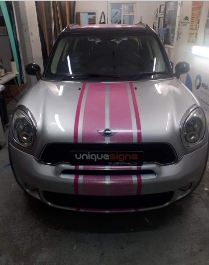

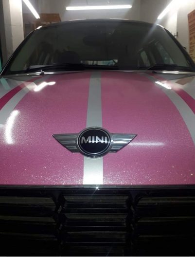

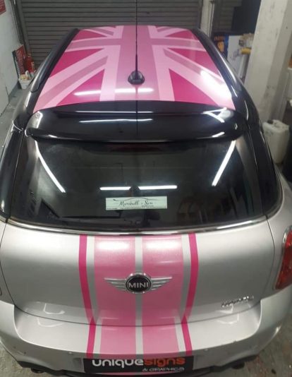

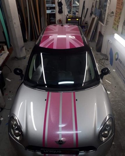

The pink Union Jack and stripes were all cut by hand. Avery supreme for the background wrap on the roof first then the flag cut by hand from two colours of Hexis. I had to cut that by hand as I wanted the large cross in the middle to have no joins. I couldn’t cut that wide on our plotter or Roland so no choice there.

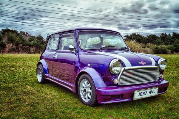

Nice job Tim,that looks mint! I did a mini not long back and getting them to look right over the bumpers was a nightmare.
I know what you mean David. Don’t dislike them but they aren’t really a mini. I had a 1275 GT when I was young. Fantastic car.
David, is this painted or wrapped?
another cool looking car.
That’s my 7th now Tim. Once you catch the mini bug it won’t go away 🙁 Every time I sell one a couple of years later another magically appears (to my wife’s disapproval lol).
It was resprayed years ago Gary. I’d love to wrap it but it’s 29 years old and there’s a couple of small rust spots appearing which would need dealt with before wrapping. It’s the normal problem, time & money.
