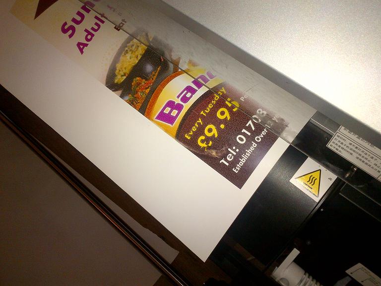

    Hey guys,
    Can anyone help me with an issue i have with printing on to poster paper? I have recently purchased a 200gsm roll of satin poster from paper graphics. However, they do not have a profile for the JV33-160. I am running rasterlink 5 SG. I have spoken to hybrid but they were not able to offer me much help. They suggested i drop the ink density to -15% but after trying this i still am seeing poor results. I have even tried running it at 6 passes and increased the pre/during/post heat settings also but no luck. Any suggestions and help would be most appreciated! I have a job which is supposed to be ready for Wednesday morning so your urgent assistance would be greatly appreciated.
    Thanks.

    so what is the problem?
    colour balance?
    not curing?
    roller pattern?
    ink pooling?
    when you print grey it comes out green or red or blueish?
    I doubt u find a profile… you just got to keep rotating profiles until you find one that works in that case… look at whiteness and compare it with another product you got.

    Dave, the image is blurry. Also, I think too much ink is being used and the print is not drying quick enough even though I’ve increased the temprature. However, when I drop the density level to -15% some colours start saturating.

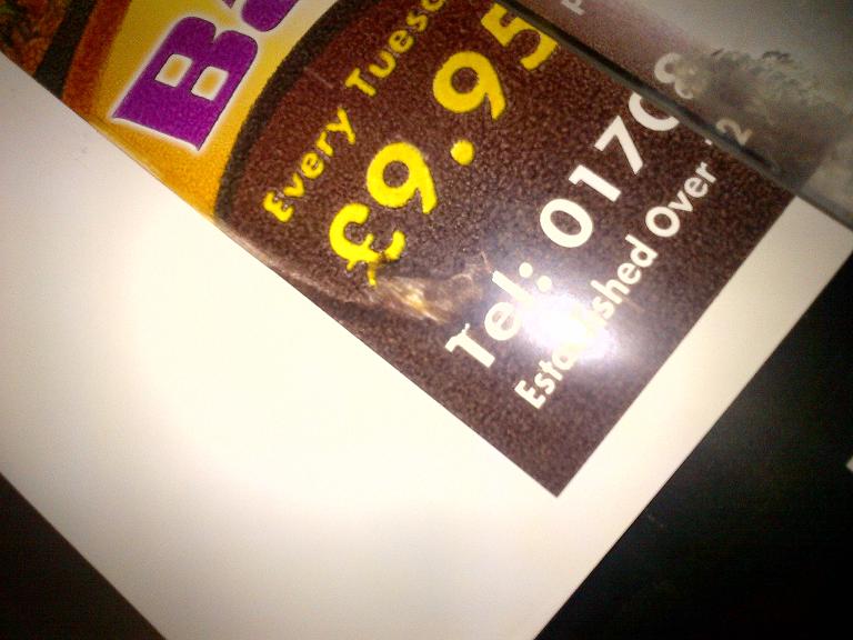

    Guys, attempted increasing the pass to both 12 and 24 but still seeing a blurry print. Please see the attached images. Have also tried dropping the ink density to -15% but these combinations are not working for me. Do you have any other ideas?

    I had the exactly same print problem with my mimaki and a blue back paper (same results as on your pctures).

    Have you tried any different profiles? We had to try about 5 before we found one that worked. Looks like the ink isn’t drying quick enough, and it’s putting too much ink down. You could try upping the temperature on the print heater. If the material cockles, turn the pre-heat right down, or even off. We use 200gsm gloss poster from Pyramid (it is a Sihl product called Tri-Solv), with excellent results on JV3 and JV33, with Onyx.
    PS….as David says, make sure it runs uni-directional. We can run 6 pass uni with
    heavy coverage on this paper with no problems, so I strongly suspect it’s the profile.

    That looks like ink pooling to me. The ink is just sitting on the surface of the media and running together. Is it definitely a solvent paper?
    If you’re looking for alternatives, the ones I used to get best results on a JV3 are Emblem Blueback or Hybrids own Satin Solvent Paper.
