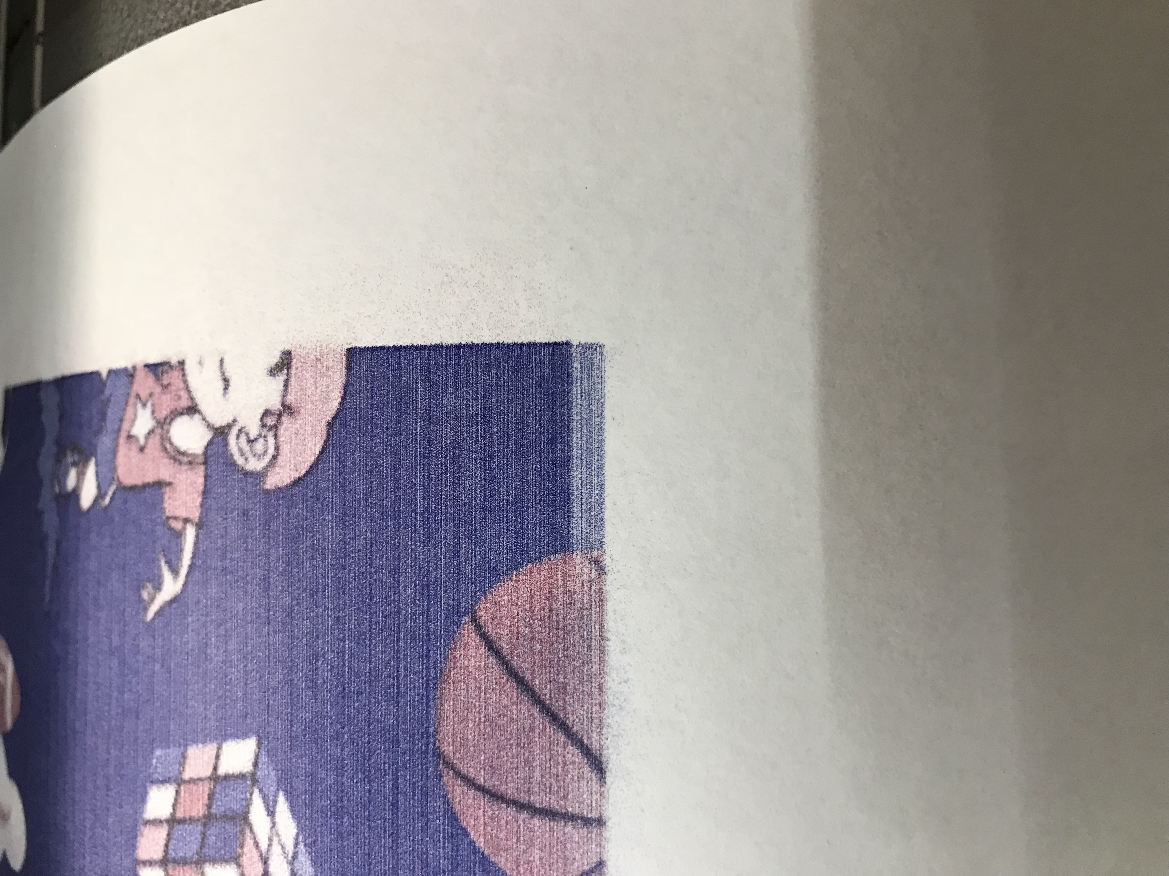

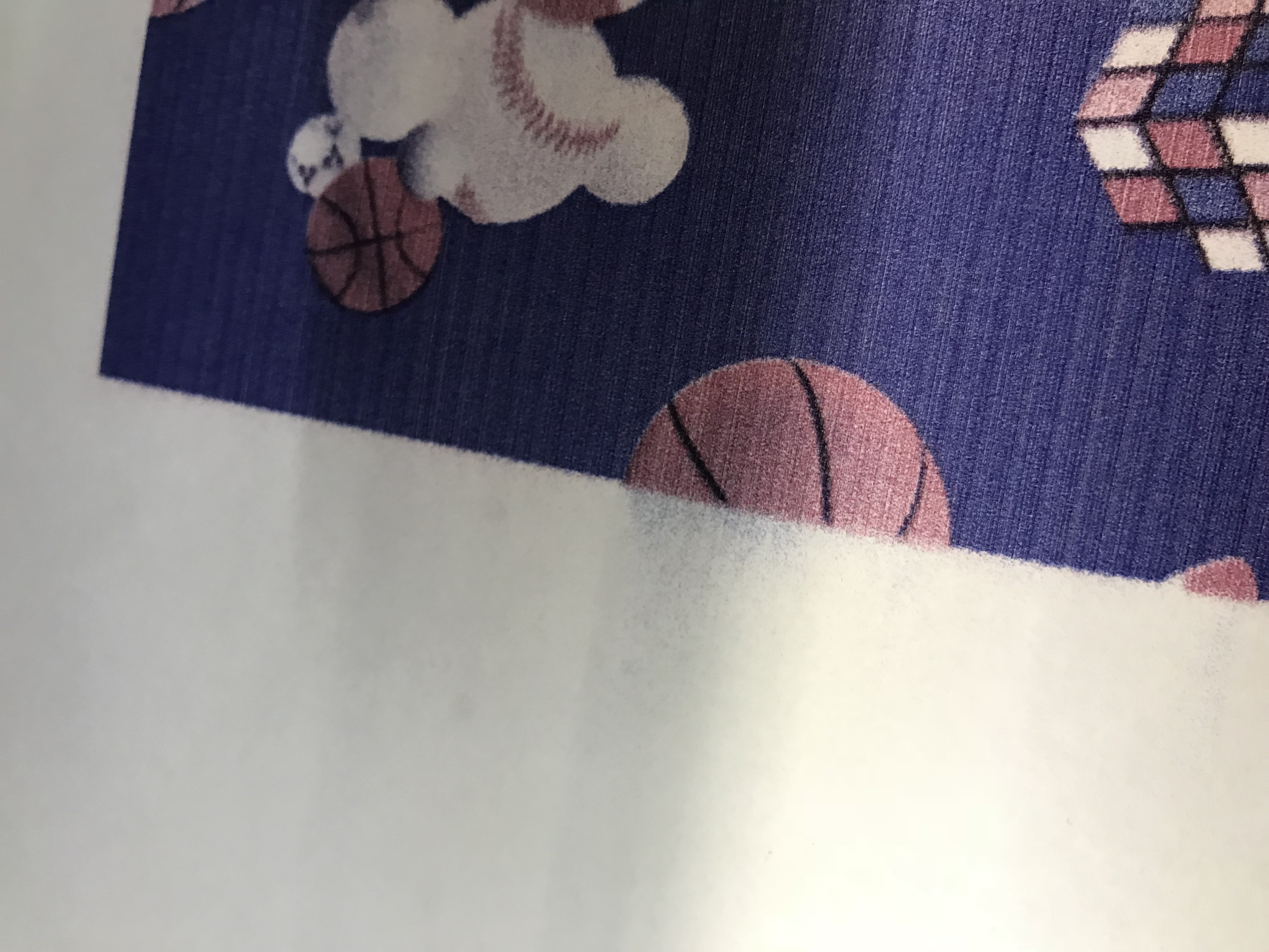

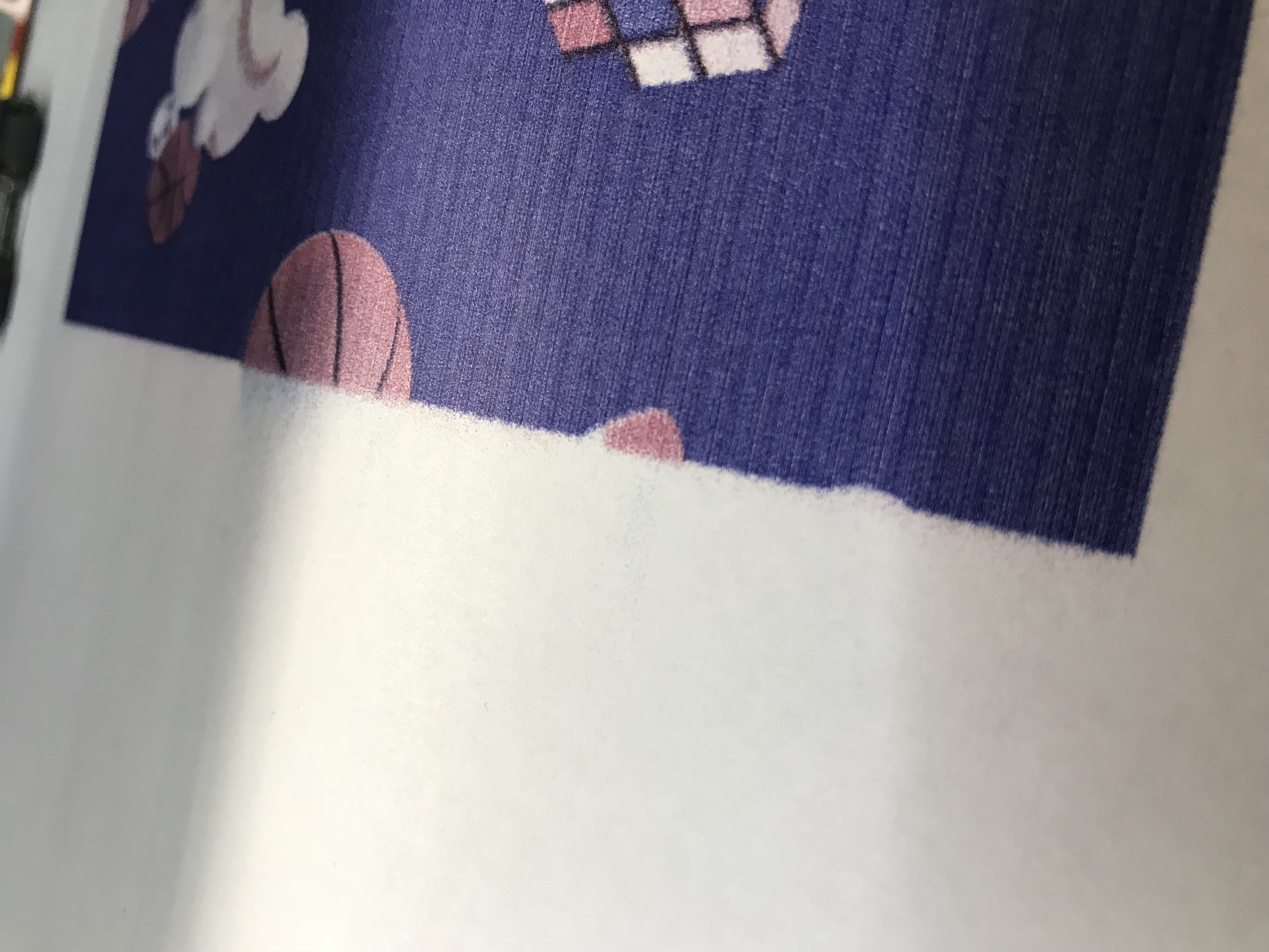

    Hi!
    I’d like to ask for assistance, regarding a problem that’s constant with my printer (Mimaki JV3-160S sublimation dye). When I start printing, the print is a bit hazy and the colors are spread everywhere, every direction. We put up new heads and changed the encoder strip recently. What should I do in this situation? I’ll attach some pictures.
    Thanks in advance

    Looks to me like poor quality printheads that have been poorly calibrated. Maybe even an electrical fault on your M or lm.

    maybee printhead it to high, mine is 2mm above the material and after setting hight remember to calibrate bidirectional printing
