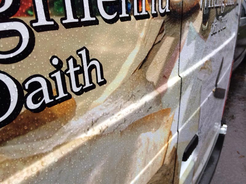

    here is a pic of what it’s doing on all the contours

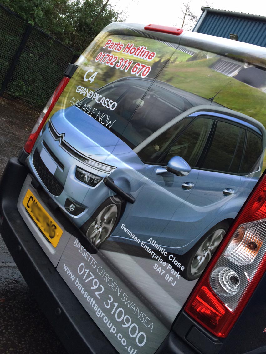

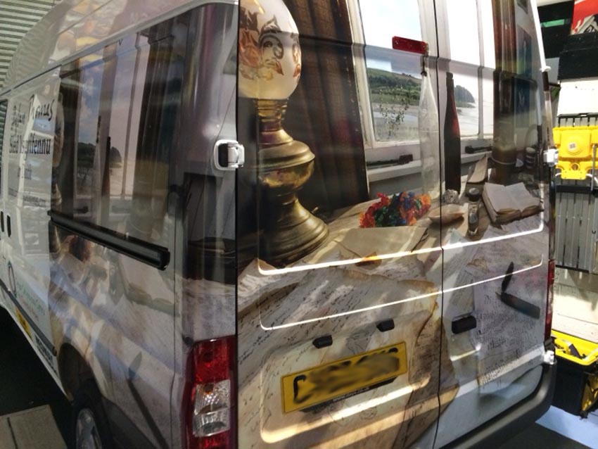

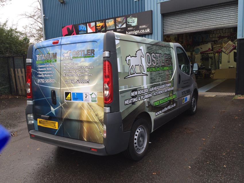

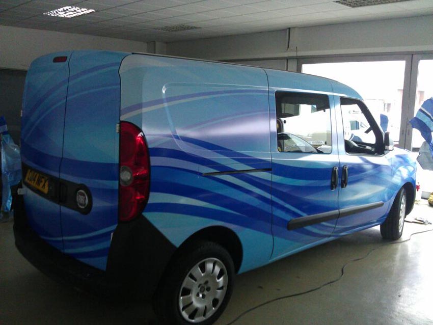

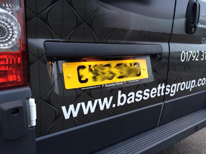

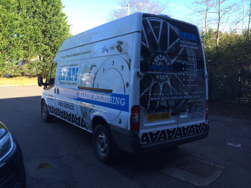

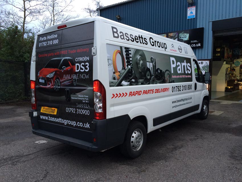

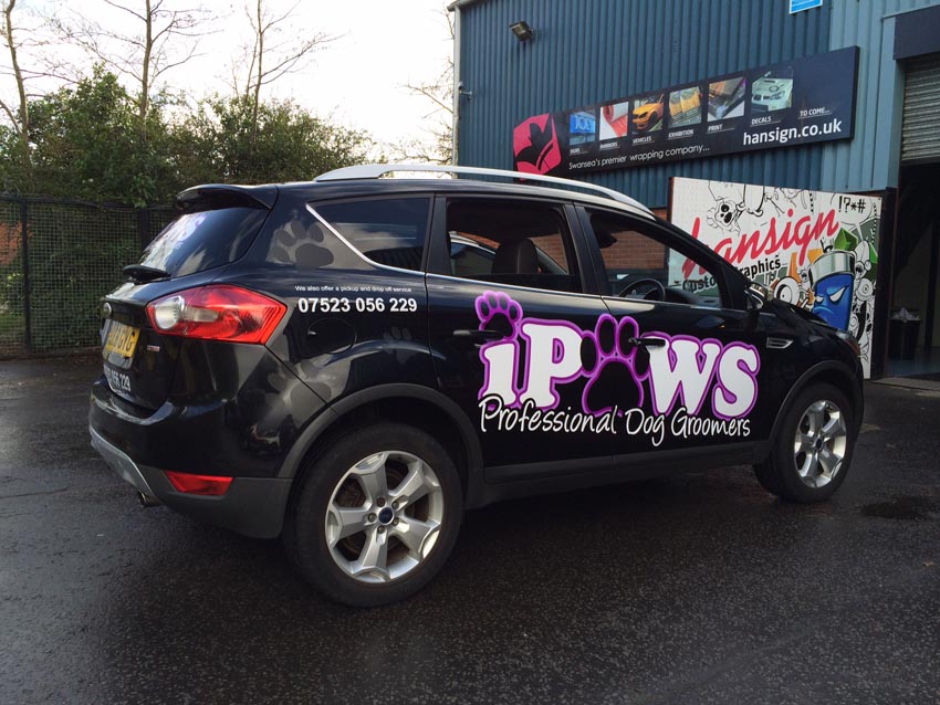

    Hey Guys, just thought id add a few pics from my experience with MDX.. Ive been using it for a little while now and its been performing aswell as the avery and 3m for its equivalent product. All fitted in correct conditions and post heated with rollers
    Id agree with Ben!
    Hats off to you mate one of those i wouldnt of attempted with mdx
    I have used the material on site in harsh conditions after applying the correct way I have no complaints, still wouldnt use it for a full wrap on a sprinter or something, dont have enough confidence in it yet
