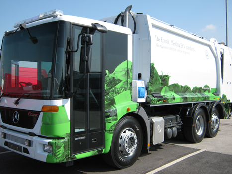

    I’ve quoted the job on using 3M IJ170Cv3 there’s only one recess over the wheel arch and apart from that its all flat surface,

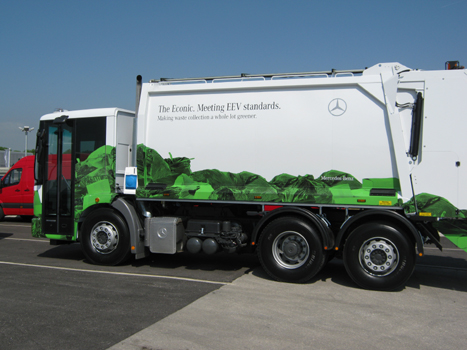

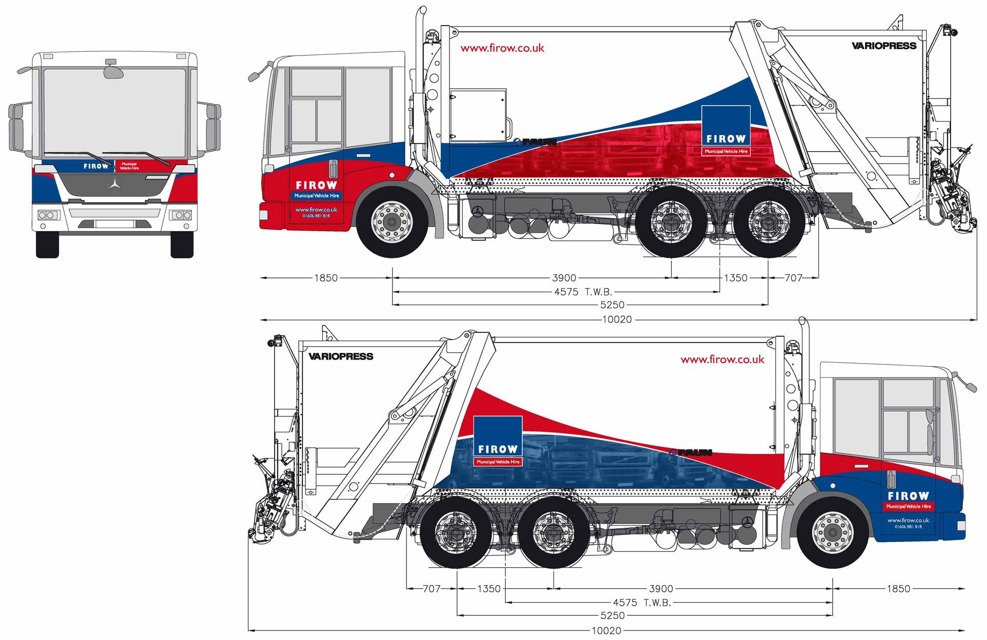

    I Haven’t finished the design yet and its going to be a mix of the 2 pics.
    my questions are:
    1. Is there a cheaper or better option for the vinyl?
    2. Is there anything standing out that you wouldn’t do on this (my biggest job yet and I don’t want to muck it up)
    Any advise would be really appreciated
    Cheers in advance
    Robert

    The design, have you seen one ‘in the flesh’? I’d really recommend looking, the ‘step’ on the bottom of the body is surprisingly deep. (See pics) We printed from the clients supplied design. If you lined the top of the image as his visual it wouldn’t stretch to cover the bottom. Line up with the bottom (our solution) it didn’t reach far enough up the body.
    Fitting not too difficult, but there are quite a few controls/pipes and safety stickers they never show you on the outlines which take time! The welds on the ones we did were quite large and took time to mold and were a bugger for trapping air pockets. Recess on the cab is deep and some kind of plastic, 1st couple popped straight back out so we roughed up the surface to give a better key. Used MD7.

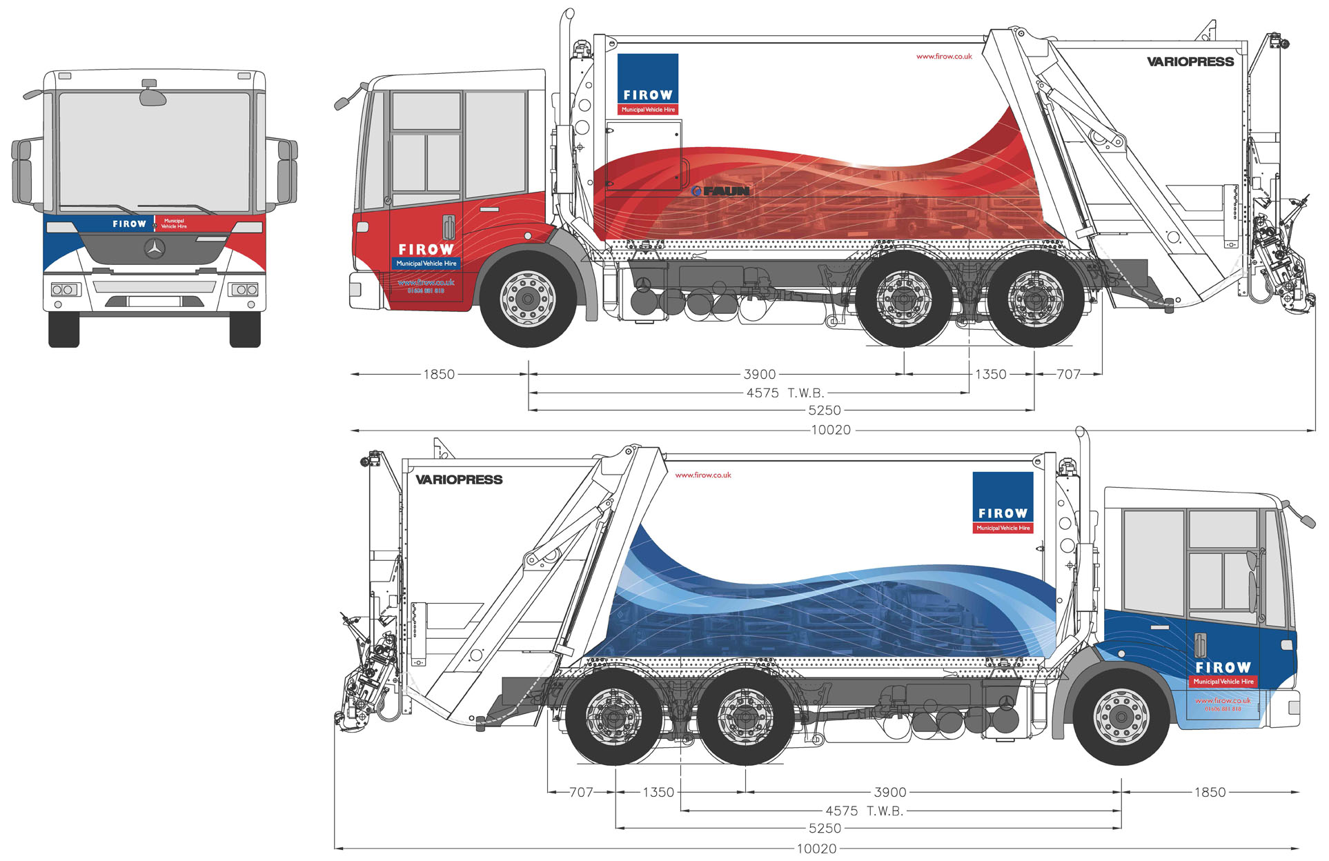

    Just had an email this morning and the owner wants a full redisgn (hot)

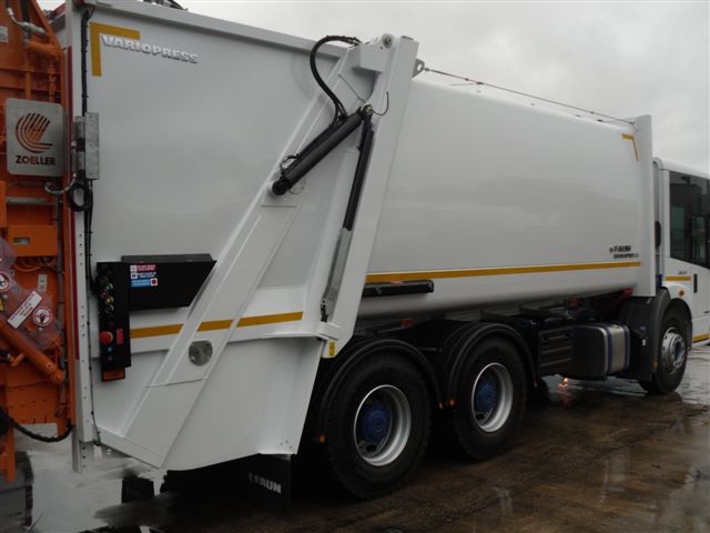

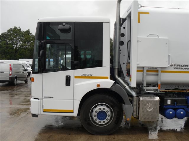

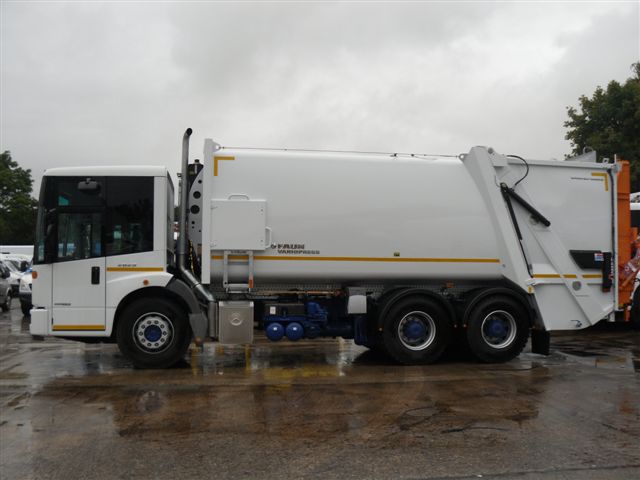

    Just got these pics trough from Faun
    the chapte 8 livery isnt on the ones i’m doing but are
    suppose to be identical to these
