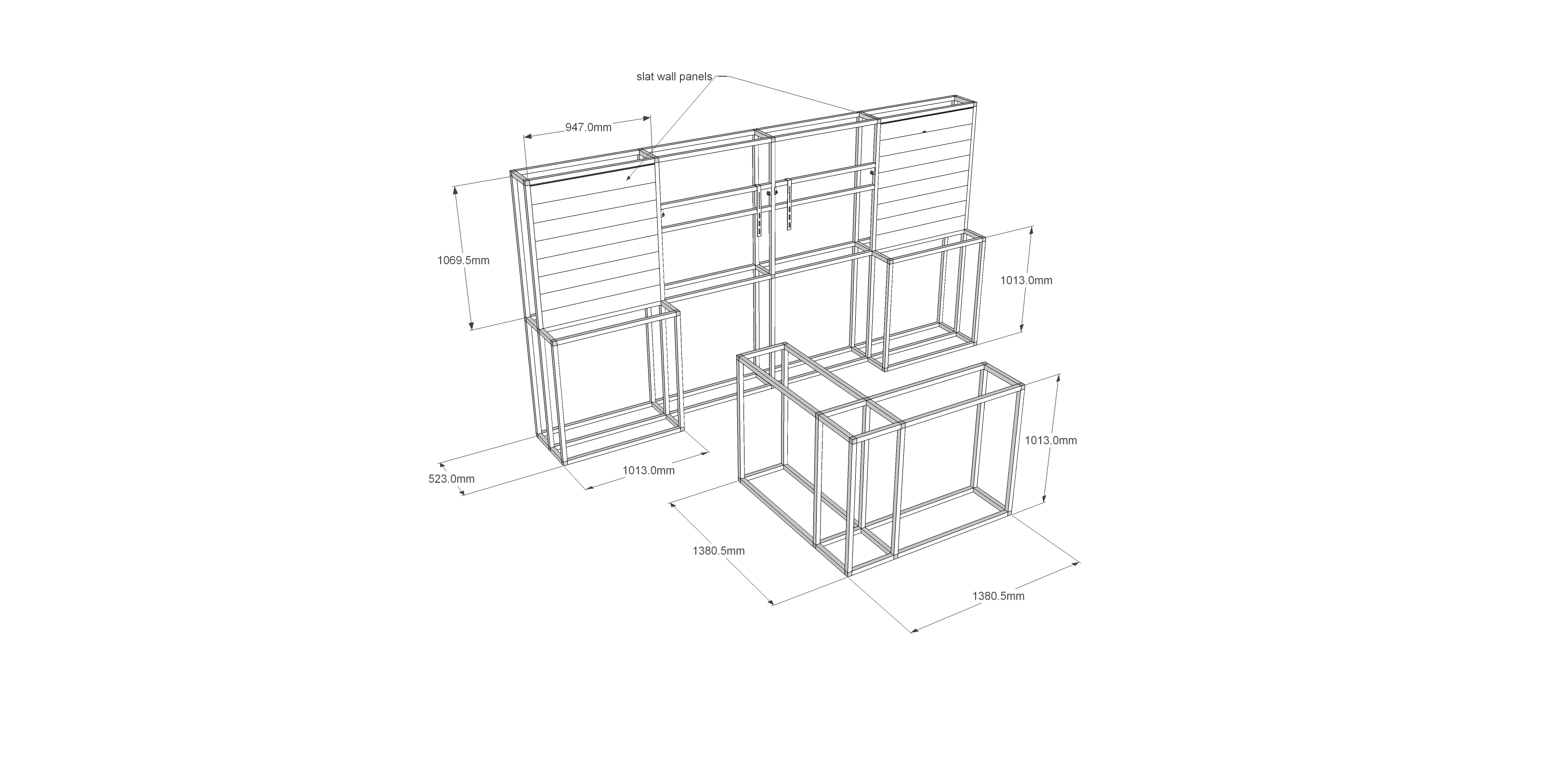

    Hi All,
    I need to fit panels to a framework like attached, they are to have magnetic strips fitted to the the back of the panels. Suppliers who have provided the framework can’t recommend a specific media or supplier, but have said it needs to be a semi rigid PVC, 450 micron + laminate to make a total of 600 micron thick.
    Have contacted our usual suppliers but not had much joy so far, does anyone have any recommendations for a material or supplier to contact?
