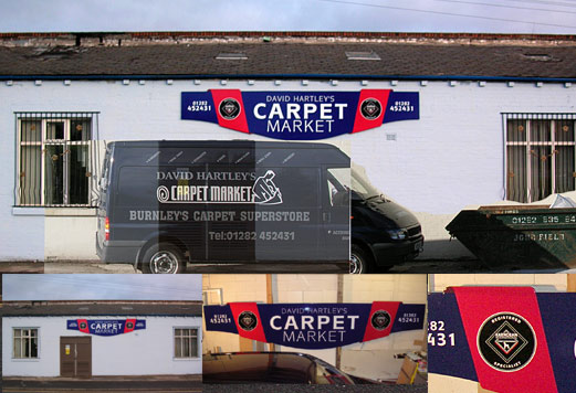

    This is the largest of 5 signs I’m doing for this customer on Exterior MDF.
    The building is long and as he has just opened up a Karndean flooring showroom he wanted a more up market look (with a little encouragement).
    This sign is approx 16ft by 3.5ft 3/4inch(fuzzy on detail) thick. Ali wood primer, undercoat and 2 coats of weathershield gloss. Cut to shape and rounded over by a neighbour (saved buying equipment 😉 and risk of botching it up). Mounted on split batons.
    I have to say it was a monster in the workshop and seemed to shrink a little in place, until I recalled all the vehicles that get parked up in front of the building.
    Cheers, Pete

    Oh yeah, forgot to say he loved it and that I’m quite pleased with it myself, although I would approach it differently next time.

    Looks really smart, can you give me a git of advice, seeing as you have just done this.
    Exterior grade MDF, is that what you ask for at the timber merchants or is it known by another name ? I asked a similar question recently regarding “A” boards, Steve Broughton called it Medite but the guy I asked at the timber yard said he had not heard of it.
    Bob 😮
  • magpie
    8 December 2004 at 13:03
    Hi Bob, yep its the same as Steve uses. I had a time of it finding a supplier who knew what I was after, but got there eventually. Persevere is all I can suggest.

    8 December 2004 at 20:19
    great work mate, you did well… big signs like that are never easy to fit.
    the finish looks good and i realise why you have used medite. thickness & price?
    i di a sign with a bit of shape to it like that last christmas, big thing it was and not the easiest to fit. alternatively i used 19mm gloss faced foamex, i found it jigsawed excellent and helped me heaps when it came to fitting because it was light. for colouring you just cover it with some vinyl, very quick and easy.

    Rob I have since thought about how I’d approach this kind of job again in the future and I’m sure there’ll be some instance where I opt for your solution. Although ideally I’d like Aluboard etc. cut to shape but need to find someone in the northwest with the equipment and will to rout 8by4 sheets at a fair price.

    When you say Aluboard, what are you meaning? Like Dibond or?? Just a thought, but the vast majority of materials can be cut using a plain ordinary jigsaw and although it takes extra time up, its a realistic solution if you don’t have access to some of the bigger machinery. Or are you meaning to round the edges off on material? Again, could you not use a hand-held router? You can borrow mine for a pint! :lol1:
