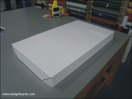

I have attempted to make a pan sign in the past and as much as it was straightforward to do, it didn’t work out just as i would have liked. I had two problems that i hope with some advice, i will get right next week when i attempt it again.
I found two problems.
Problem 1

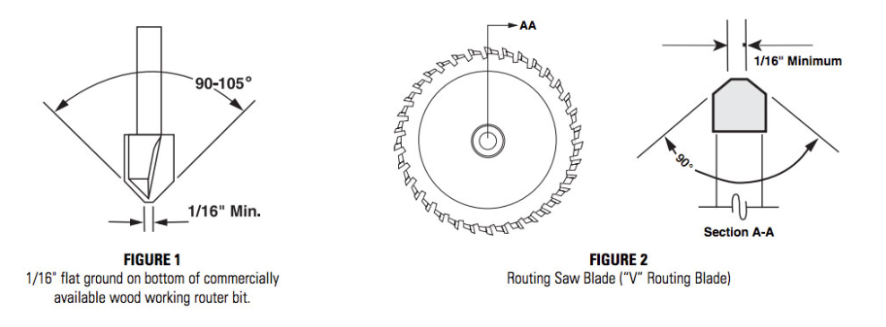

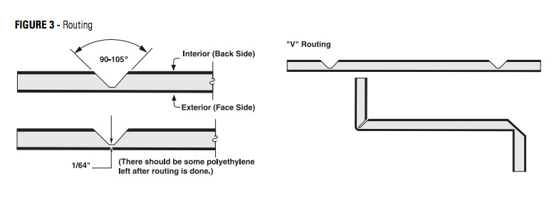

I used a v-shape groove router bit on the rear of my composite board, to create the fold.
This was fine and i completed the fold lines. but when i made the fold, the fold/flap would not sit at an exact 90 degree angle. it was tight to fold and kept opening back up.
I did cut deep enough and in areas i was showing a little bit silver from the opposite side metal face. but still it was hard to fold.Problem 2

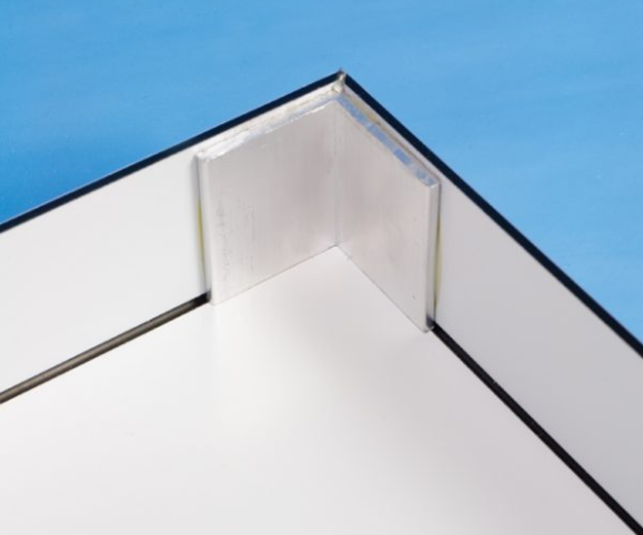

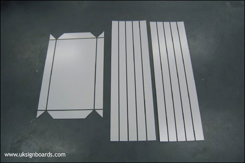

I cut the corners out and when i folded the sides. they looked fine, but did not look as neat as i see some.
There appears to be a sort of cut and fold for the corners. How do i make these corners, is there a sort of jig-method for doing them?Thanks in advance for any help you can give on this.
