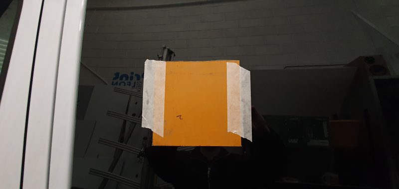

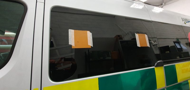

    Sorry, the titles a bit deceiving but I’d like to share a quick tip we’ve started using. We apply graphics to a ton of ambulances and have been so used to using magnets on vehicles it’s rather frustrating not being able to stick them to the windows. The solution came in the form of a couple of piece of mild steel stuck to the glass with thick masking tape. This allows me to hold the graphics in place, and then slide them about to get them aligned properly. Now that the concept works, I’ll buy a couple of pieces around 200mm x 200mm on ebay, apply some thick laminate to them to prevent scratches, and add them to the arsenal of tools we have. Going to save a bit of time going forward. Were working our way through a fleet of 26 ambulances at the moment.

      Cheers Robert, appreciate your help. I’ll probably get a couple of those Gecko Patches ordered as we do lots of ambulances. The metal plates were simply a test to see how they faired out. Have never used the proper Gecko Patches to see how the magnets stick but the metal plates work brilliantly. Going forward if I did stick with them I’d get a couple cut in a place that works with steel across the road from me and laminate both sides with the likes of a motocross laminate bringing it about 10mm past the edges so the plates were completely encapsulated to prevent any scratches

      You’d think that Karen but we’ve done the graphics now on 50 or 60 ambulances and I can assure you this technique wins hands down. The problem is that the main graphic is around 4ft wide. When you 1st put it in place you never get it centered properly and have to move it about. Having it attached by magnetics allows you to slide it up, down, side to side at your leisure. If you’ve it taped on with masking tape it means the graphic is constantly falling off the window while your trying to move it / hold it in position with your elbow while it gets repositioned. It comes from doing cars & vans constantly where magnets are saviour.

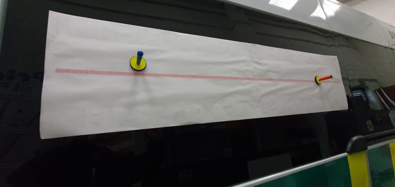

    Have a look at my video:
    https://youtu.be/ouGKddPxGI8?si=piDhJqQaGDW2KtrZ
    I tear the backing paper and use the application tape to stick to background.

      nice video. we do something similar but masking tape it first then fold the paper back to make the hinge and apply it.
