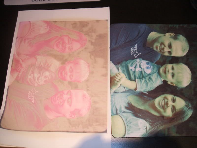

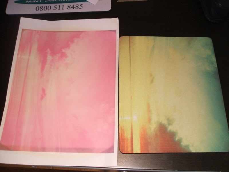

    Printer is fine and all test prints are perfect but when I try press a photograph on to a mouse mat it seems to leave all the magenta ink on the paper, all other colours transfer well except there is no mag on the mat and the picture left on the paper is very pink.
    I’ve increased temp, pressure and time and has improved ever so slightly but only about 10% of the magenta looks transferred 😕
    any idea? All other prints (the few I’ve done printed fine, only seems like photographs 👿

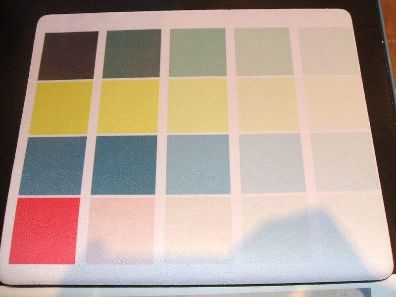

  • Warren Beard
    31 October 2008 at 20:59
    right here’s my problem
    I still have to try many many things as I know how many variables there can be but this just seems really strange and should not be happening at all.
    see how the magenta stays on the paper and is missing from the picture
    These are cmyk squares starting from 100%, 75%, 50%, 25%, 10%, see how the black goes green and the magenta is lost after the 100%
    any suggestions to help me in the right direction?

    the magenta is printing so there is no blockages or anything, it is not pressing on to the products and is being left behind on the paper as you can see in the pictures above.
    All ink is original ink from supplier so if there is any problem then it is their fault, I might dump the ink that is in it and put in the spare ink I bought from them, if that still does not work then replace all the ink for a recommended brand.
