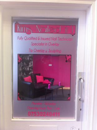

    hi Olly,some nice jobs there,i think kims and morays are really good 😀
  • Olly MacDonald
    10 March 2013 at 13:00

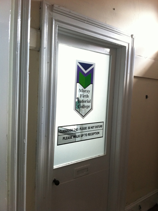

    Cheers John , the moray job was really nice to work on ,i did there 3 front windows too, all with frosted back and lights fitted .Kims work im really happy with and got
    lots of work through it .

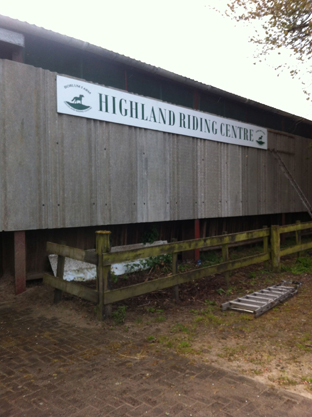

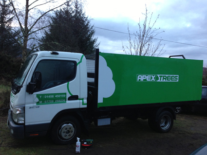

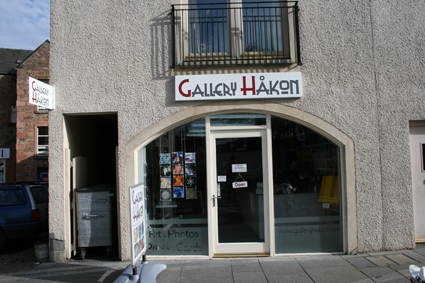

    Some good stuff there. Like the etched college door, gallery & apex especially.

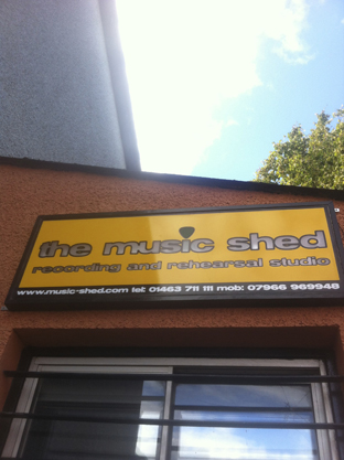

    One wee point though about the layouts, little things like margins can make a big difference to the balance. Such general rules as the side margins should not be smaller than the space between the words and top / bottom margin not less than the space between lines as it makes it look like the text is too big for the panel.
    (Khans and music shed to a lesser extent.)
  • Olly MacDonald
    10 March 2013 at 21:36
    Cheers Dave , advice noted and taken onboard . its definalty the wee tricks of
    trade that help big picture

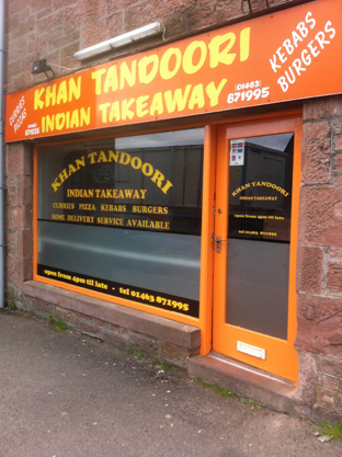

    hi olly. on the tandoori shop front ,the bottom line with the phone number in the black and orange is it inside or outside, just the photos at an angle.john 🙂
  • Olly MacDonald
    11 March 2013 at 19:39
    the bottom layer is fitted from outside, it was designed to hide the back of the bench on inside , which you could see from front ..if that makes sense
