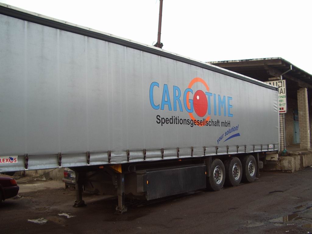

    is that ink or vinyl mate? if vinyl, what type did you use & how did you think it performed?
    thank you for taking the time to post your work. 😀

    hi, its vinyl oracal for baner, 561
    very easy for use and fast, its take 8h,

    Thats a big trailer …… nice job, thanks for showing us.
    I thought when it comes to curtain trailers though, a specific type of vinyl should be used?

    quote mindaugas:
    Can you post us another picture of it in a couple of months?

    banner vinyls fine till they start opening and closing the curtains!!! which of course they will do from day one!! get the cheque quick 😮 😮

    yeh.hmm i always thought the theres banner vinyl….and theres curtain side vinyl …I think it was you rob that made an expensive mistake by using the wrong one .A post i remmeber and took onboard 😕 Thanks

    thanks for comment,
    yes, can ha pen everything, bud vinyl i use not first time, and its work, with vinyl i have experiment two year ago and till now
    its still work,
    before put vinyl need made big job and after also, just you mast know how
    do that job.
    its must work for max three
