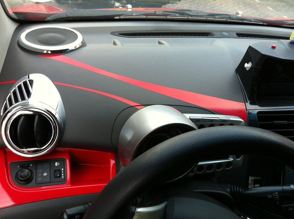

    Hi Tracey. Can’t work out how to send to you directly, but have attached the pics that the cust has given me of someone else’s car. It’s key that I get them the right size and shape so that they stick on the smooth parts if the dash.

    Forgive me if I’m missing something hugely obvious here but could they not be done by making a template in apllication tape or wide masking tape? Run it between the two end points and then either draw a shape onto it or mark measurements on it and then carefully take it off lay it flat and photograph it, scale photo up in Corel and make the curves and cut.
    Sounds complicated but very easy to do.

    Hi Harry. The issue I had was not having access to the car to make up a template like that, but have now arranged for Customer to bring vehicle through and let me have some time to do this. I’ll post the results when all done. He’s not available for another few weeks though!
