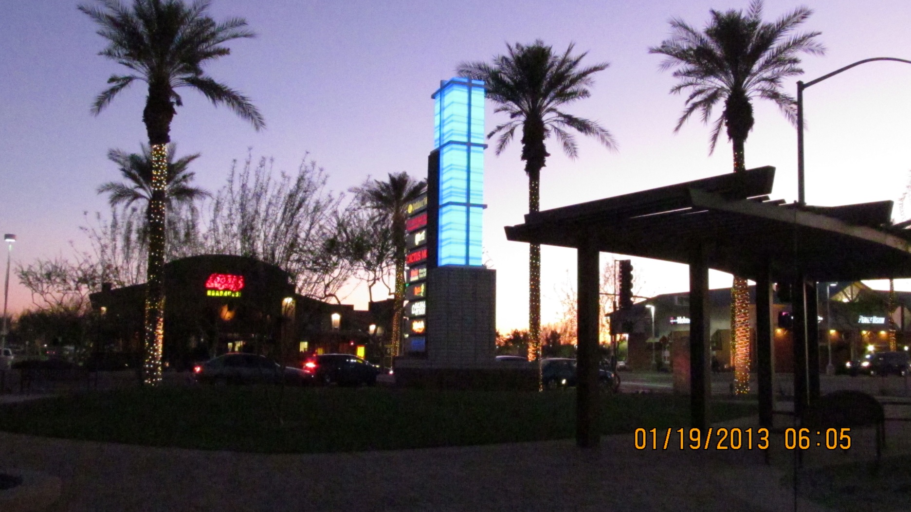

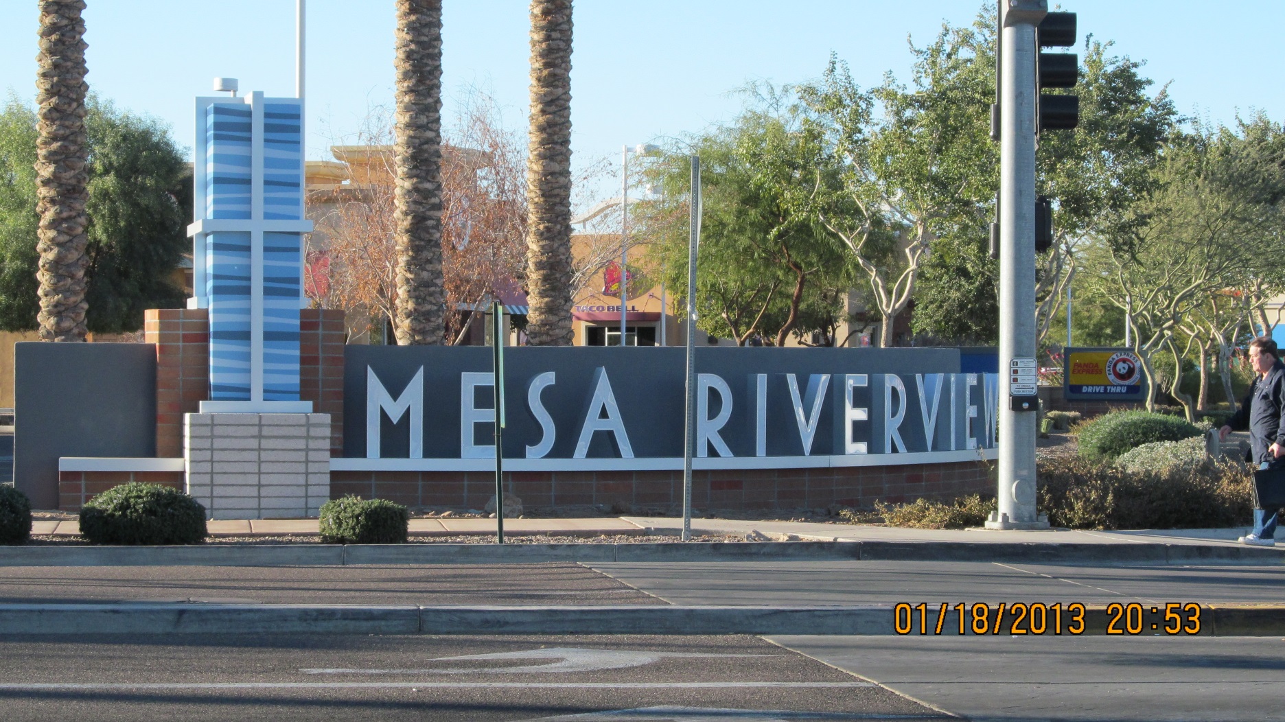

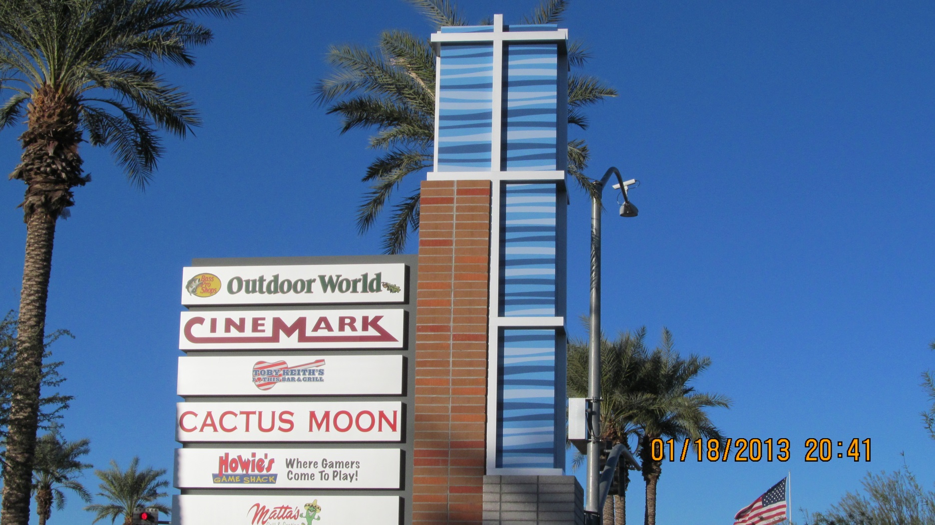

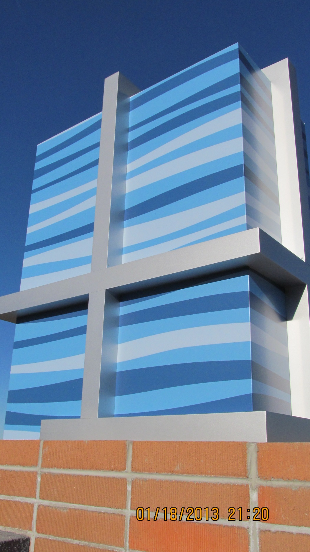

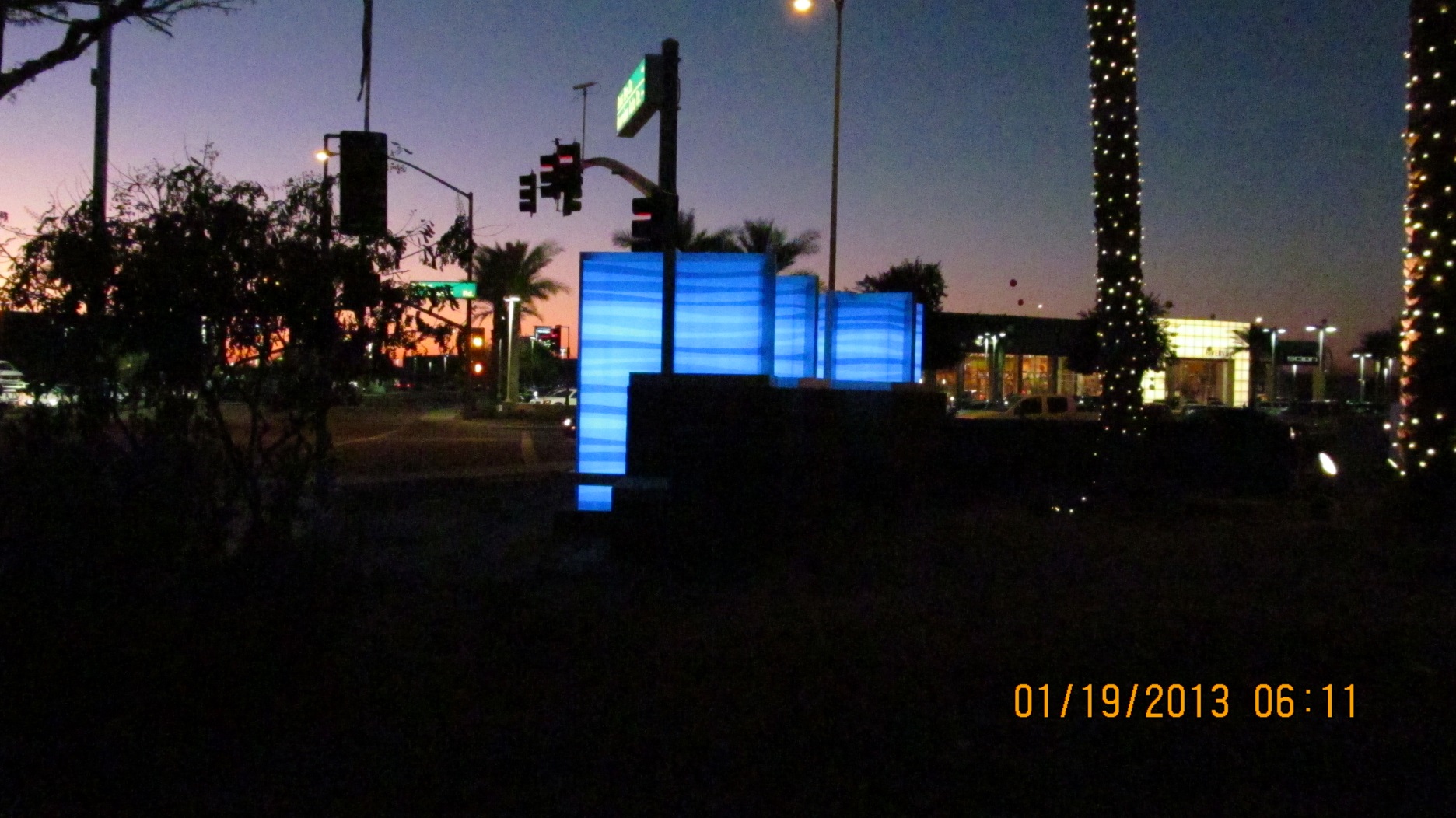

    These are lightboxes we made to go with the Mesa Riverview Mall sign project. I made the frames for the lightboxes, and assembled them. They were made with 4" aluminium square tube, 1/2" perspex panels covered in digital print. The lighting were standard T12 fluorescents with blue sleeves.
    We also made the entrance channel letter signs and radius raceways.
