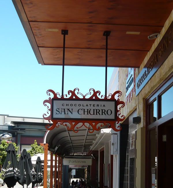

  • Lee Attewell
    4 November 2009 at 02:47
    Just had another thought. This is one fitted like Warren advised. We couldn’t get above the wooden panels as above this shop front there was a balcony for an apartment and it was tiled.
    I got the legs made with the brackets fixed at the top but moveable at the bottom. I did this so I could adjust the drop of the sign so it was level.
