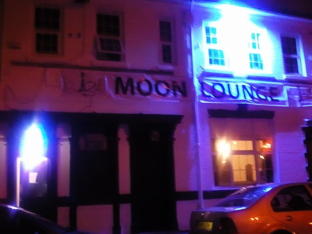

Hi Guys
I have attached the image to give you a better idea. I have spoken to my lightbox supplier and he has said that to make 2 lightboxes up with the pipe in between and join the perspex to make it look as one big sign. Note that the banner will be replaced with the lightbox and the bracket also lies there.
[/right] -
Can’t quite tell from the picture but it looks like it may be a stink pipe.
Purely to vent the drains above the gutter.
You Client is probably set in his ways and wants a lightbox but looking at the place wouldn’t something classier look better. e.g Letters on standoffs with spot or strip lights? The pipe being painted the same colour as the wall hides it a bit, and space the wording so the pipe is in a space?
I would agree with David. I think they’re horrible things.

could you change from a light-box to a fret cut tray with just the graphics illuminated, the tray could fit over the pipe and not have to worry about a dark spot
this is the way I would do this and Illuminated Trays in my opinion look nicer than light-boxes
Patrick
I’m beginning to think that built up letters would be a good idea. With the tray would it not still be the same issue?? how would that work exactly? do you have a pic patrick??
Patrick I’m assuming you mean to cut like a half moon in the tray to accomodate for the pipe. But would that not mean that water could get in to the electrics? I have spoken to the customer today and he said that as long as it lights up then its fine!
Please advise

Could be looking at a simple frame to stand a slimline box away from the wall.
Word of warning about altering supplied boxes. The manufacturer will supply to a given IP rating and if you start cutting holes you will probably invalidate any warranty given 😮
Hi Graeme,
pic on page 3. So your saying add a frame to literally extend away from the pipe and then use a lightbox or fret cut tray?? Personally I am inclining towards fret cut panel work with lit letters or stand off letters with haylow effect. thats probably going to be the best way.
