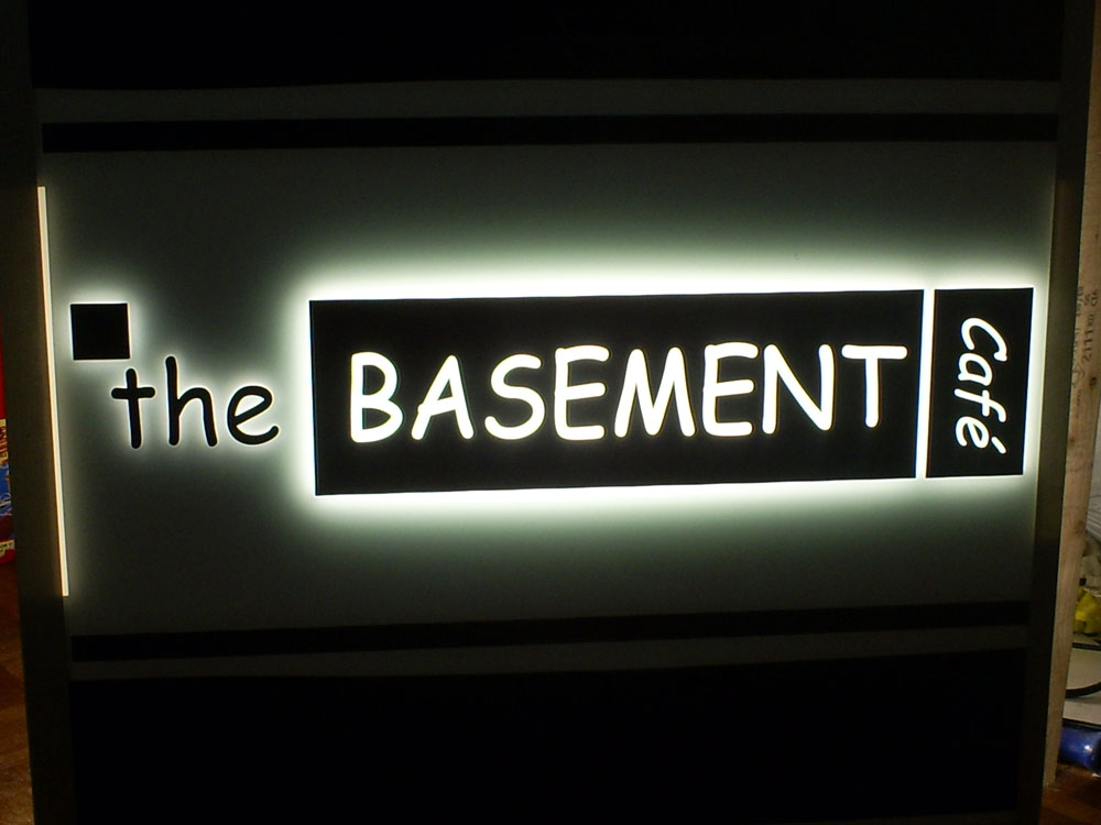

    Hi All.

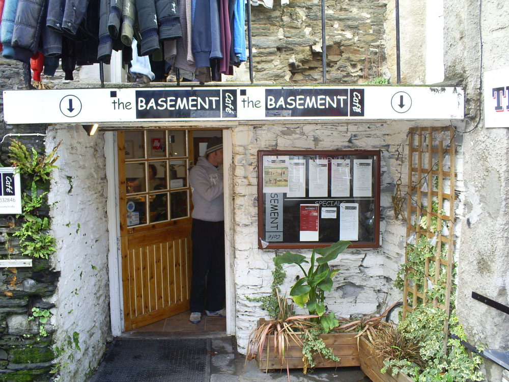

    Got a cafe fascia sign to do. The photo below shows the old fascia, and the new fascia I want to do using Andy’s halo idea with a lightbox, I have done a test with, pretty cool :lol1: . Question is, I wanted to use Tranislim from Universal for the frame which has a small return of 50mm. Problem is, they can’t do the length I need coz it’s too long(2740mm x 230mm), they can only do one with a return of 90mm. I didn’t really want something this big as I didn’t think it would look classy enough.

    Would it work using panatrim and clear acrylic and then putting LEDs behind, sort of home made light box?
    Thanks for help.
