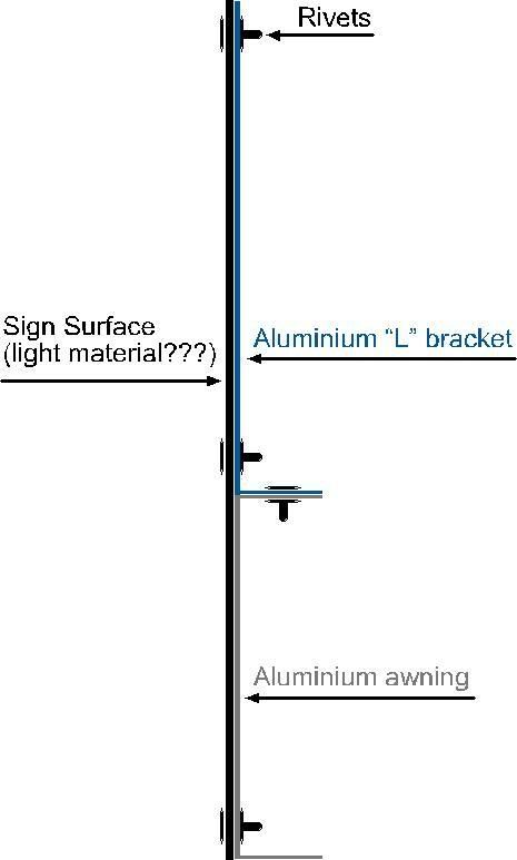

    Here is a quick diagram I did to show how I would fix it
    I think it will work OK and if I use enough rivets it should hold OK.
    I will cover the rivets with vinyl so you cannot see them on the face (any tips welcome)
    Warren

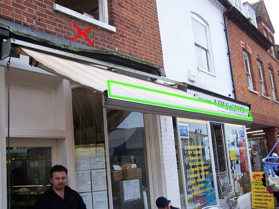

    Sorry I’ve been away, went to take pictures so I can show you what it looks like.
    You can see the slit where an extension to the canopy slides in, this makes me believe it has some strength, and when pulling on it it is also fairly stiff. The area with the red cross is where he wanted to put a sign but as it’s a grade 2 listed building they have rejected it. the green area is the area he wants it on the canopy.
    Any suggestions are welcome.

    sorry to go off on a tangent but is fitting to the top of the canopy box not an option…. you’d get a bigger sign there with a stronger fix

    Hi Glen, the top section is weaker than the bottom section. It also falls under the window ledge thingy part of the building that is just above the canopy.

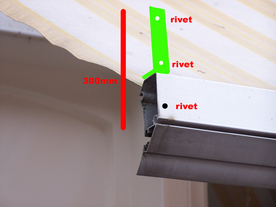

    You could use 2mm / 3mm dibond / reynobond if you keep the height to say no more than 300mm, but for a single 3m sheet you won’t get much change from £100. You say this guy is on a tight budget is there going to be enough left to make a profit. ( unless you can find a local sign company with some dibond off cuts ? )
    Where abouts are you ?
    I would have to advise the same as Jill though, the canopy looks like its on its last legs. .. can’t you try to sell him something else ?
