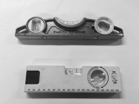

    I have a laser level but more often than not I use a spirit level with an adjustable bezzel, just find the angle that you like and turn dial and lock, don’t forget that the other side is the opposite so reset.
  • Daniel Evans
    9 April 2018 at 09:26
    Be good to see an image of that Peter? I also have a laser but I don’t tend to use it

    Transit Customs are about 30mm out from the top from left to right or vice versa so mark it from there and go down
  • Peter Cox
    9 April 2018 at 15:50
    Hi Daniel,
    I actually have a couple of them, one from a pound shop and a Fat Max one, I wouldn’t be without them.
  • Daniel Evans
    9 April 2018 at 16:00
    Thank Peter
    I visioned something a bit more high tech than that lol
