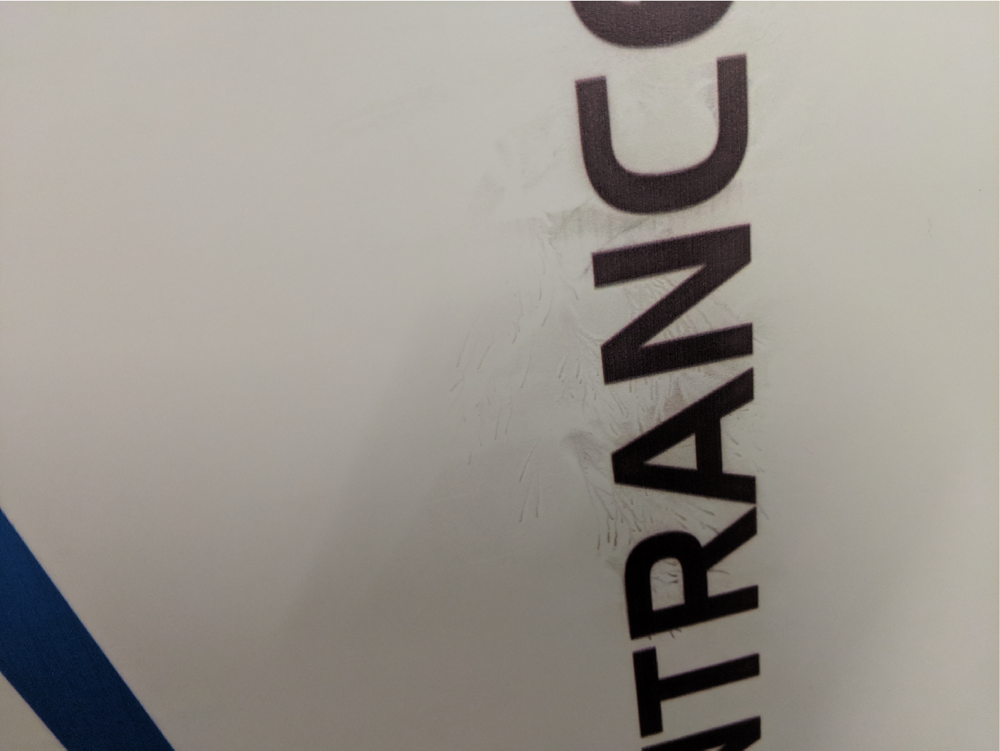

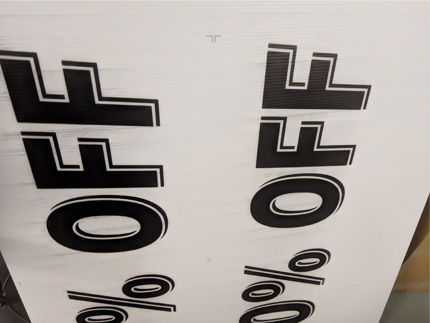

    Just been having some issues with the LEJ 640 hybrid, when it prints it creates some kind of shade over the prints, please see attachments.
    Any idea what could be the cause ?
    I have just went to the service mode and done all the alignments to the print head as it was a bit off, but the problem does not look like it is to do withe alignment of heads. ?

    Is this the first time you’ve printed on this substrate?
    Ive had this problem before Could be a couple of things, possibly static? or not an approved uv substrate.

    No I have printed on this earlier but same issue regardless of the substrate, In the image one is correx and one is foamex. Not had this issue before printing on both, but then I am novice in this machine, as I mainly used to operate just solvent before.

    Already did, cleaned it and all but this does not look like a strike on the media, I am more to do with the static charge and so on, this is something I am my head is around towards. Another problem is that its quite cold at the unit nothing close to the temp required on the printed and there is actually heater underneath the printer (where the temp sensor is) to cheat so a machine can be switched on but overal at the unit its probably around 15 C. But hence I think there is a fair of static charge build up, this "overspray/marks" as seen is quite far away from the print area, like it goes away even 4 cm away where the print should be done given in some trials. According to the manual static builds up more in cold conditions but then same conditions were for over last few months and not had and also had a heater underneath a printer to cheat/lie to the sensor so a machine can be used and run.

    I know where the issue is coming from for sure now. Thanks to Andy Kordowski for pointing me in the right direction, its a static charge that builds up as from the research I made it looks nearly the same as what I am gettting.

    It was not an issue with the head height, defo static, Yesterday I purchase from a local place a anti static bar, they had last one in stock mounted it above the media feed and it nearly fixed all the problem, Just tiny left but not the level that customers would complain. I will still give a fraser a call see the prices and may return the unit I purchased as I think its not too good or powerful but unless fraser is really expensive then I will stay with what I got as paid £900 for the unit I purchased.
