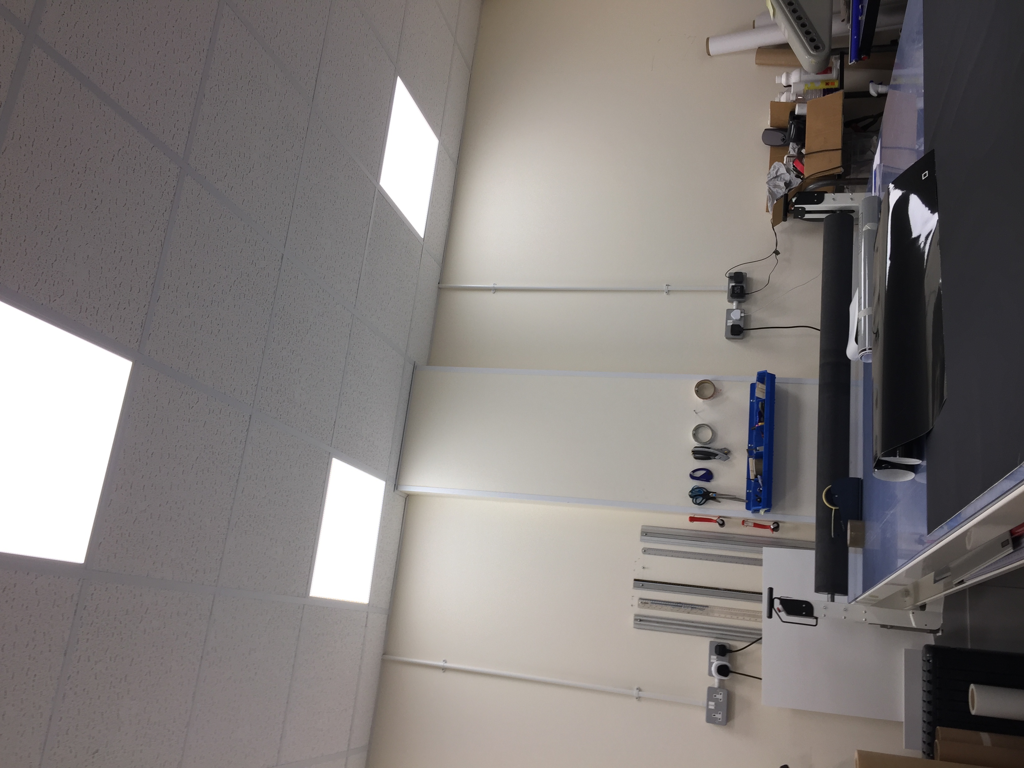

  • Jamie Wood
    10 July 2019 at 07:13
    We use LED panel type, with daylight bulbs, which are best for color matching.

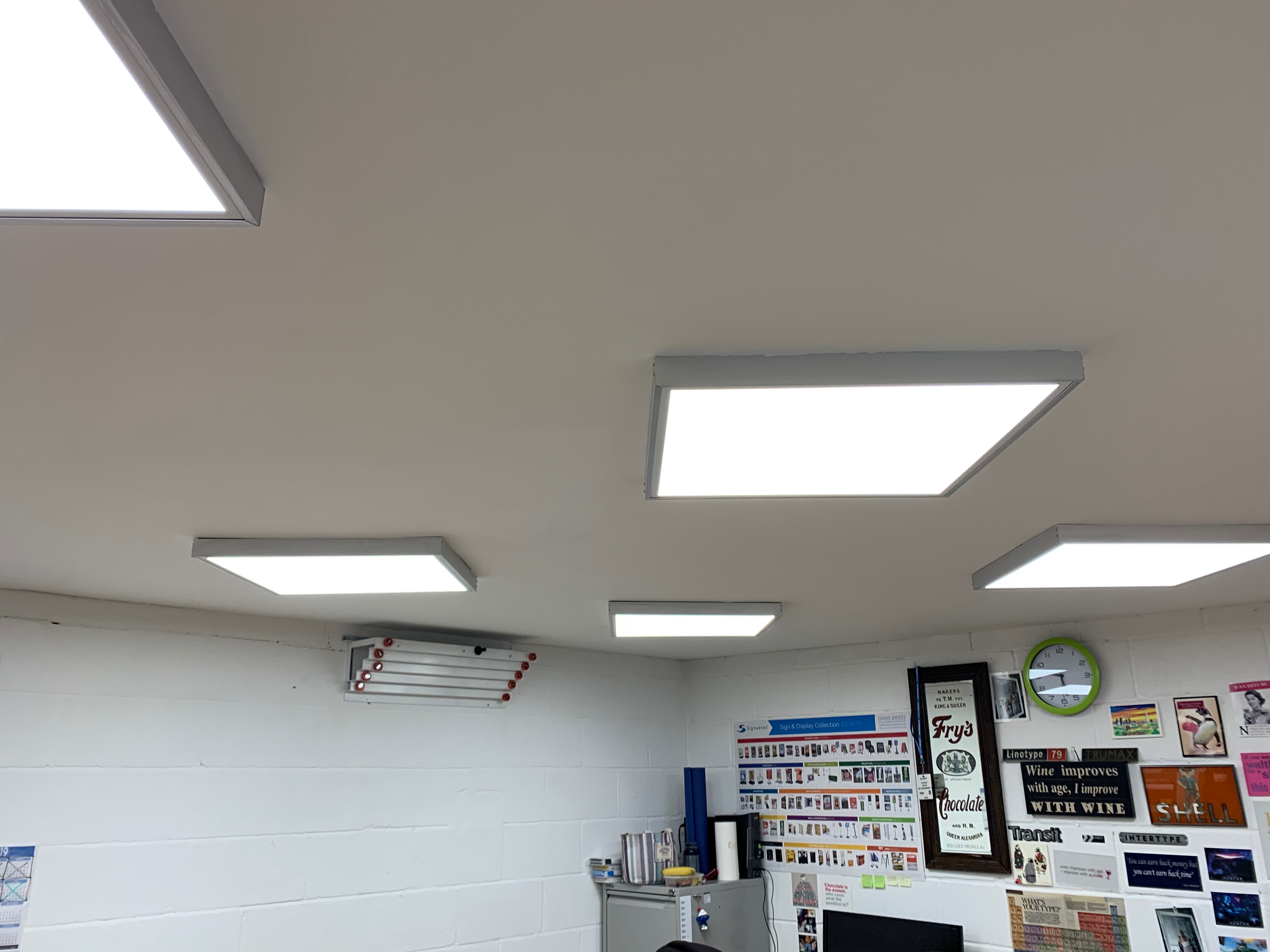

  • Jean Oakley
    10 July 2019 at 08:35
    I have six LED daylight lights in my office, they give great lighting when printing and cost pennies to run

  • Jean Oakley
    11 July 2019 at 09:43
    Hi Daniel, yes it is took many hours (mainly middle of the night) to work out what i wanted. I got a fabricator local to me to make it for me. I print almost daily but only small runs and its worked brilliantly. Few magnets to hold it and jobs a good un as they say. The lights im not sure of the spec i had the electrician get them for me.
