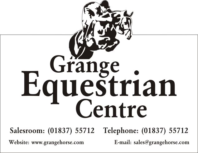

    Please may I call upon you all once more to lend a hand, this is quite an important job for me, whilst talking with the customer he actually said "no expense spared" this is a first for me and I would say quite rare to hear in most devonian towns!!! 😮
    Okay the request was as follows,
    Grange Equestrian Centre On a 5ft x 3ft board, with a horse Jumping over the Lettering, also the top of the horse sort of pertruding from the top of signboard. Also a couple of phone numbers at bottom of sign, he was a bit vague with this!, I should have asked him to clarified, but I was still in shock over the "no expense spared".
    Gong off the Layout part (sorry should be in a different forum but thought I’d keep it together). I suggested he used ryno-bond for the board, remembering it being mention a few times here. Ive never actually used anything else apart from plastic, so is jigsawing around the horse going to be a problem for me? Also he doesnt want screws through the sign, he wants runners stuck on the back like with road signs, I see that cherwells sell these, but they dont sell the 4 inch square post clips I will need. (the posts are already there for the existing sign).
    Think thats just about it, anyway heres my attempt, realy would love to hear any advice/critisms. This is completely new to me so Im sure any information would be very helpfull to me 😀 😀 😀
    Thank you
    Lawrence

  • evo1v
    27 May 2004 at 16:24
    Ohh forgot to mention, Customer specified that he wanted everything black on the white board, I know I hav’nt done this but I exported to a friends version of coral (to get the image enhanced) and could’nt work out how to alter colours 😀
    thanks again
    Lawrence
  • Brian Little
    27 May 2004 at 16:35
    I cant see any probs with that lawrence it looks great to me. I use dibond dont know if its the same stuff or not
    Regards brian
    PS might be a bit dif cutting tho with a jigsaw

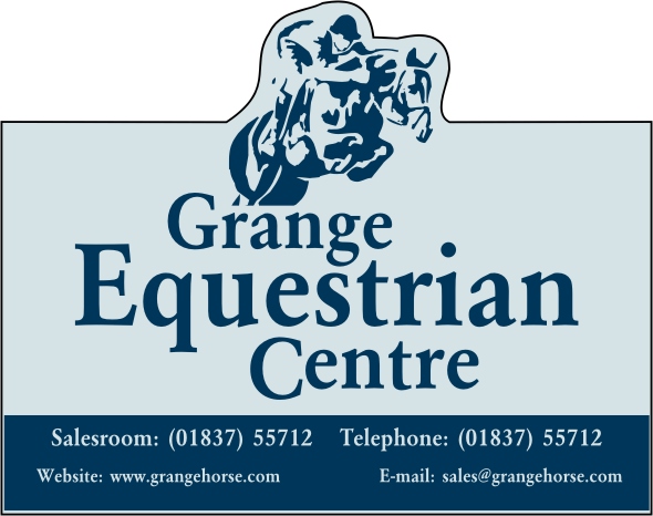

  • Bill Dewison
    27 May 2004 at 21:26
    Nice work Lawrence, looks the business 😀 Only con. cris. is I’d centre the entre to the c… try saying that after a litre of wine! 😉 I like the cut around at the top, it adds something a little extra to a sign imho, miles better than the boxy stuff I’m churning out atm 😀

  • evo1v
    27 May 2004 at 21:37
    I wasnt sure if by doing that Dewi, it would make the lower cases of centre look further away than those of grange, having now tryed it, I think your probably right, have a see 😀 😀
    Lawrence

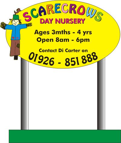

  • Nigel Fraser
    27 May 2004 at 21:41
    Hi Lawrence,
    As Carrie says, it’s much easier if you want channel on the sign to get Ashby to cut it and rivet the channel on for you. I would cut the sign blank a bit closer to the rider/horse like the one below as this looks better to me anyway ! I had one done today by them with a very similar style (Scarecrows) and it’s a really simple job to just apply the vinyl then go and bolt it on !!
    BTW cutting either dibond or reynobond is really easy with a jigsaw so no probs there if you decide to go that route. I expect that panel from ashby would cost approx £130 (only my estimate from experience) complete with channel and shaped top and white vinyl face.
    Nigel

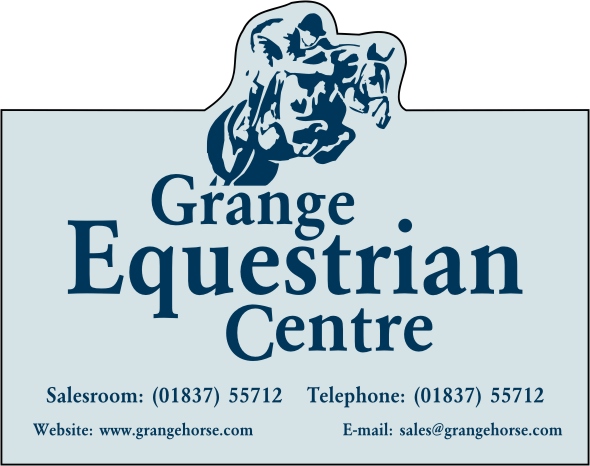

  • evo1v
    27 May 2004 at 21:45
    Thanks Carrie checking that now 😀
    Is this how you mean Jill? Is it neccassary to apply mouldings to the edges? ………..I know naa-ting 😀
    Lawrence

    27 May 2004 at 21:53
    Yup, Lawrence.
    But you need a bit of negative space around that box.
    And check the spacing on your letters in “equestrian”
    I always put this 10mm U-channel on the edges of Alumalite
    to finish it. It glues on with silicone & you trim it with a razor.
    I always cut myself & bleed all over the sign!
    Love…Jill

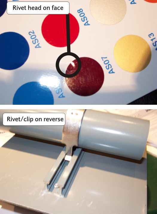

  • Nigel Fraser
    27 May 2004 at 21:54
    Ashby rivet them on but the heads are nearly invisible anyway when the vinyl is applied as they are countersunk into the face.
    You can use vhb tape but I personally would stick (pardon the pun 😉 ) with the rivets !
    Nigel

  • Nigel Fraser
    27 May 2004 at 22:01
    Heres a piccy of the rivet finish for you Lawrence…..
    Nigel
  • evo1v
    27 May 2004 at 22:04
    Wow thats hardly noticeable, Is there a specific aluminium thinkness you would use?
    Lawrence
  • Nigel Fraser
    27 May 2004 at 22:09
    It’s normally 3mm Lawrence….thats std for Ashby anyway.
    Nigel

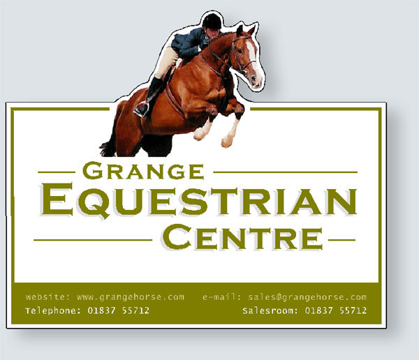

    27 May 2004 at 23:46
    just another option mate.. had a mess about while having a wee drink 😉
    if you use rynabond, you can easily cut with a jigsaw. cuts like butter with a metal cutting blade. get them in b&q cheap as chips..
    as for cutting it.. well.. if you apply it all.. then cover the lot in application tape. take a ball point pen and find the ridge of the vinyl thru the application tape and draw around it all.. this way you see where you jigsaw easier. once cut.. remove the applictaion tape. you will see the app tape has protected the sign face will jigsawing 😉
    for the channel bars on rear.. you could just use VHB tape and it will hold it just as good and NO visable fixings at all… 🙄
