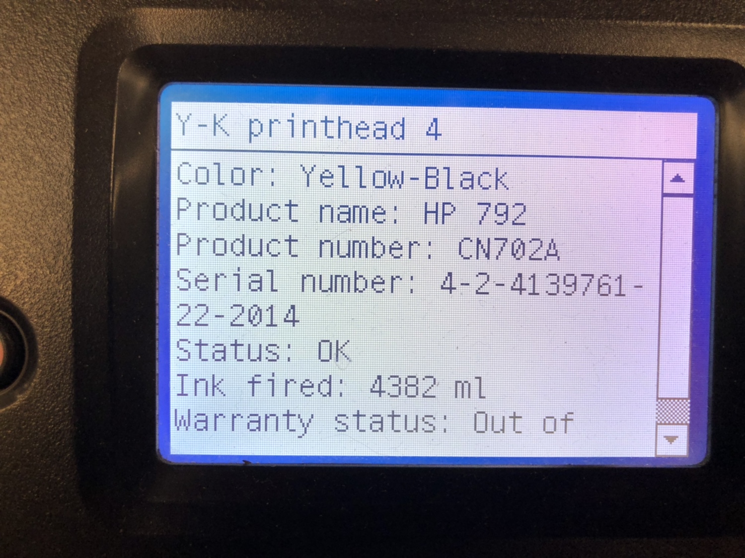

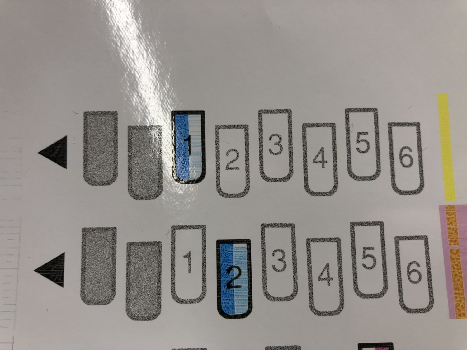

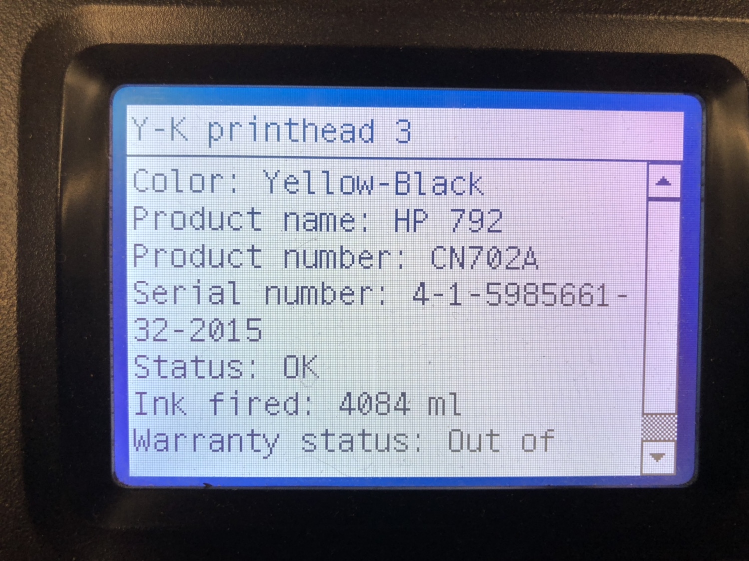

    Hi all,

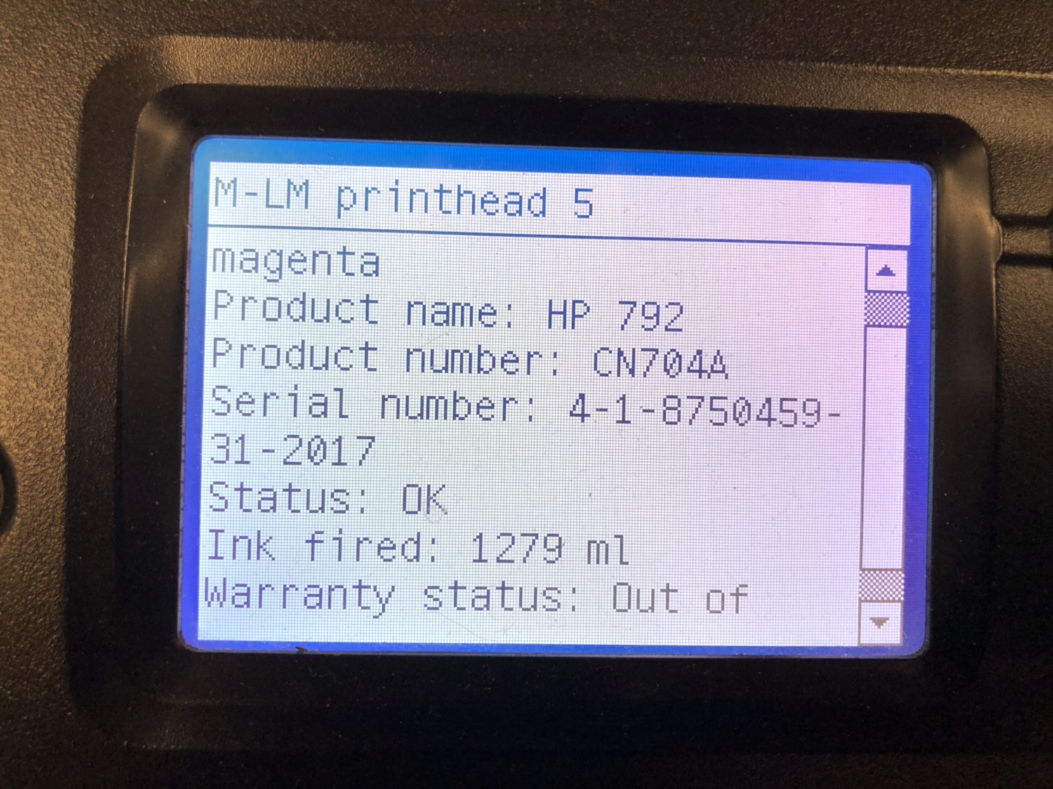

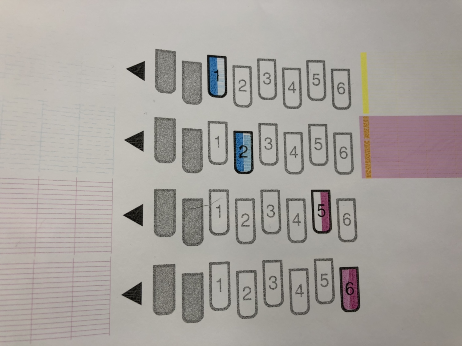

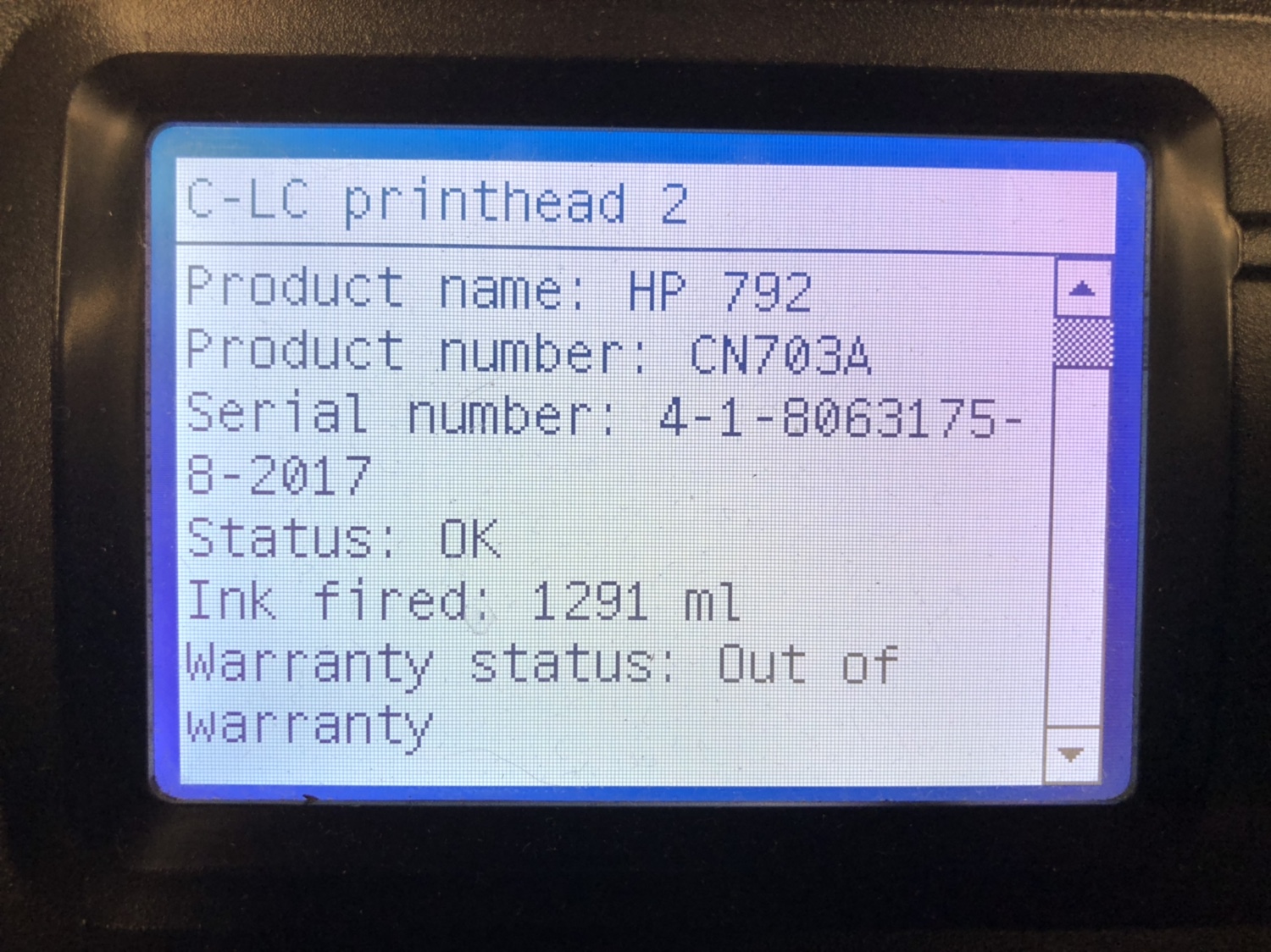

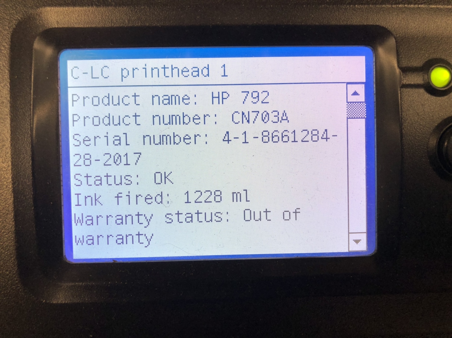

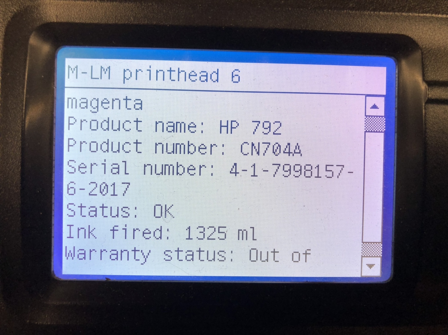

    Couple of issues on the print quality, especially grey and now some banding in magenta.
    Looking at the following I need to replace heads 1 & 5,m for sure. Poss No.2,
    May change 3&4 too, as waaaaay out of warranty, was thinking they’re upsetting the grey but now I think it might well be the 1&5!!

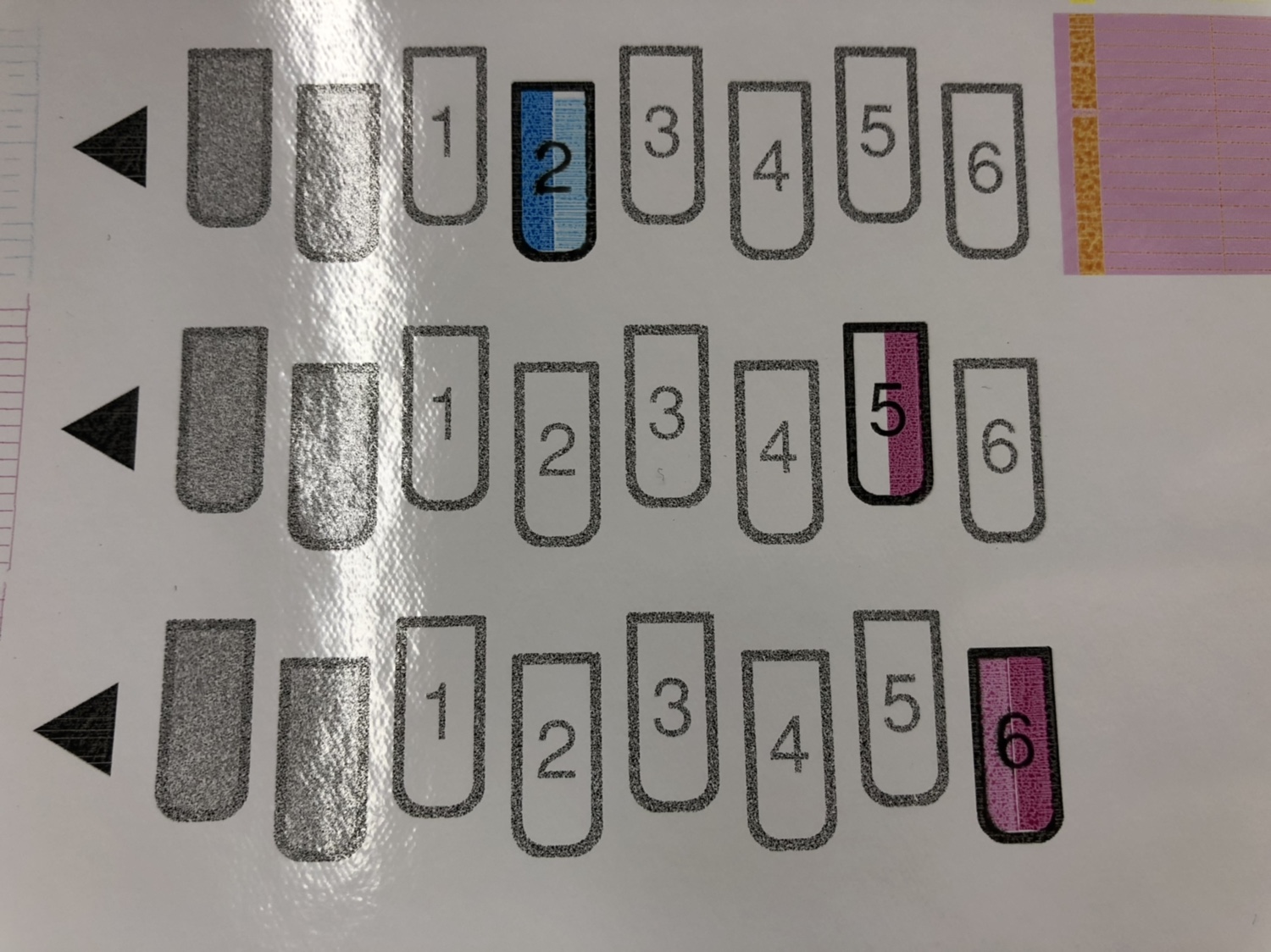

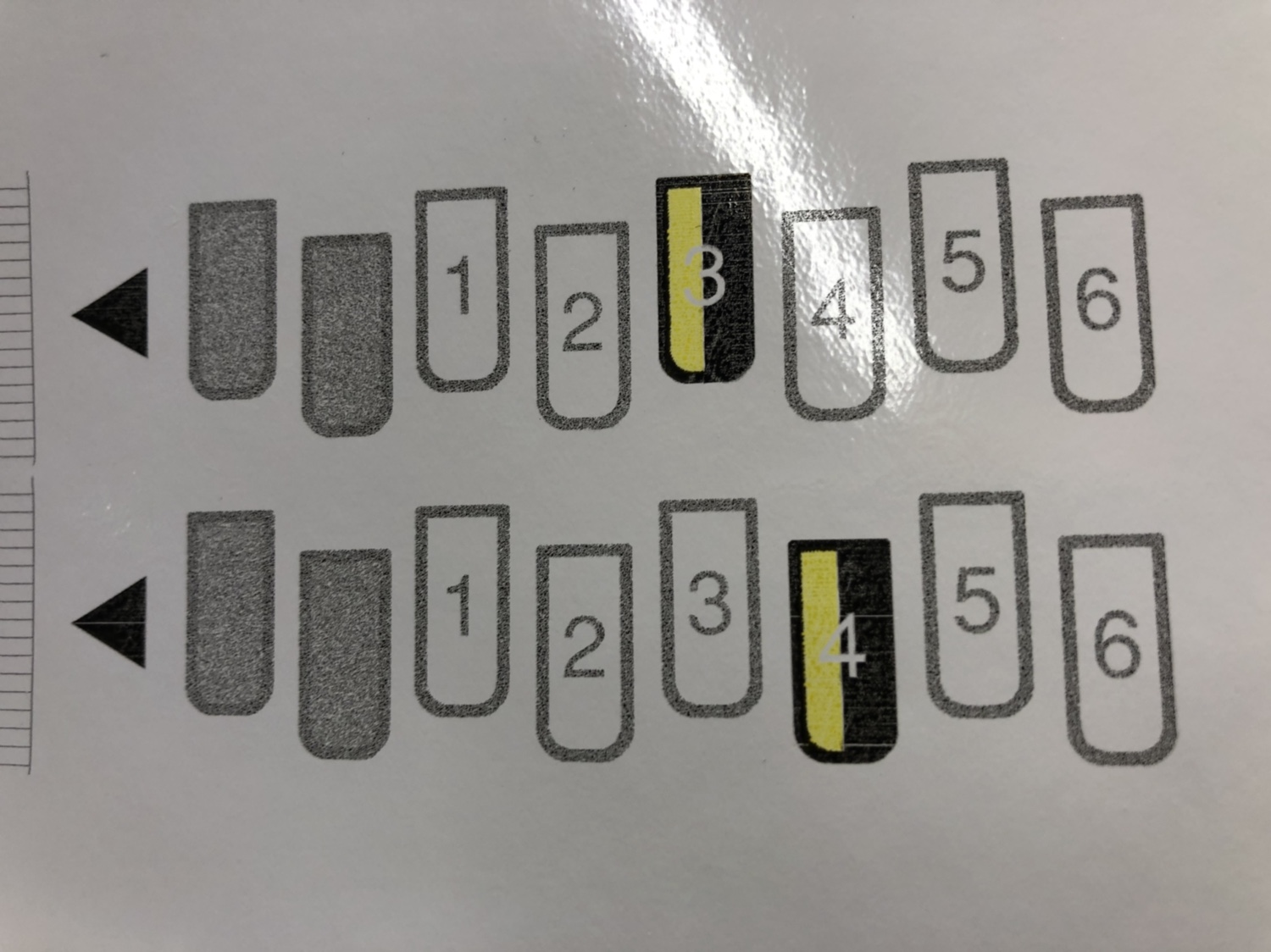

    Should the blocks of colour showing head position be solid? They look a bit grainy but the printed grids are fine – excluding the obvious .

    Presume you’ve done a head clean cycle or 2? I usually find they come back with a couple of cleans. Those blocks are never a great measure of print quality but the bits to the left that show how many of the holes are working is a better guide I find & a clean usually brings most back to working order even after warranty is out.
    The Y/B heads seem to go on forever, I have one at 4500 & the other at 5500 & never an issue with either. My main issue has always been the light inks in 1,2,5 & 6 but particularly 1 & 2 where they just stop completely rather than just deteriorate gradually. Looks like your No. 5 has done just that??
    Kevin Busby was on recently & thinks it’s down to something in the print head carriage rather than the heads themselves & if swapped around will continue to work but I’ve still to test that theory out in the next day or two as am having this issue currently.
    Can I ask is your banding horizontal or vertical? I have had issues with vertical banding particularly on certain colours like grey, mid blue, mid green & never 100% managed to cure it. You might need to check the substrate advance settings if it’s horizontal banding & also you can enable vertical correction for vertical banding from either your RIP or the printer interface, but remember to disable if you’re not getting banding.
