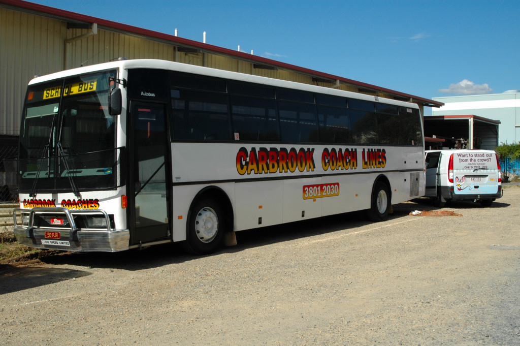

    This is the latest bus. Oracal 551 yellow with the red and black printed, and laminated with Oracal 215 matt laminate.
    Originaly I was only employed to do the front and rear. The other shop was becoming unreliable so he rang me late on a wednesday to see if I could have it signed by saturday. Never being one to pass up a challenge I gave it a go.
    He notified me during the week that he is now using me exclusevly, and gave me 3 buses to do fully. Two today and one next week.
    Previous shop painted the red over yellow, but they wash the buses every day, and the red ‘washes off’ over time because of the caustic washes they use.
    The previous sign shop designed the text with the shadow, I’m not really happy about it, but 15 buses are already done so I can not change it now 🙁
    This client has also refered me to another bus company because I helped him out. I am hopeful to get that bus company too

    Shane, your are right about the shadow, but now you are in the "good books" perhaps suggest leaving in out (costs less) or softening to grey?
    (same logo, better looking)

    Peter, I did broach the subject of ‘modifying’ the shadow, but it is a ‘no go’ area. The client loves it 😕 apparently. But to change now would make his fleet look too different 🙁
