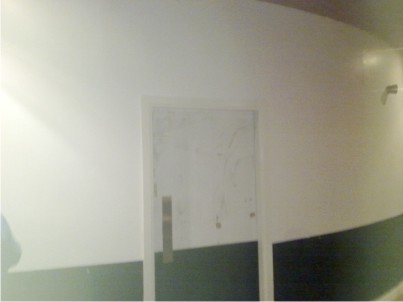

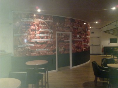

    Hi All
    thought I’d share this one with you, this had to be fitted last night after the wall had been repainted.
    It needed to be up for the Clubhouse opening this morning.
    The graphic is all photos from Fleetwood Town FC season and is on the wall of their Club.
    Got finished about 1am
    Enjoy

    I hope the wall where you applied the vinyl wasn’t just painted otherwise you will have a problem with the vinyl adhesion caused by the paint outgassing. Freshly painted walls should be left for a week to fully dry before applying vinyl.
    Hopefully the above doesn’t apply here – looks good 😀

    they were painted in week – reason we left till last minute
    Chairman insisted they were up no matter what – we had a window to get in and get done between matches
