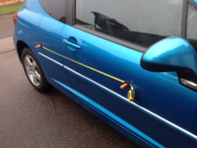

  • Chris Windebank
    5 November 2013 at 09:17
    If the van has difficult lines I use magnets with string between them or even an old tape measure and measure up from the sill.
    I also carry a strip of composite board with magnetic under to use for the same purpose
    This can be used as a datum line to start work
  • NeilRoss
    5 November 2013 at 09:27
    quote Chris Windebank:
    Chris, Have you tried magnetic vinyl? I carry/use a narrow strip of magnetic vinyl, rolled up and lives in a corner of the toolbox (I have a few different sizes). Neatly cut to ensure they’re straight, about 2 inches x 4ft or shorter. Works a treat as a straight edge for a line or as you say lower down for a datum line.
