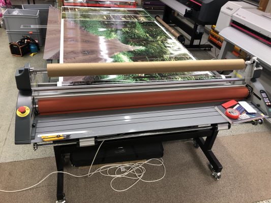

    Posted by Pane Talev on 30 September 2021 at 18:57
    Good evening all
    Several years ago I had a Kala laminator.
    I could only laminate 2-3 meters. It was not calibrated well.
    I sold it to a chap in Dublin. He organised transport. He knew what he was buying.
    A few days later he wrote to me:
    “I had a friend engineer over, he calibrated the laminator and we just laminated 9m print.”
    My current laminator need such an engineer or help how to do it.
    Please advise if you have an idea.

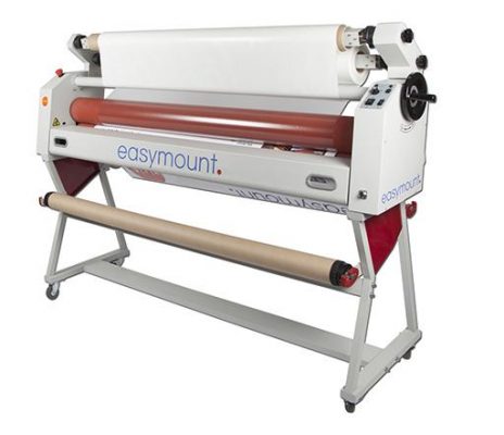

    We used to have terrible problems getting our Easymount EM-S1600H to run straight. It turned out the problem was staring us right in the face. Basically what was wrong was the the stand and the laminator weren’t sitting square. The laminator which was a separate unit was pushed back slightly on one side. This meant when the roll was fitted onto the mandrel on the stand the material wasn’t been fed straight into the machine. We squared them up and used VHB tape to keep them in place. This instantly fixed 99% of our laminating problems and is possibly something you should have a look at.
    Davy
    • Pane Talev
      1 October 2021 at 16:51
      Thanks David. I will try moving the laminator a little and see if things improve.

    Recently I flooded quite a lot of 7mm dibond panels on my laminator. Maybe that caused the problem. This week, I can barely laminate 2 meter print.
