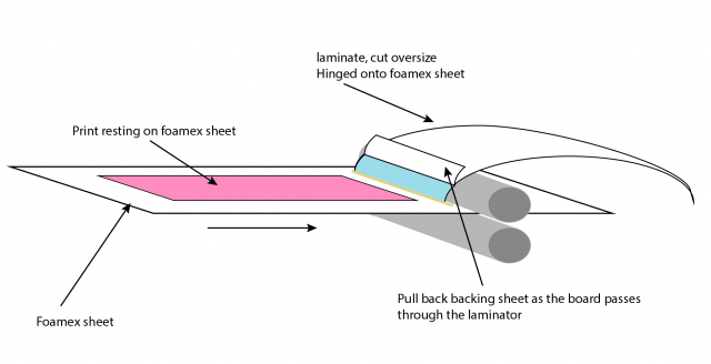

    I have the same issue and allow for waste in the price but if you want to save on laminate on smaller jobs you could use a foamex sled through the laminator, that way you can cut the exact size of laminate leaving a little extra to nip the rollers at the start.

    Adam, what is a foamex sled? i am hoping i am not being completely dumb asking this! 😳🤣

      Forgive my crude drawing, basically use the foamex board as a carrier for the print. This way you can cut laminate to just larger than the print size and use the laminator to lay it down (without webbing up the laminator and wasting loads). You will sacrifice the foamex sheet but it will be good for quite a few jobs as long as you strip off the excess. I think this is your wobble board David 😁

    I’ve been at this 10 years, and I’m curious as to the Sled – We’ve probably used similar in the past, but called it a different name 😀 We have our trusty ‘wobble board’ we use to feed in the laminate.

    nice diagram @Adam-McMonagle I know what you mean now, mate. but I was thinking something different when you said “sled”.
