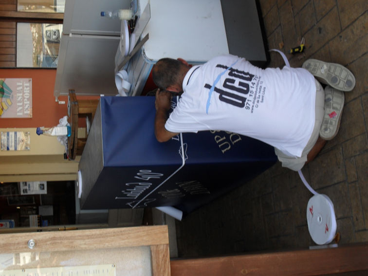

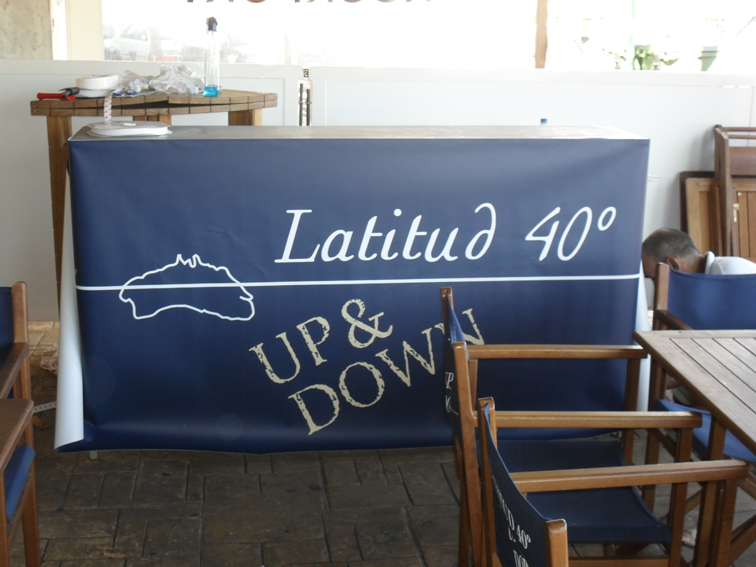

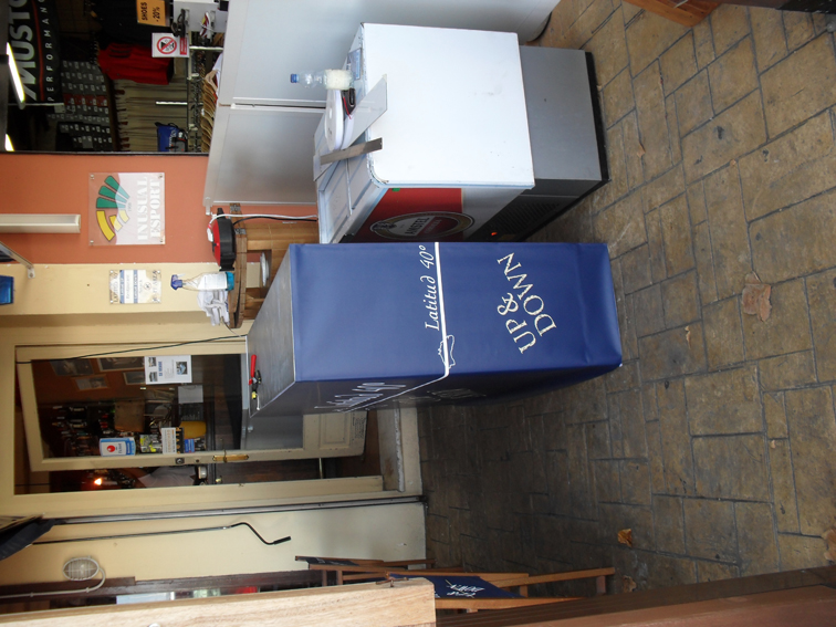

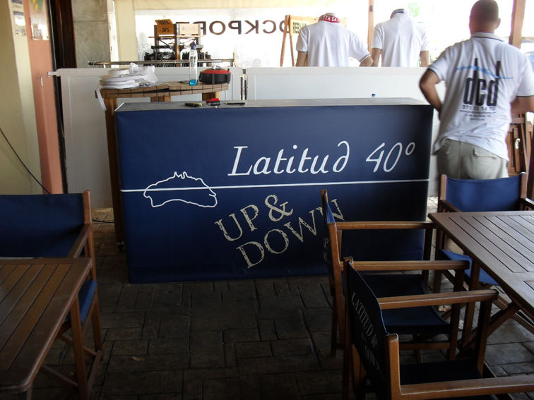

  • Dan Osterbery
    25 August 2010 at 15:59
    Thanks for all your help and suggestions! here is the finished article! Going to be used for 5 days now for a regatta and then in two weeks for 4 days for the local fiestas! Wished i had taken a photo of the amstell minging bar before the cover went on!
    thanks again guys, client very happy and managed to get a 40 polo order while i was there, happy days!
