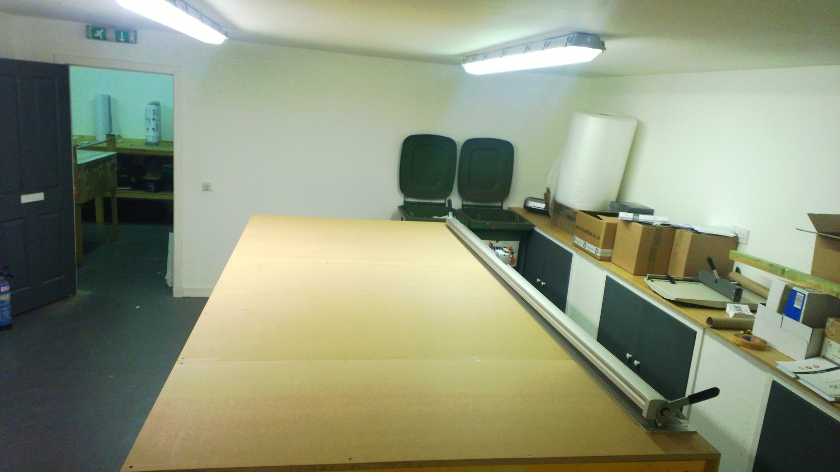

    13 March 2013 at 08:26
    Make a bench..
    I will upload a picture of what we have done later.
    Think ours cost around the £600 mark.. (not 100% on that tho)
    We built the table ourselfs for under £150…
    It has taken cutting our panels down from two guys, about 2 hours to one guy in 40 mins…
    and as rob said… loss if finger tips has gone 🙂 always a bonus 🙂
    13 March 2013 at 08:53
    yep, thats exactly what i had in mind stuart. thanks for the picture mate….
    we already have various similar built tables in our place. 1inch sheet of MDF to help keep the table true flat, on top of 3×2 framing & legs. 10ft by 4ft table costs about £40-£50 pound is is more stable. a rebate of 5mm at one side for the cutter and your done.

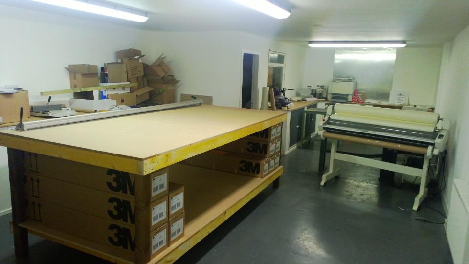

    13 March 2013 at 09:03
    deff dose the job for us BUT thats because its been bought for that job in mind..
    IF it was just there as a day to day thing, it would not really be used that much..
    We made ours extra strong due to it holding loads of vinyl.. at any one time we can have up to 20 boxes under there, that was taken at the end of a job run last week 🙂

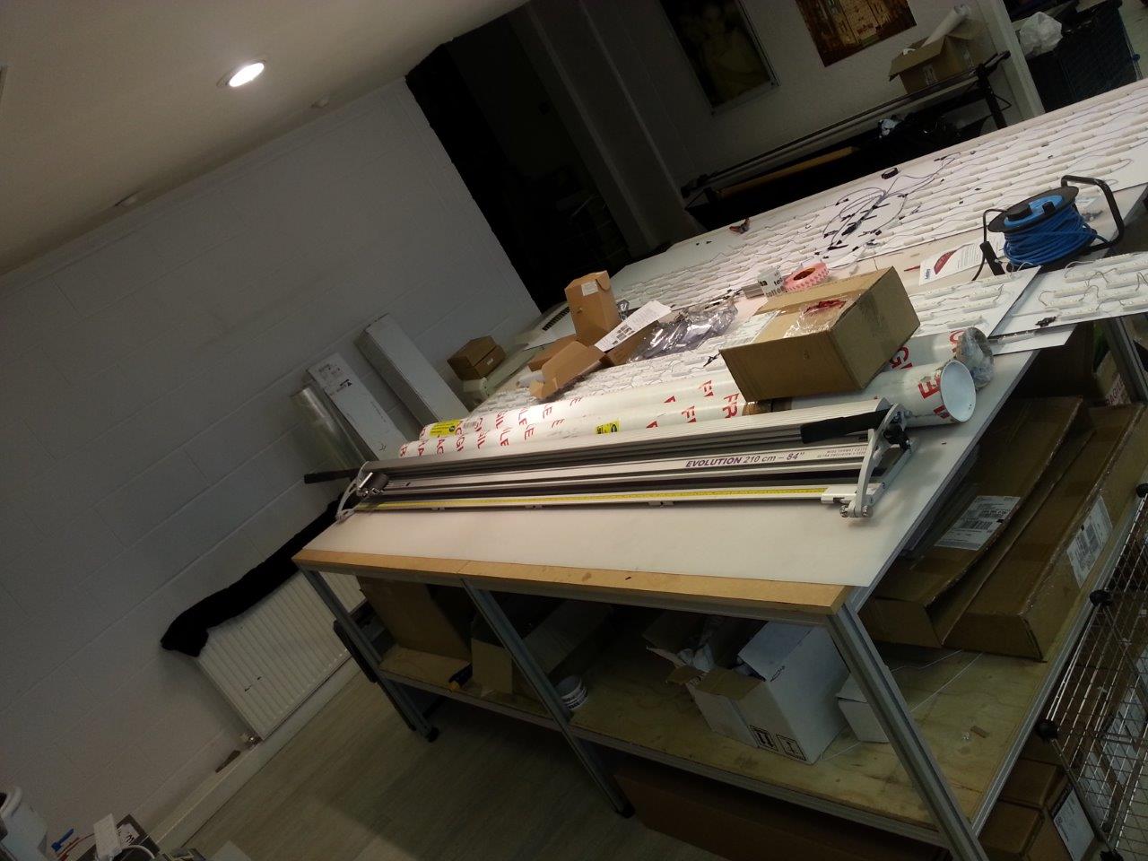

    13 March 2013 at 09:16
    Here is ours on two of the benches joined together giving us an 8ft by 8ft working space as you can its a geat table but spoilt by the cutter which gets in our way doing other jobs. We hav ethe self healing mats on this table to allow cuts to be done
