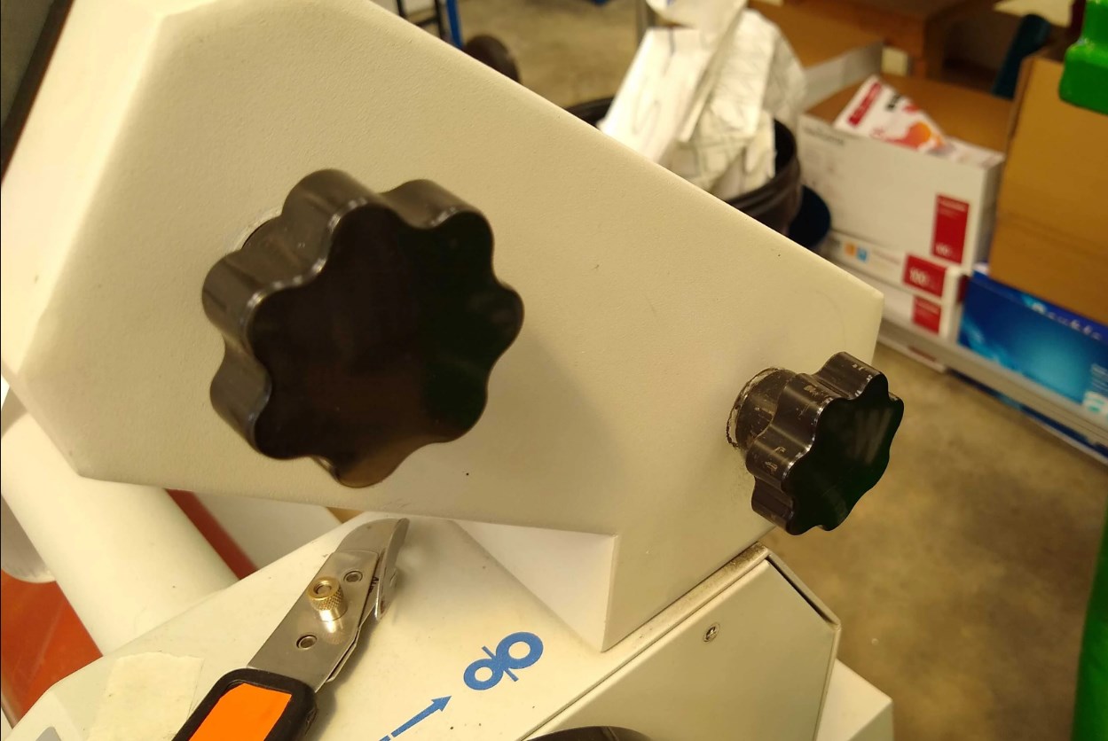

    Hi, we have the same machine and that sounds like a problem we had when the tension on the rollers was too high. On the top rollers there are 2x knobs on the righthand side which adjust the tension of the top rollers. Make sure these aren’t so tight their compressing against the edge of the machine. Ours were set so tight when I was off on holidays they bent the metal!
