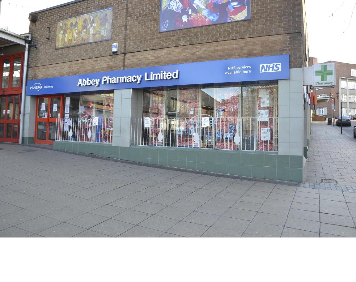

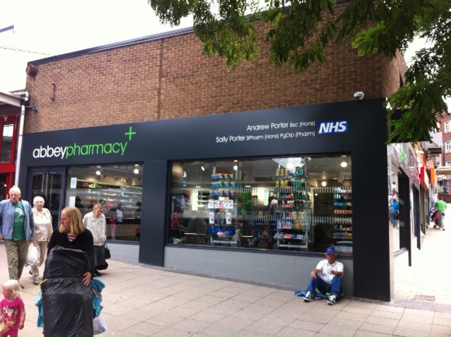

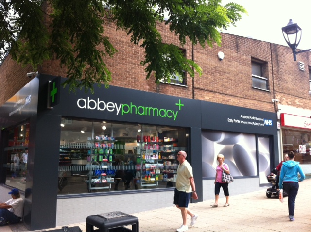

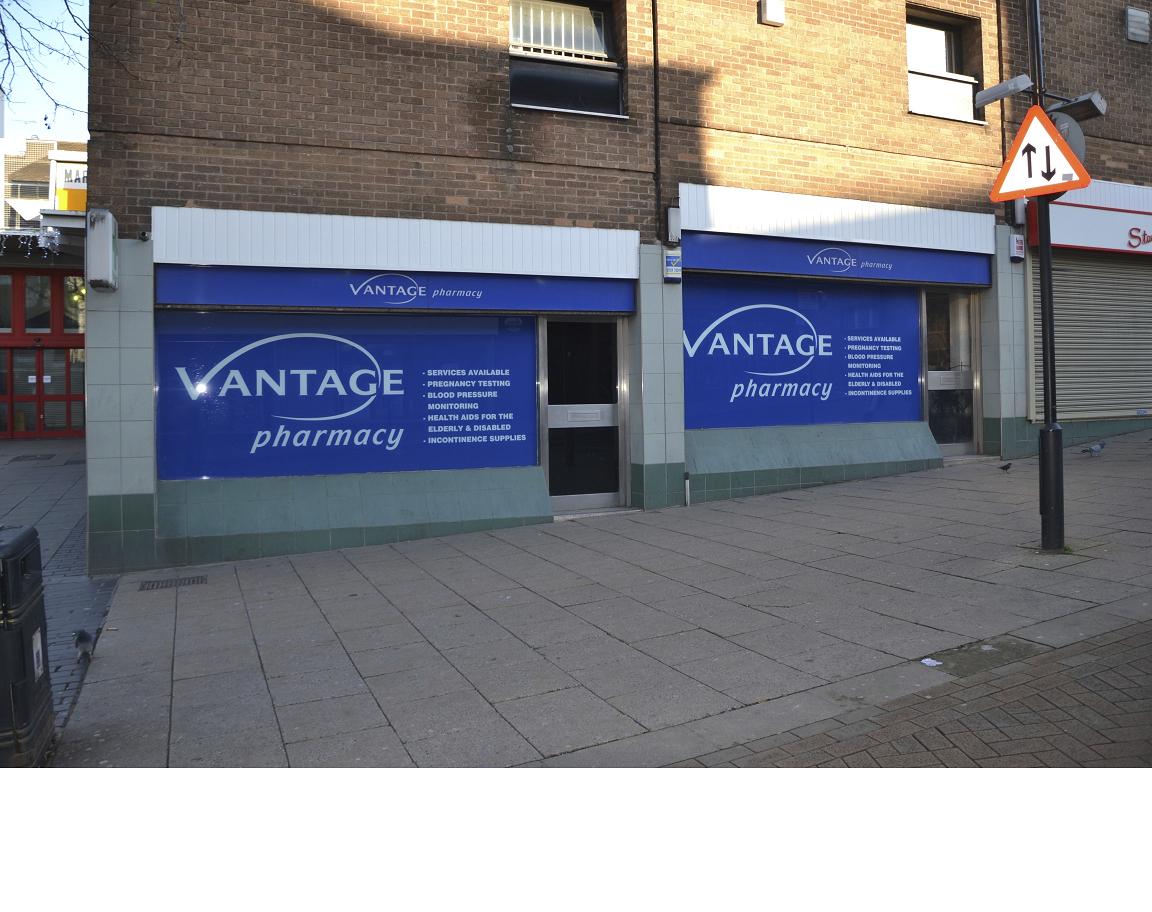

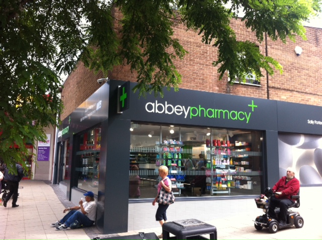

    Posted by Ian Johnston on 28 August 2012 at 12:14
    This is a Nice wee job we did in Rotherham a few weeks ago,
    Grey ACM with 10mm push thought acrylic backlit with V180 Sloan Leds.
    Pillars, Corners etc all folded on Site to suit and give a seamless look
    I think it made a huge difference to the building 😀

  • Neil Davey
    28 August 2012 at 13:45
    You sure that’s not a different pharmacy!!!! 😀
    Looks excellent Ian and your right it does look seamless.
  • Harry Cleary
    28 August 2012 at 13:56
    Brilliant transformation Ian!
    Complete with resident down and out! Who supplies them? 😀

    28 August 2012 at 14:26
    That looks fantastic Ian…clean and sharp
    How did you fix the cladding panels ?
  • Ian Johnston
    28 August 2012 at 17:45
    quote Glenn Sharp:
    Hi Glen,
    All the main trays are CNC’d here, folded ACM Reinforced with 50mm ally angle, glued into folds with Trueflex (Polyurethane) glue,
    Back Panels are made to suit, with a return to meet the ally Angle supports on the trays, and then you only need a minimum amount of Pan Head screw to hold in place.
    The pillars are first formed in Treated timber and WBP Ply on site, the ACM is fabricated using a Festool PF1200 (A must for anyone fabricating ACM on Site) to suit each pillar, scribed to returns etc.
    A small trace of Trueflex down the sides and a few screw just to be sure.

    the old one looks tired and very dated.

    Like the others im really impressed with the transformation – a real wow factor
    one concern would be how well the ACM will stand up to crashes from the mobility scooters etc 😕
    Well done though a job for the album 😀

    Went from looking like a jail to clean and modern.

    Funny you say about the mobility scooter John, 2 weeks after it opened with the new refit inside, an old lady with a mobility scooter wrecked the inside of the shop doing £20k of damage to the furniture, glass screens, gondulas, and amtico flooring when she had it in high gear!!!!!
    With the pillars we form a 18mm ply back and laminate it with the Acm , yes it will still dent a little, but so would aluminium etc but using the ply to reniforce it
    prevents major problems.

    Ahem….here’s your no1 suspect:-

    Phill, sure that guy won’t be to happy about being called an old lady :lol1: :lol1:

    That’s a cunning disguise Martin! 😀
