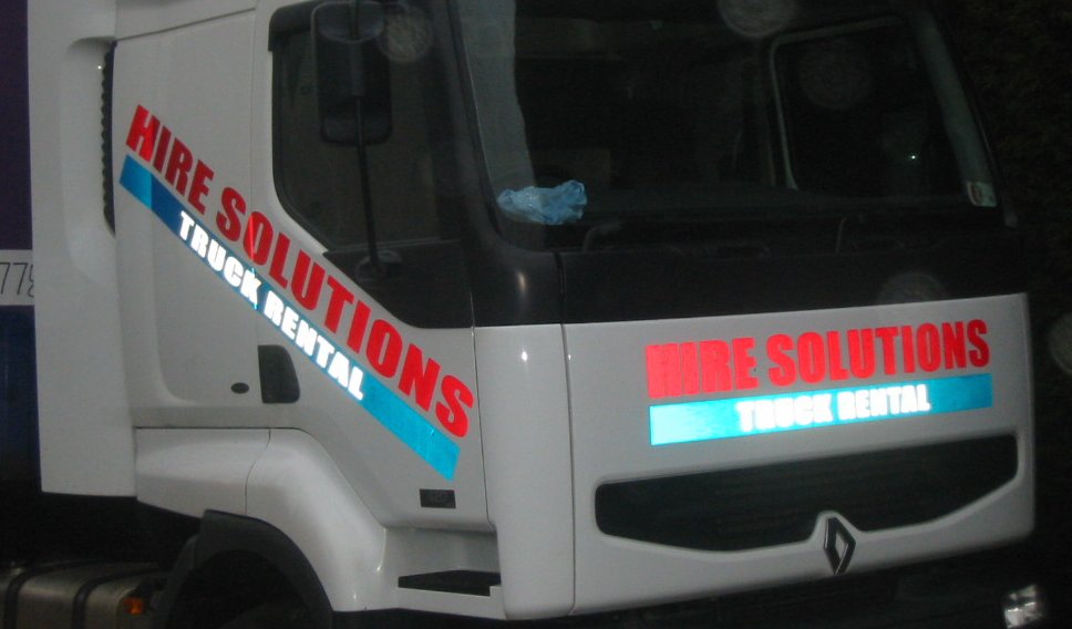

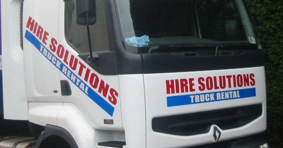

    here goes again asked to quote for tractor units as in pics?
    noticed when i got home the pics with flash came out fluorescent
    but look like ordinary vinyl (what is it)
    not much text etc on them small block with text at front and both sides
    also tel no top front and top sides
    what would be the best way to price this

    its all done in reflective vinyl mate, not flourescent.
    you will look to pay about £7-£10 a metre for the stuff.
    most good vinyl suppliers offer it, but comes in limited colours. mostly primary colours black and white.
    be sure to do a test cut on the vinyl as its thicker and isnt a nice material to cut. never run the whole job then weed, do it as you go along, sometimes parts dont weed as they shouldnt.
    be careful when fitting, some grades of this vinyl is worse than others.
    NIGHTMARE TO REMOVE!

    thanks for the quick reply rob
    i have some stuff. swatches etc on fluorecsent but nothing on reflective
    i use amari or pyramid up here any one else you can think of to supply
    reflective
    once again the boards have saved me dosh
    can you imagine if i had priced say 5 trucks thinking it was ordinary vinyl
    cheers again

    Hi Dex,
    I’m with Rob, just one thought.. we have a regular customer who uses quite a lot of reflective, as we then have to remove it in two years when the contract hire ends we put the reflective over the top of white plain vinyl. Ergo.. when we remove it its a piece of cake and pays back the minimal cost of the vinyl many times over!
    Also take into consideration your blade costs.. we have a Mutoh 650 that is permanently cutting reflective eats at least a blade a week!
    As Rob said weeding is a nightmare takes at least 5 times longer depending on the size of the characters.

    Hi Dex,
    Just seen your reply. I don’t know if you have much experience with reflectives, but you only need ENGINEERING GRADE VINYL, this is considerably cheaper than Grade 1,2 or 3 commonly used for emergency services etc. we find the cheapest at the moment is Lucky Lite from Cherwell or Vinyl Logistics, but its up and down like a yo-yo.
    Regards,

    here is a couple of links to the same demo i did using reflective. i used nikalite but have also used luckylite as john has advised. if the luckylite is the same foilbacked type reflective that is difficult to tear, then i give it the thumbs up, reason i am unsure is i always get the names mixed up.
    anyway, as you will see in this demo the nikalite conforms well.
    again as john has said applying ontop of normal vinyl helps if the need to remove comes about. in the following demo its applied onto the yellow so no worries there.
    http://www.uksignboards.com/viewtopic.php?t=2164
    http://www.uksignboards.com/viewtopic.php?t=2165
    the thing about nikalite is that the NEW version of this reflective strips pretty easily with a heat gun… it does leave alot of glue though but thats not as much hassle as some other reflectives are to remove. they snap off in tiny little bits and leave glue too…

    Yes Lucky Lite is foil backed horrible hateful stuff to strip :banghead: !!
    who makes nikalite Rob? always interested in easing pain!

    thanks guys i shall take it all on board
    cheers
    dex
