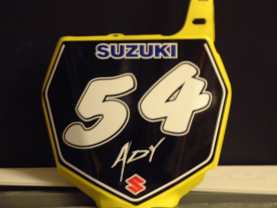

    Not exactly a perfect example of racing graphics, but it is my first one 😀
    Hopefully it’ll stay on at its first race long enough for me to get some pictures of it 😕
    Cheers, Dewi
  • Carrie Brown
    28 May 2004 at 21:03
    😀 Yay!! Looks good Dewi!!!! 😀
  • Nigel Fraser
    28 May 2004 at 21:11
    Nice one mate, hope he doesn’t crash out too soon !

    But if it doesn’t , you get another one to do…….think of it that way mate. 😀

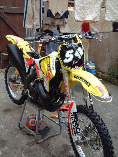

    Did some graphics on the bike I did the front panel for. It was a ready-made kit, so it was just the fitting, but it turned out quite well. Blimey is that stuff thick though 😮 😮 Get a bubble and you need a pnuematic drill to pierce the vinyl! 😉
    Cheers, Dewi
    29 May 2004 at 19:34
    nice job dewi!! 😀 😀
    i’ve never seen that type of vinyl!!
    Nik
  • Nobby Thomas
    29 May 2004 at 20:01
    Is it like what they use for a sandblast stencil???? That is grey only mind you thinking about it..
    Nobby
  • Bill Dewison

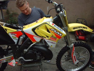

    29 May 2004 at 23:17
    I think it’s the convex material mentioned earlier in the thread. I’m really looking forward to getting my hands on some and making my own graphics kits 😀
    Pictured below is the side of the bike and some ugly mush attempting to fit more graphics on the other side 🙄
    Cheers, Dewi
