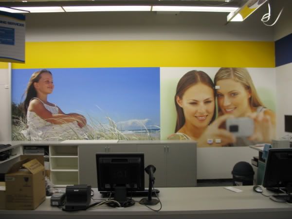

We use Avery 1005 EZ to do wall graphics. But you do need to pre paint the wall in gloss first…
This wall is 8 Metres long and 3.4 M high. The EZ vinyl went up as smooth as silk with no bubbles and will be easy to replace as the displays change.

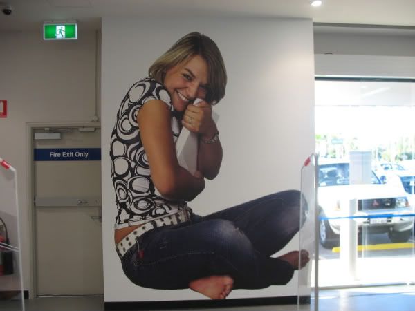

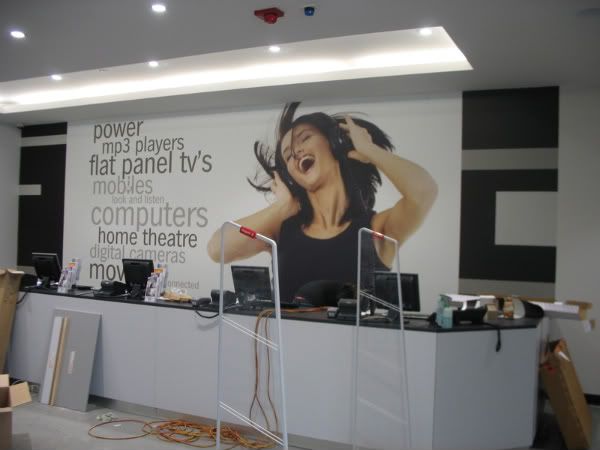

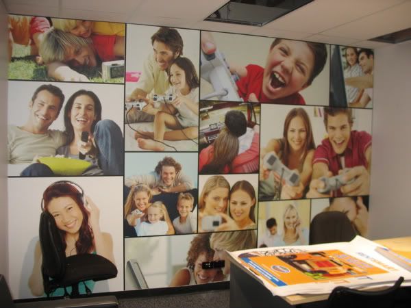

Yeah we laminate most of our printed stuff…Our supplier didn’t have Avery in stock, so on this job we used Arlon Matt laminate Which looked great.
Here area couple of other walls from the same job.
