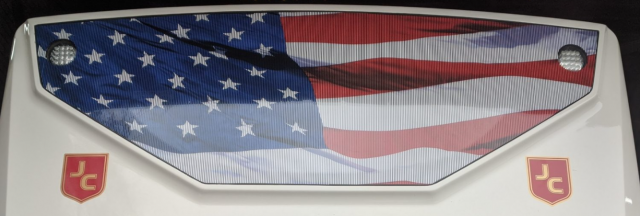

    this rear bus window is based on 3mm / 2mm / 3mm / 2mm spaces and done in vertical slats.
    I don’t think it really matters which way you go to get the effect, but I always opt for vertical. mostly because water runs down the slats, rather than sitting on the ridge.

    Thanks Rob. Makes sense about the water. This one is inside a building, but I think I will do it vertical for when they wash the windows.
