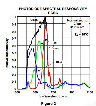

    Back to the original post, I could not find anything on the website about the light source used for colour measurement. The colour of an object depends on the object – and the light source. E.g Everything looks grey under a sodium street light because there is only yellow in the lamp colour. Anything not yellow looks grey.
  • James Easton
    18 October 2013 at 15:37
    https://pbs.twimg.com/media/BTVf5iuCUAAIFbo.jpg:large
    does that help? its all i can find about it!
  • Mike Hall
    18 October 2013 at 16:18
    Hmmm! Not really – that looks like some normalised sensor response data – which I have to say does not mean a lot to me – my ignorance – not the suppliers fault.
    I’ll maybe have a bit more of a look around.
    I’ve recently been doing some light and colour output measurements and tried some reflected colour too – but using the correct light source to illuminate the object under test is critical. And impossible if the object is normally viewed under sunlight – because that constantly changes. Compare high summer with a cloudy winters day or sunset. All different. How do you select a standard from that? I dont know. you can pay a lot of money for "Standard lamps" but is the expense justified when a good pair of eyes are pretty good at comparisons. Its when you want the "sophistication" of absolute or reference figures that things get difficult.

  • Mike Hall
    27 October 2013 at 20:47
    Thanks for finding that out, James.
    With the benefit of hindsight it was always going to be an LED.
    By "uses LEDs that try to mimic D65 Lighting" I suspect they mean a 6500K LED or similar (USA is full of 7100K in the sign industry, as they were the most efficacious (lumens per watt)). an LED will only mimic D65 as that is a fairly flat spectrum. LED is a big peak in the blue, a broad peak ranging from yellow to red and a bit of a valley in between. See http://en.wikipedia.org/wiki/File:White_LED.png – -this looks about 7100K to me. I’d post one of my measurements of a spectrum but I do not have any on a website. Maybe I should do something about that!
    Unless they are using RGB LEDs.
    I hope that they are successful – a cheap alternate to the equipment £3000 and up which is available now would be great.
